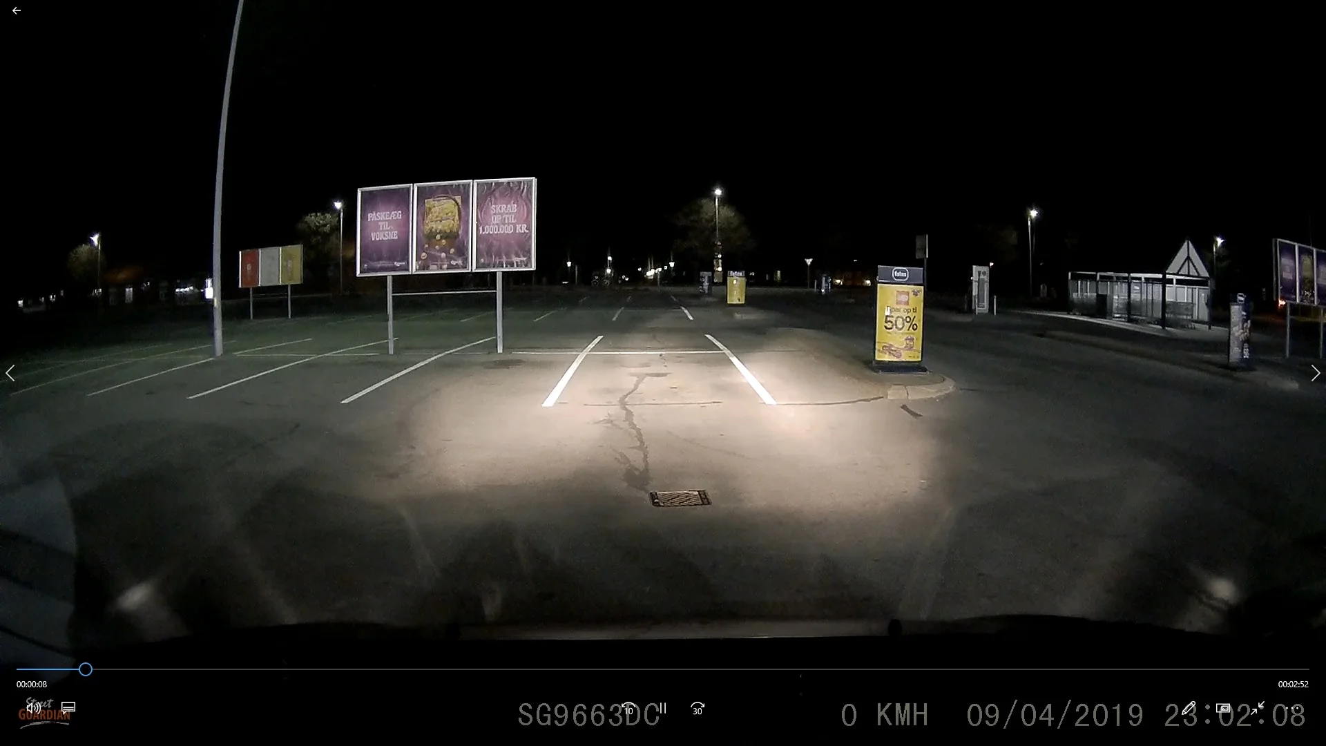

A compare screen grab between the K2S and my SG9663DC ( same sensor )
45753
45754
This is quite good for an IMX323 sensor. It's a tiny bit oversharpened for normal videos, but this helps you see the lettering/number plates more clearly so IMHO this part is near-perfect. I've seen a lot worse from this sensor and none much better- even the much acclaimed A119S with modified firmware is only very slightly ahead of this IMHO.
SawMaster
agree, oversharpeness sometimes help. I remember finevu 300/500 models with too sharpe but its better for plate. and here is good optimization firmware for imx323. But here iv talk about sensitivity in night shooting. Look at right side or lighting under the lantern. there is a clear advantage in sensitivity for imx291.
Yes i am not sure it is using IMX291, a few sensor models was talked about early in the game.
