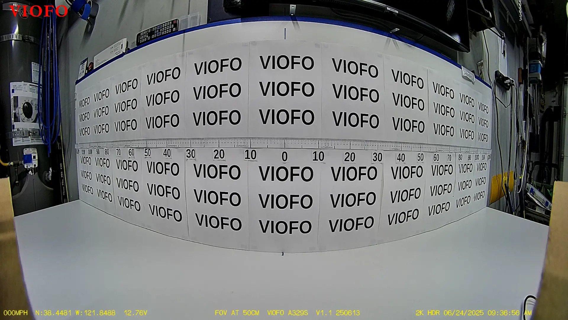

Not really, but I’ve found depending on the type of car you might get a better POV mounting the IR Interior camera on the rear window looking forward.
The current RCC360 2K Infrared Fisheye Cabin Camera with the A329S was a big improvement in FOV, and resolution over the previous IR Interior camera from the A229 Pro.
However, it lost the dedicated photo / light sensor that made switching from full color to infrared black & white much less accurate, (two steps forward, one step back).
Check out the difference in FOV, and resolution with these two videos;

@Chuck McCoy, the rear-window-facing-forward position for the RCC360 is definitely something I would try if I end up going with the A329S. In a small hatchback that might actually give a better view through both side windows than mounting the cabin camera at the front.
The comparison with the older A229 Pro interior camera is interesting as well. The wider FOV and higher resolution are a clear improvement, although losing the dedicated light sensor sounds like a bit of a trade-off if the automatic colour/IR switching is less reliable.
