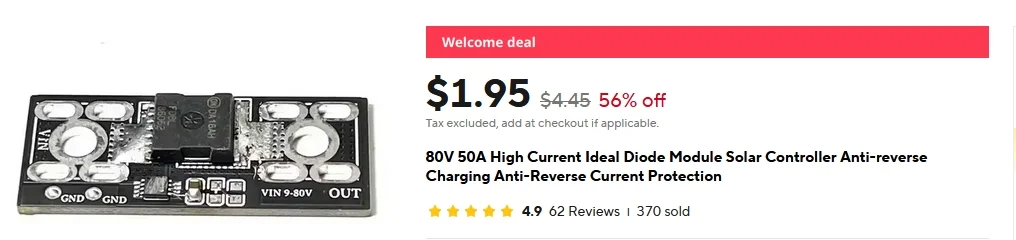

Just made an interesting realization about the purple anti-backflow diode board that I had originally installed in my LTO box. When the batteries start reaching their full capacity, the charger board doesn't ramp down gracefully with this diode between the charger and the battery. Earlier, I had reported that the current level at the end of charging seemed like a "random walk" that was all over the place. When I put my clamp meter on the wire, I got better data resolution - I presume my meter samples at a higher frequency than the BMS update. What the BMS reported as random swings in current was really a function of the precise timing when the BMS sampled the current flow. In actuality, the current starts bouncing up and down between full current charge and zero current charge as the battery gets full. It seems to start behaving as a "duty cycle" or pulse-width-modulation kind of thing instead of a steady and graceful decline in current until full charge is achieved. I figured this was a bit like torturing the batteries rather than treating them gently...
So, I swapped out the purple, dual-diode board that was on the hot leg between the charger and the battery pack for the smaller black board that I picked up a few weeks ago at the same time. This one needs a ground wire, but that's no big deal to wire up. Although I'm still testing, this one also seems to remain fairly cool (close to 10c temp rise at 8A) and only drops about 0.03v from the charger board with an 8A load. Best of all, the charging current now exhibits a smooth and gentle decline as the batteries approach full charge. I'm super excited about these performance characteristics!
https://www.aliexpress.us/item/3256803401816483.html

@GPak, which backflow diode did you end up using in your final config?
Not sure why the purple diode suddenly failed, maybe it was bad from the start, not so obvious but still?
Glad the black Diode worked.
In my son's LFP battery with the same 20A charger as yours, I used a 15A red diode, mostly due to space constraints in the box, it works fine with 7.5A charge rate.

Your battery box definitely needs an anti backflow diode in it. This is a known good one:
