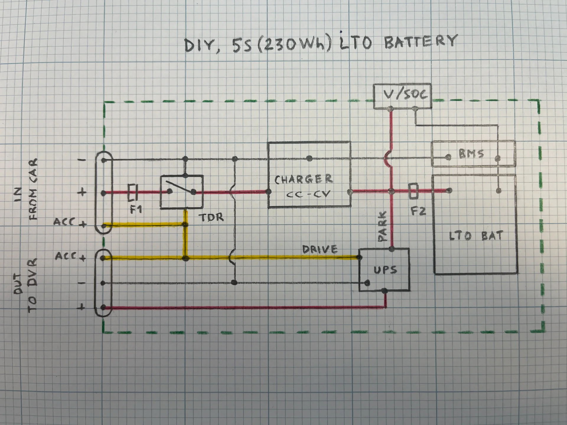

Here is the schematic diagram for the updated 5S 230Wh battery configuration.
Thanks to Viofo HK4 HW kit without low voltage cut-off, it is more simple compared to the original 4S version

Thanks for the updated schematic, still loving how simple this construction is! I don’t have a UPS module in mine, though that might be a good addition in the near future.
It’s probably good to note that the location of the time delay relay (inside or outside of the battery box) depends on the behavior of your car’s 12v utility outlet. If the utility outlet goes on and off with the car’s ignition, it works well to have the relay inside the box as you’ve shown (most simple). If the utility outlet stays live all of the time (like in a Mustang) a different wiring arrangement is necessary: either you need an extra ACC switched wire from the fusebox to the relay inside the box, or the relay can be mounted external to the battery box with the same ACC switched wire from the fusebox.

Regardless of the Relay placement:
If the vehicle's power source is ACC, like my CLA outlet, then I connect the Yellow ACC wire and the Red power wires together for input (this becomes like two wires IN).
If the power source is permanent, then the Yellow ACC wire requires separate ACC source (three wires IN).
So, we can chose either power source.

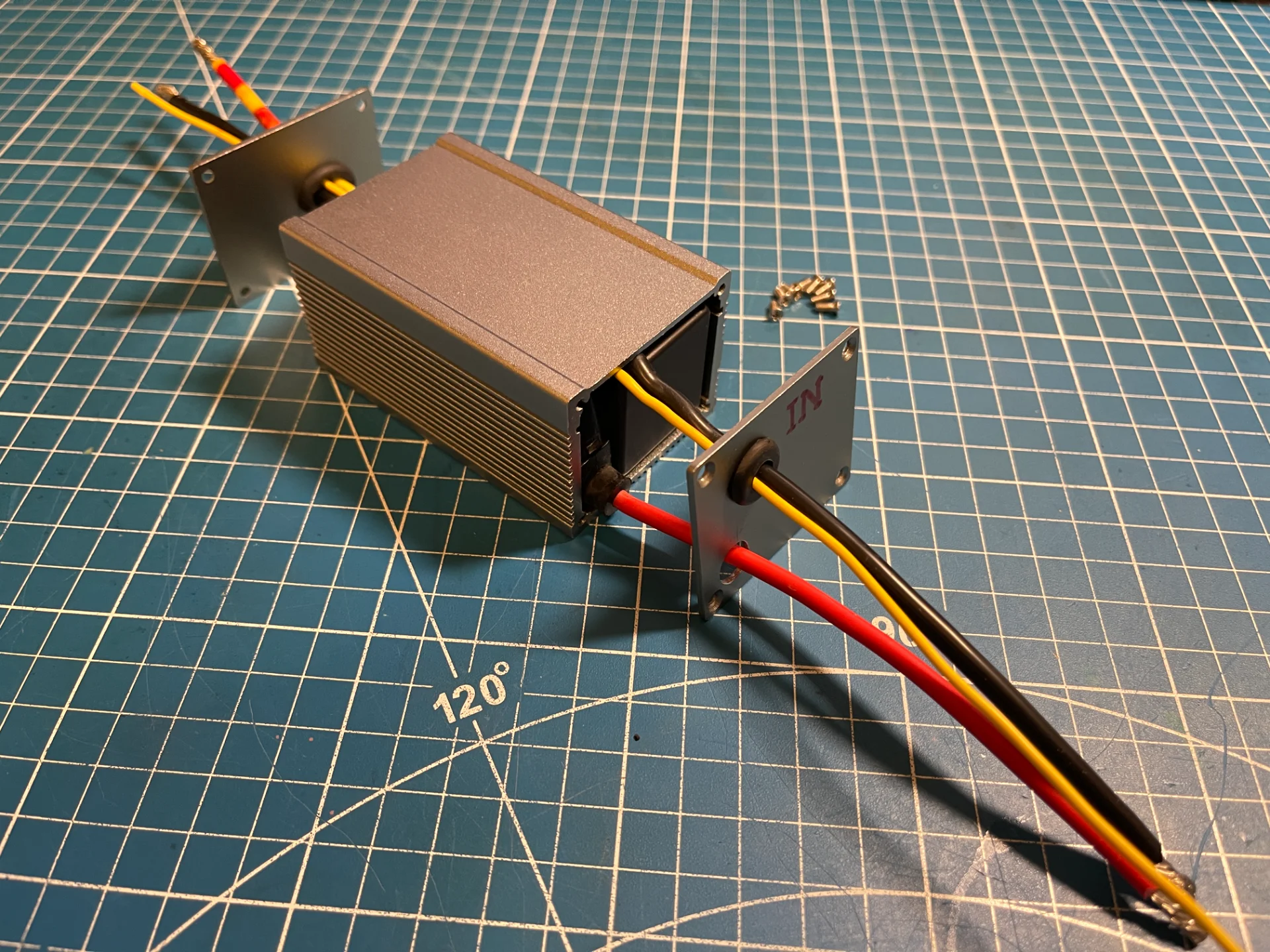

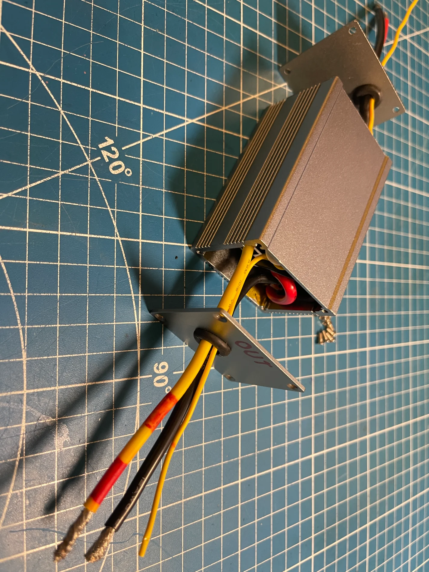

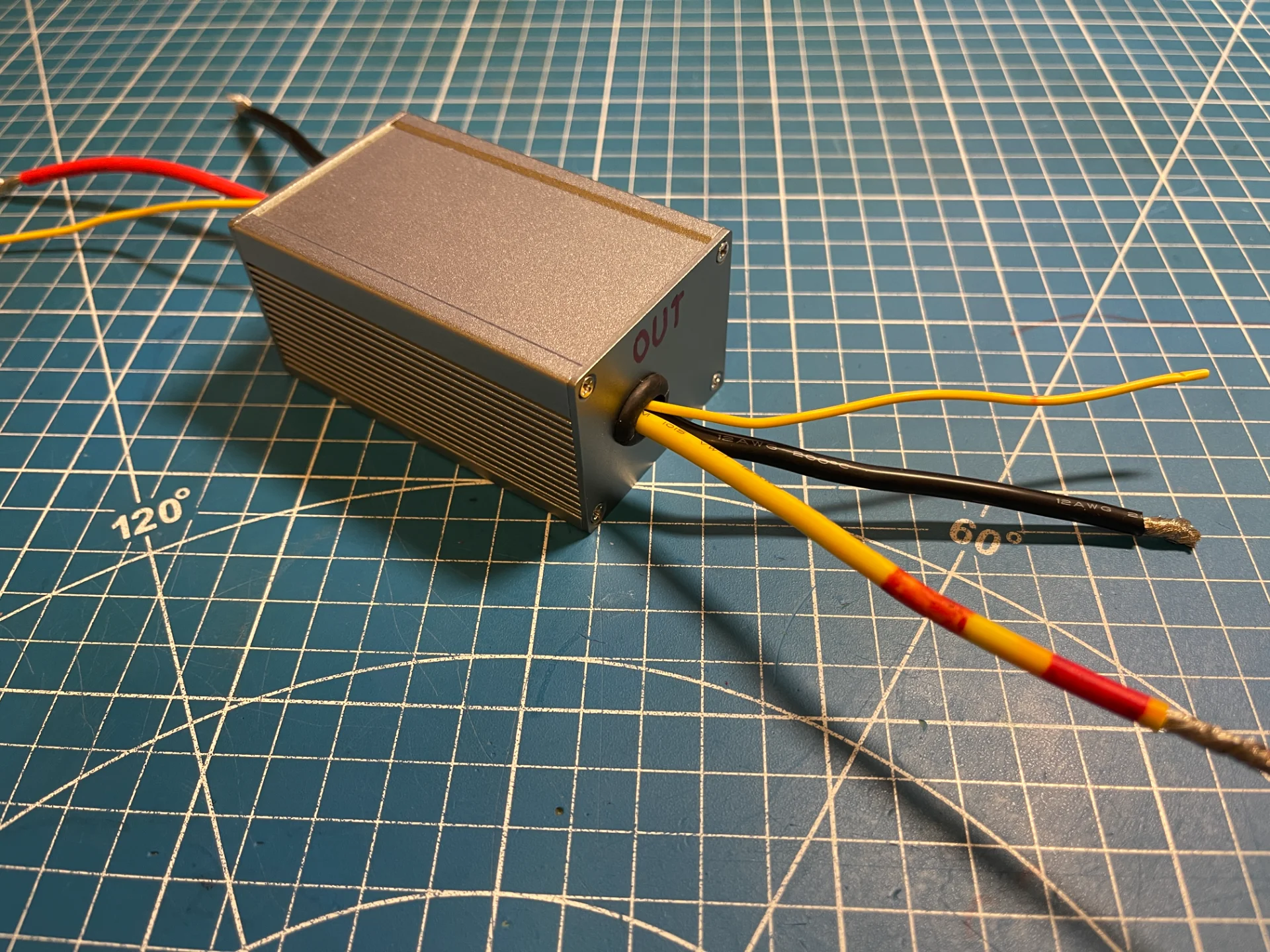

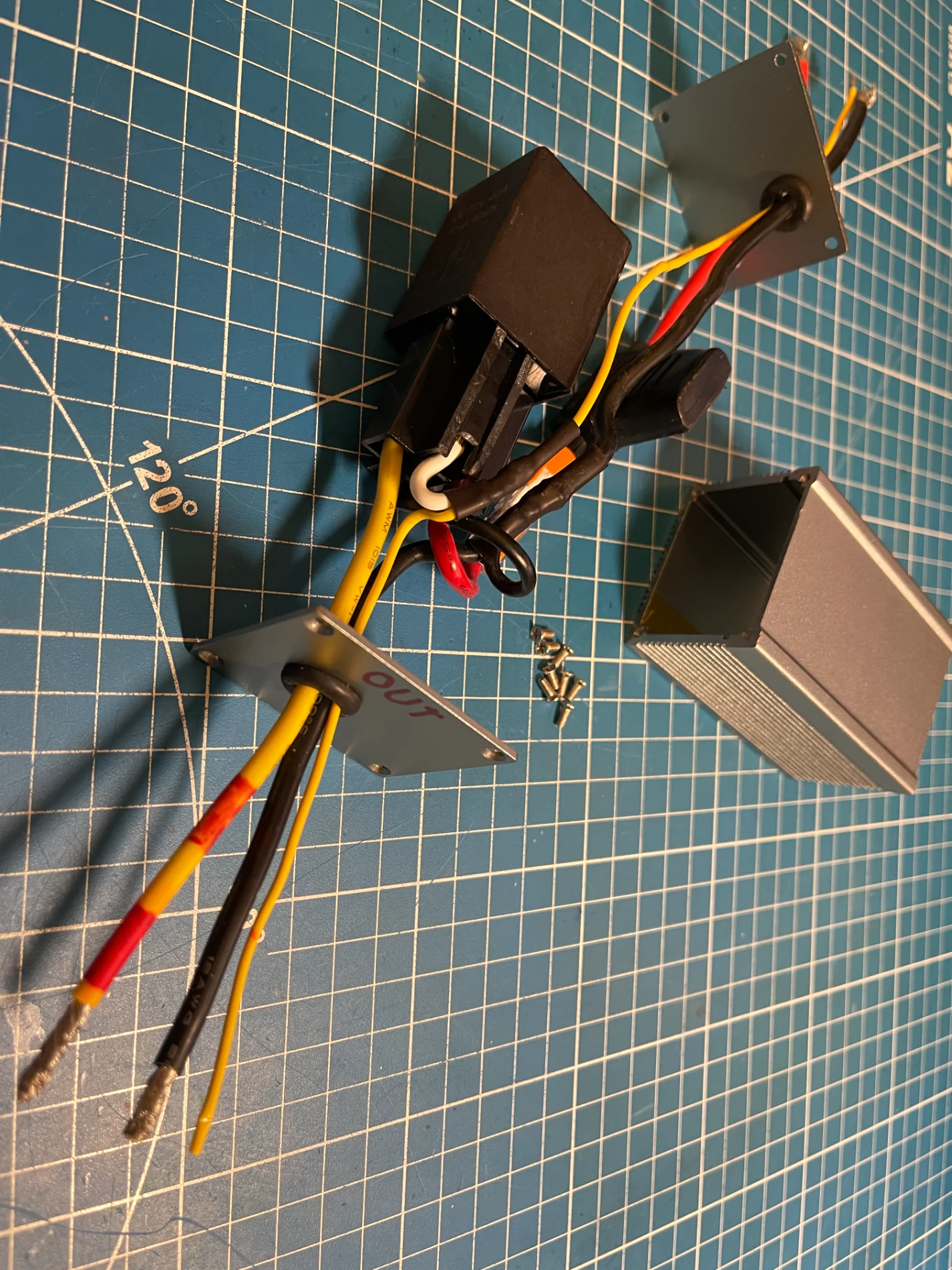

Interestingly, initially with the 5 LTO cells, I had difficult time to fitting the Relay inside the Box, so I actually built the remote Relay option.
But later I shaved some material off the top of the Box and squeezed the Relay inside.
Attached are some pictures of the remote Relay, which includes a bypass of the yellow ACC wire going to the UPS.

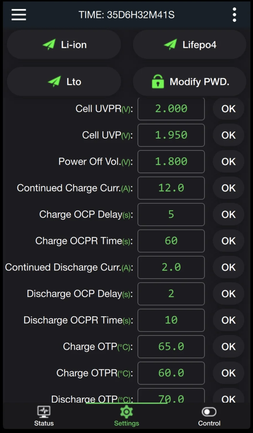

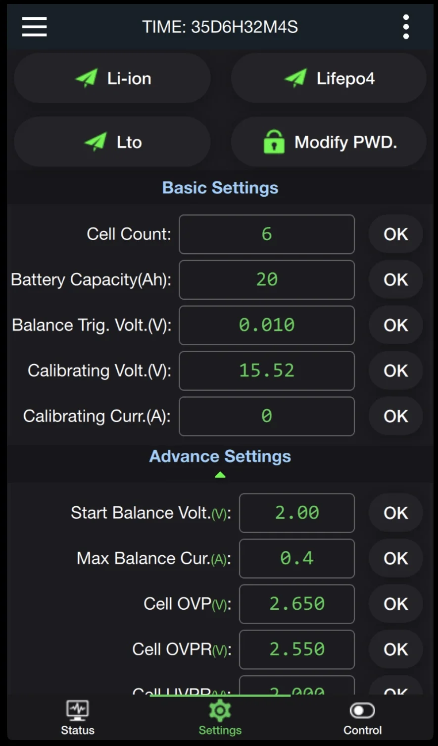

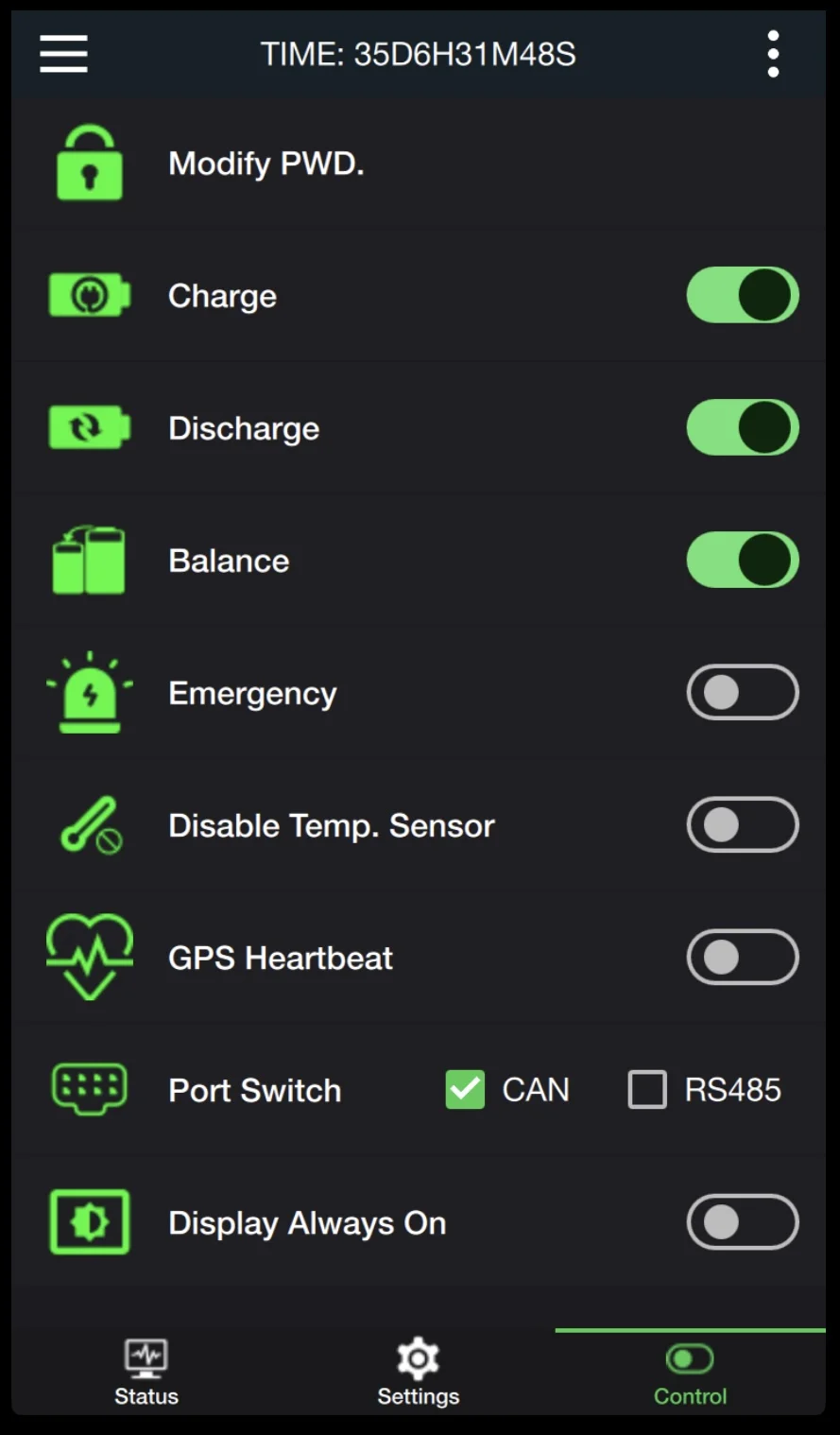

As I mentioned in Ecoflow thread, I finally figured out the "Smart Sleep Time" for the JK BMS.
The problem for the JK BMS "Smart Sleep Time" was the "Smart Sleep Voltage" setting, which was too low.
After I set it to 2.6V (cell voltage), the "Smart Sleep Time" now works essentially like "Timeout" for the Ecoflow, except it will turn-off the BMS regardless of whether the dash cam is running or not, so I set "Smart Sleep Time" to one hour longer than the dash cam parking duration.
Now,

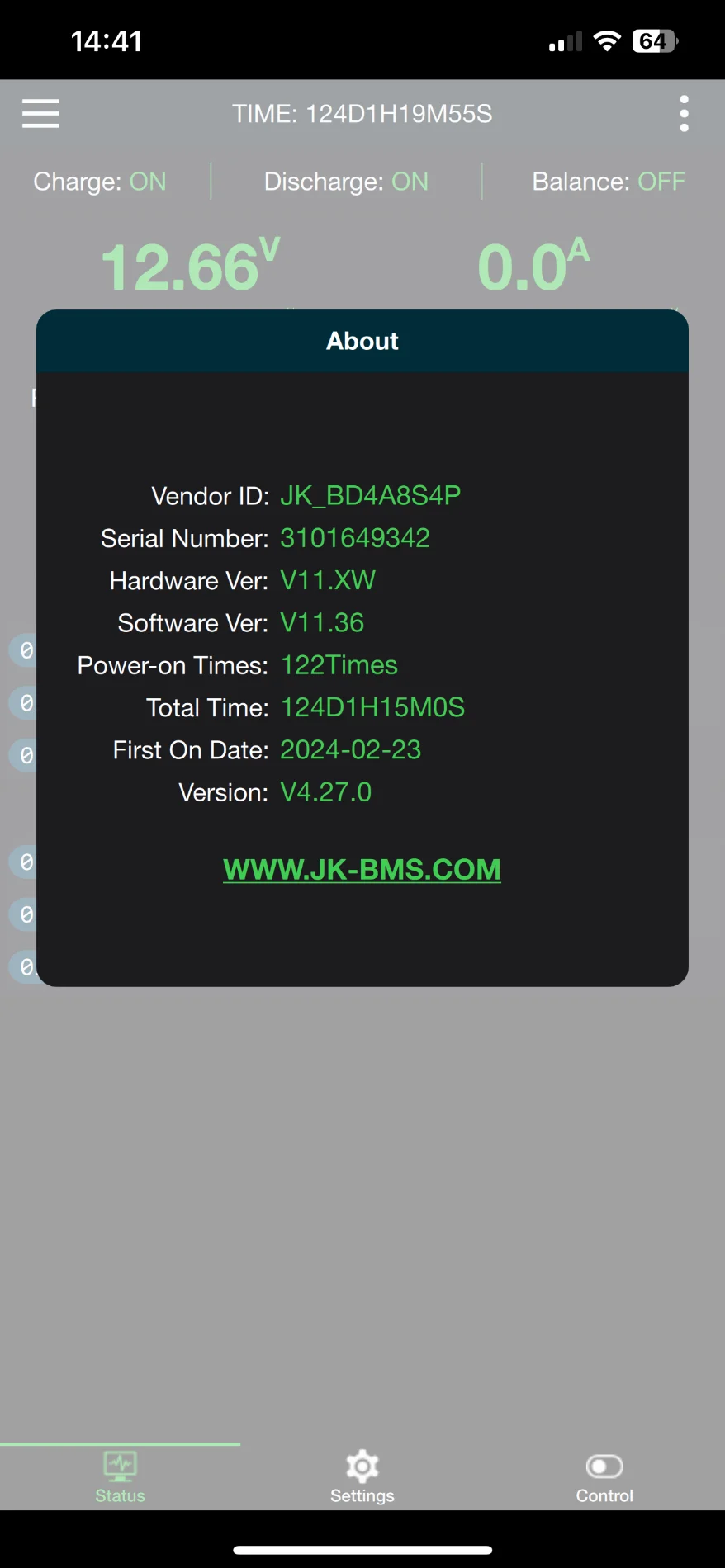

A day ago I got a notification on my iPhone about JK BMS update.
What's New:
Version 4.30.0
- Added model support
- Added serial port protocol
Not sure if I need this... maybe there are some fixes they didn't mention?
I don’t see any obvious addition with this new software. I was hoping I’d get the timeout feature, but I didn’t…
My app interface is exactly the same as yours with only one exception:
On the control page, instead of “Port Switch - CAN - RS485”, I have “Smart Seep”

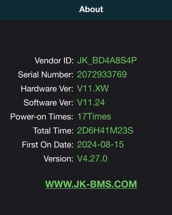

Since the current update refers to “serial port protocol”, could you please confirm if “Port Switch - CAN - RS485”, was added after this update or if you had it before?
Also, it's nice to see that my settings are virtually the same as yours.
The Port Switch feature has always been there for me. I’m wondering if you and I have slightly different hardware and the app is reacting accordingly when paired to the bms.

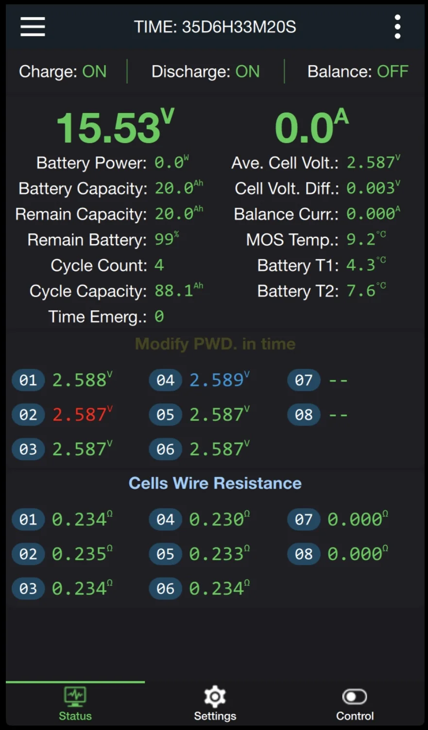

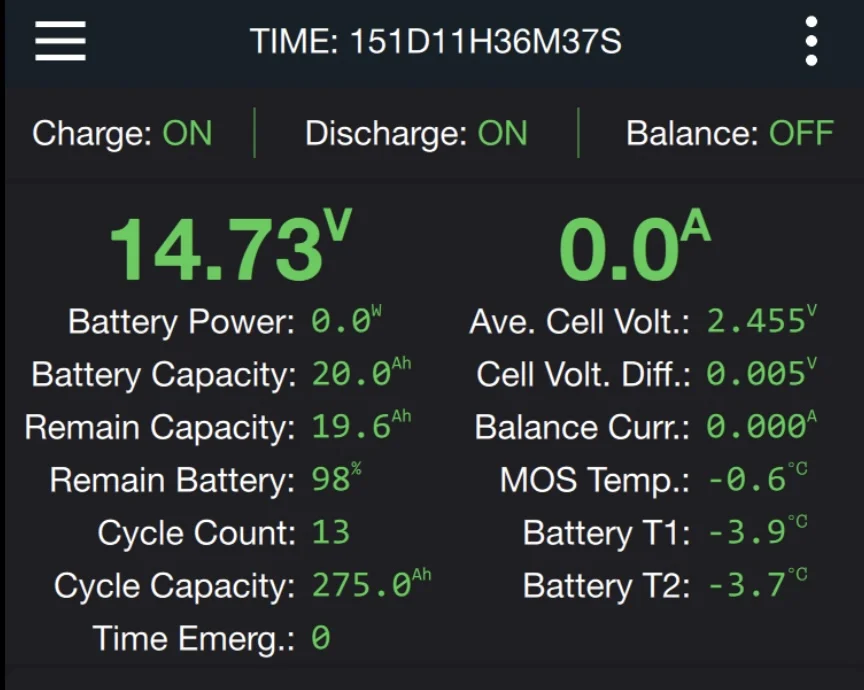

I just made an interesting temperature discovery with my son’s LTO battery pack: Morning temps are getting colder here and today we’re at 15.3F/-9.3c. He always keeps his JiKong BMS turned on, which consumes about 1.4w of power. This little bit of power draw keeps the entire battery pack just a bit warmer. The BMS itself shows 30.9F/-0.6c, the temp probe taped to where the charger board mounts to the same metal panel as the BMS shows 25.3F/-3.7c and the temp probe taped to a crevice between two batteries shows 25.0F/-3.9c.
In the situation where the BMS is always powered up, it looks like there will never be a concern (at least in central PA) about the lower temp limit of the LTO batteries 👍

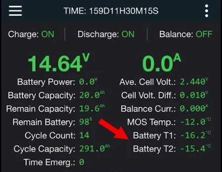

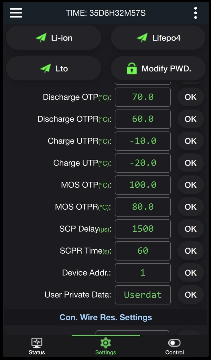

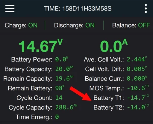

This is about as cold as we get in central PA, we had a low temp of -5F/-20C this morning as I left for work at 7a. No issues reported by the BMS and the Toshiba LTO batteries are supposed to work well to -30C, though I have the BMS set to not charge below -5F/-20C in the menu system. The small heat generated by the BMS always being on in my son's car keeps the LTO box a few degrees warmer. The T1 probe is attached to the crevice between two batteries in the middle of the battery box and the T2 probe is attached to the metal chassis plate that is shared by the BMS and the charger board.
I would imagine that mounting the BMS to the edges of the battery stack with some thermal tape would keep the batteries a degree or two warmer in the winter months, but would also add a few degrees during the summer heat which might not be desired.

As expected, last night's temps dipped a bit lower to -8F/-22C and everything is still functioning well! It's been three years since we had temps this cold (exactly to the day). Before that, the coldest that I remember is -13F back in 2004 or 2005. I'd say the LTO batteries deliver on their promise of low temp operation! Have to give it another 6-7 months to see what temps result from the inside a dark blue car that sits all day in the summer sun.
Yes, as far as I know, LTO is the only lithium-based chemistry that can be safely charged at low temperatures as deep as -30°C.
