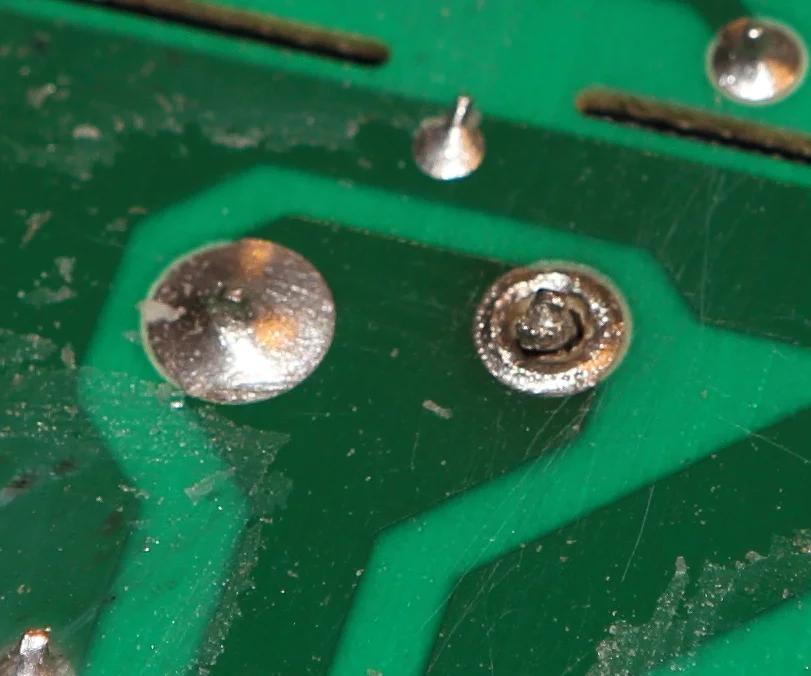

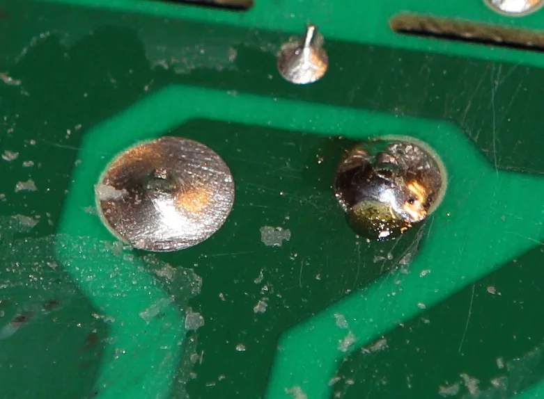

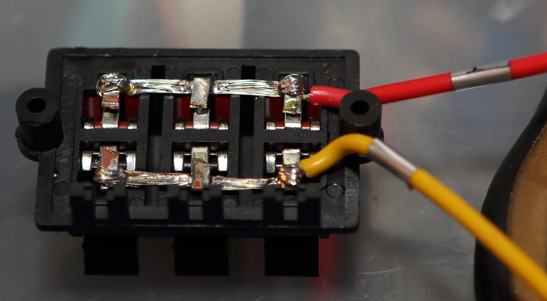

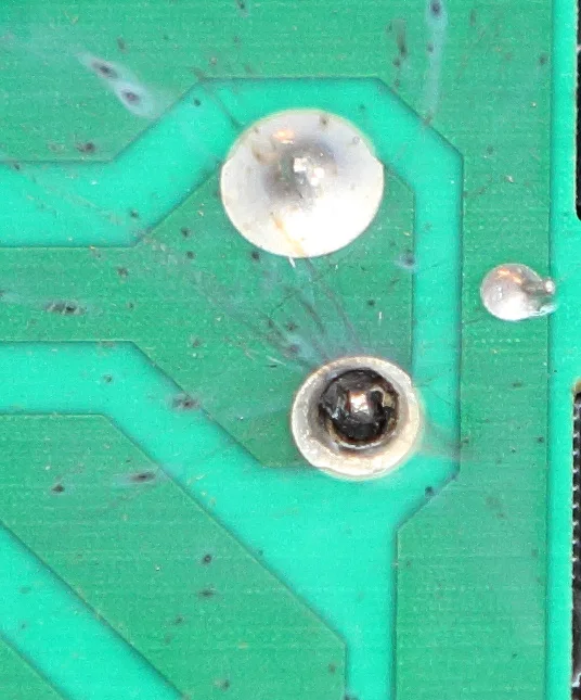

I've learned this lesson over and over again. If you're going to do ANY job, just spend the money and get the proper tools. They really do make a difference. Do the job correctly the first time and you won't have to spend more time and money later on to re-do that same job.A faulty soldering gun just proves that the right tools make a big difference: they make the job easier and improve its quality. I've encountered this many time.

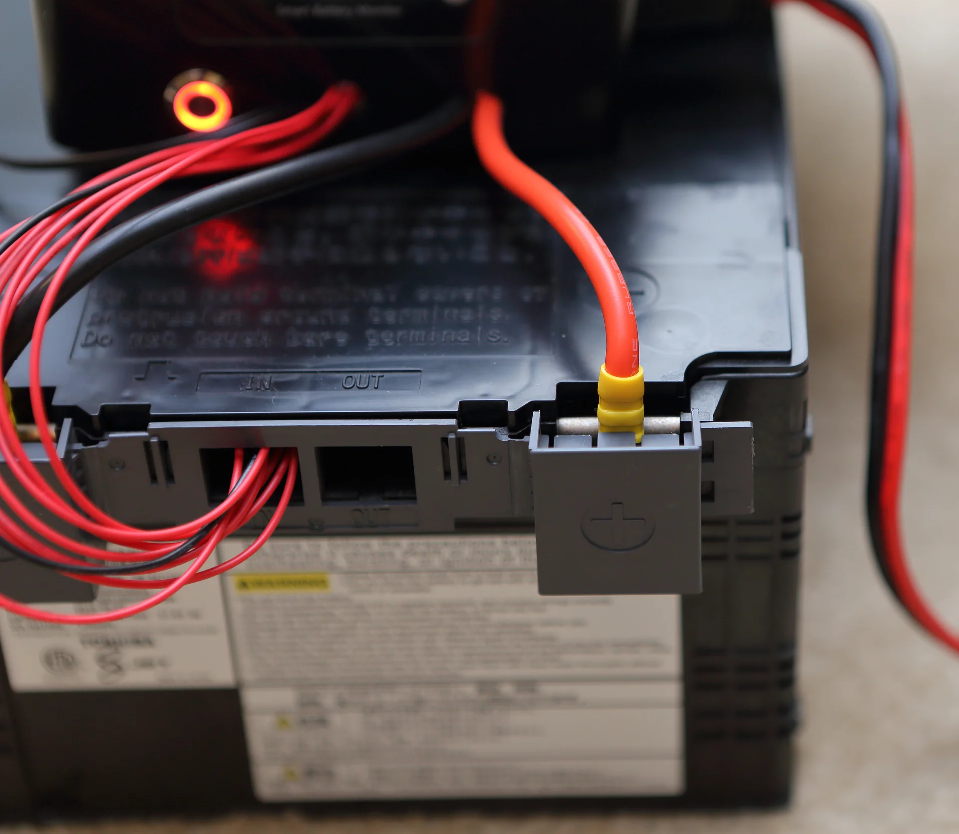

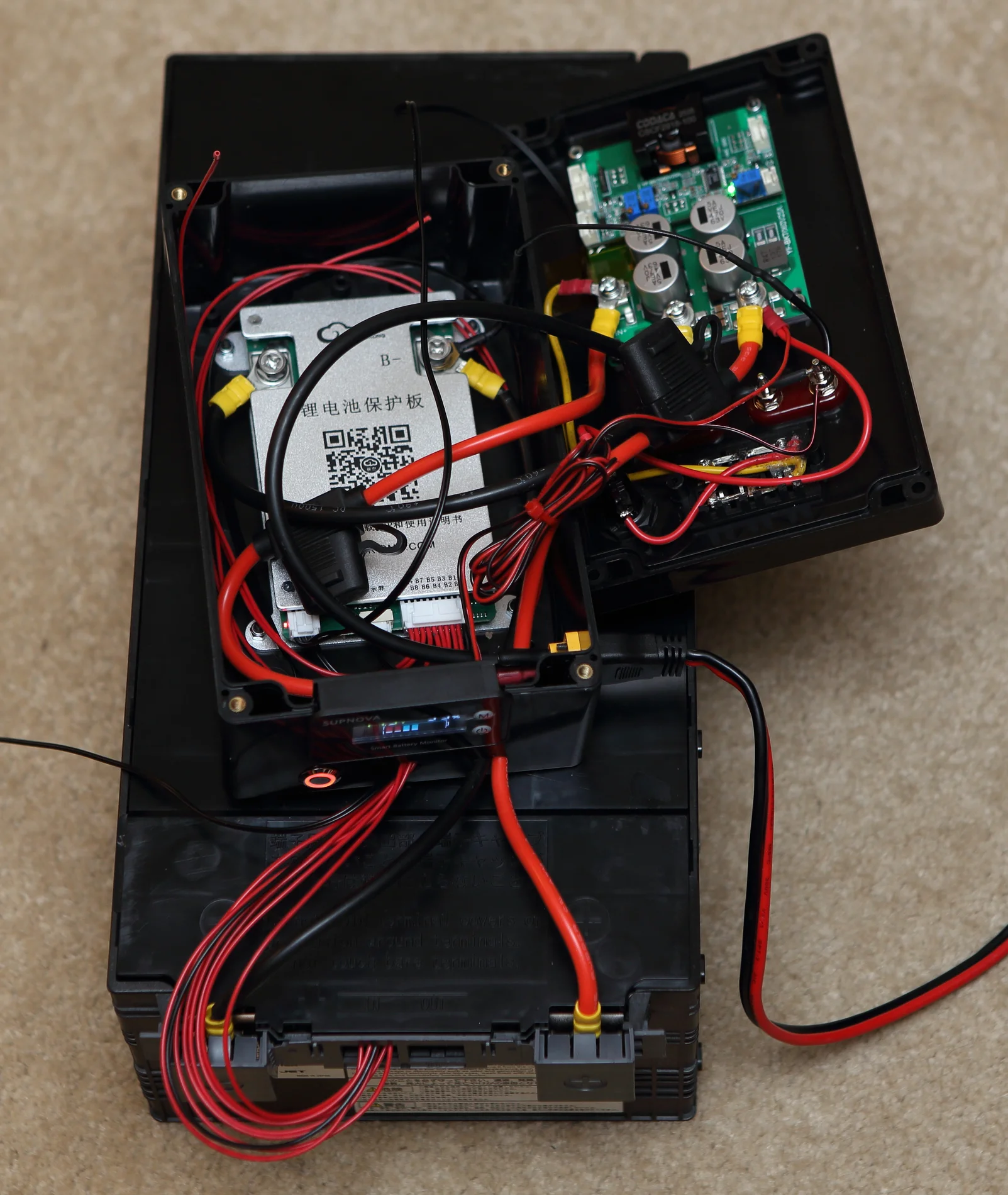

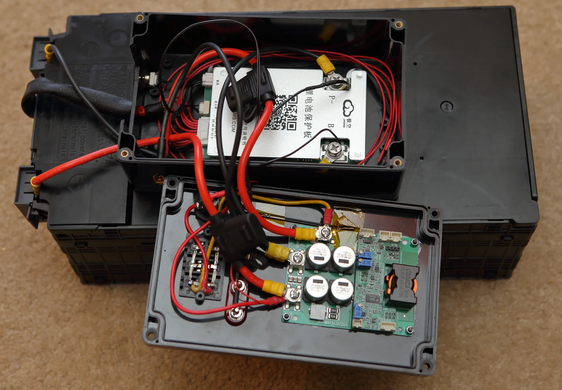

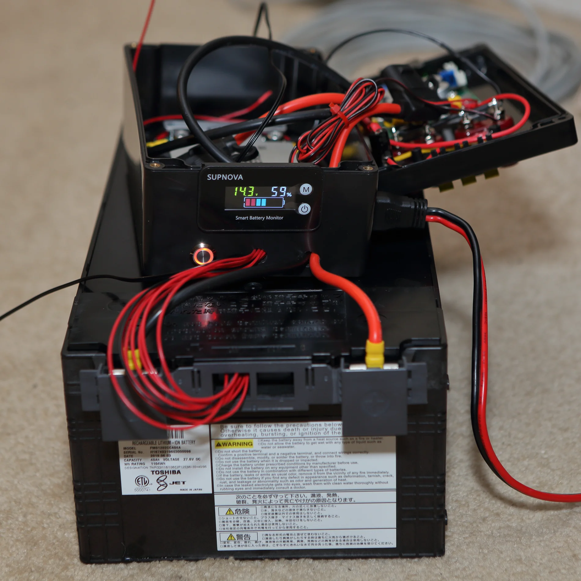

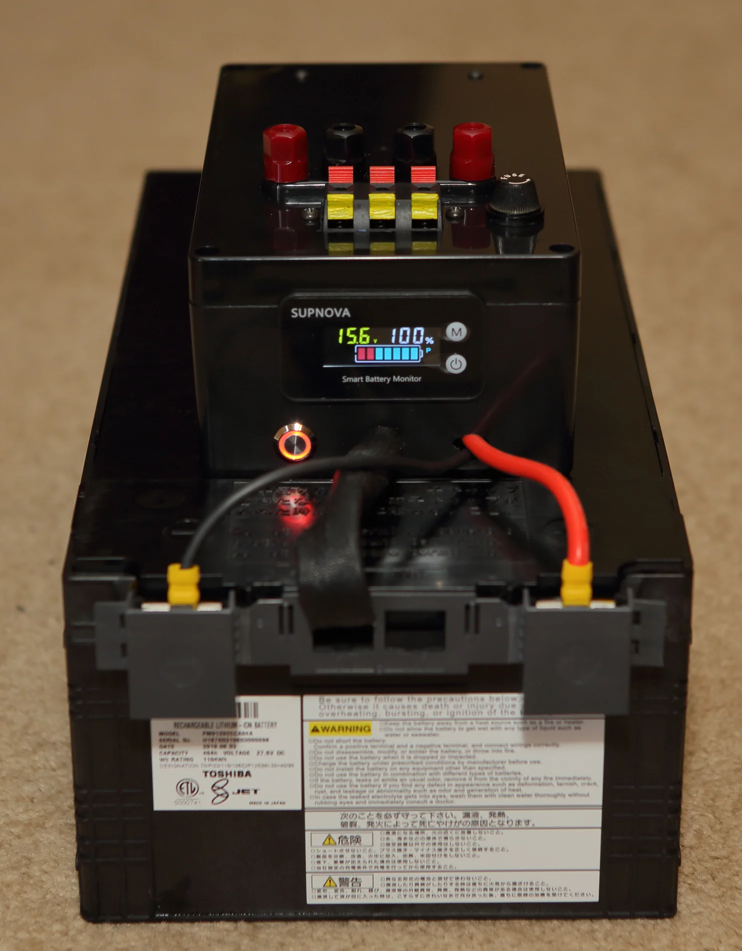

A nice benefit of having moved the eyelet is that the battery remains future-flexible. I can restore the original battery configuration simply by adding a jumper across the busbar that I severed.

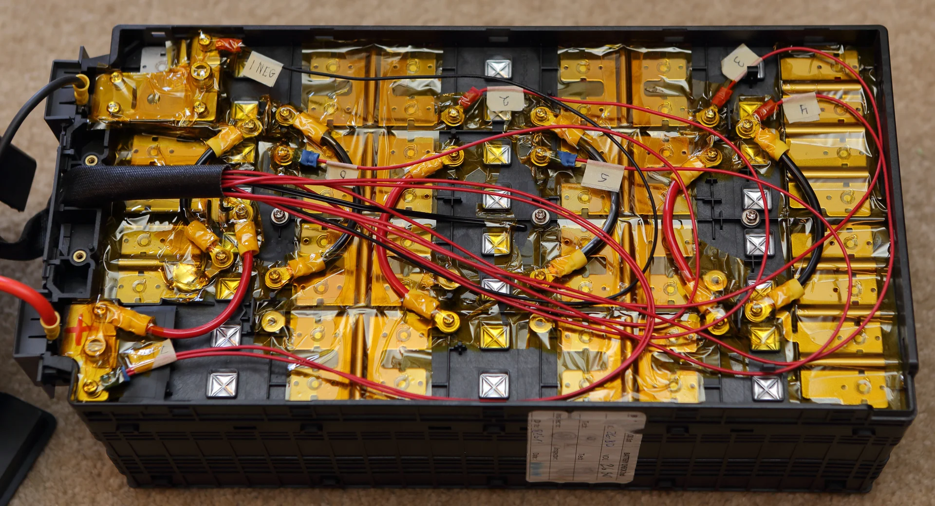

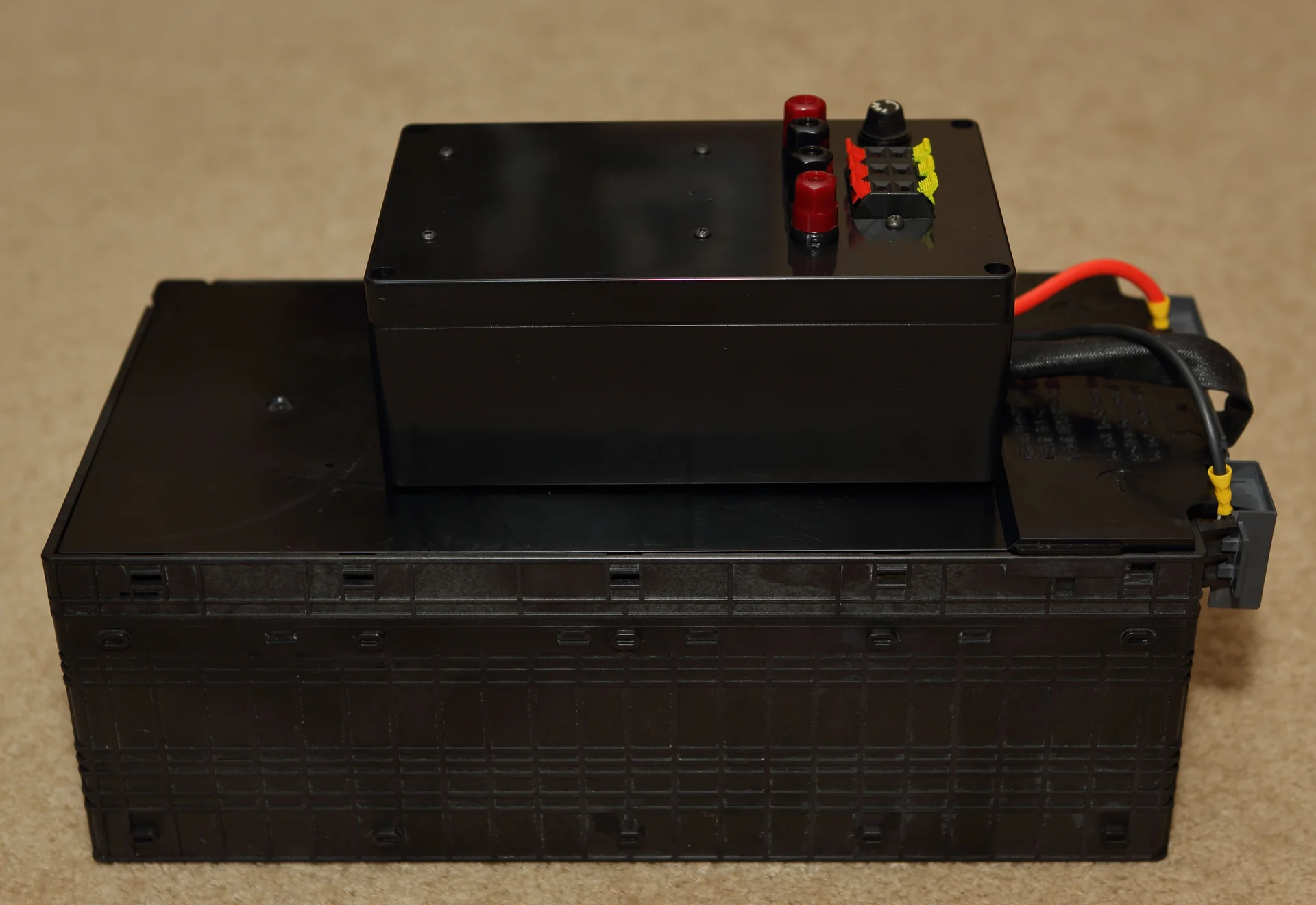

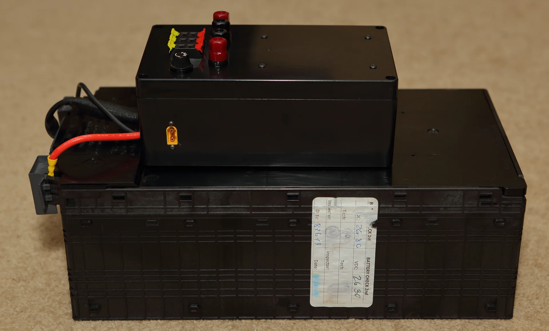

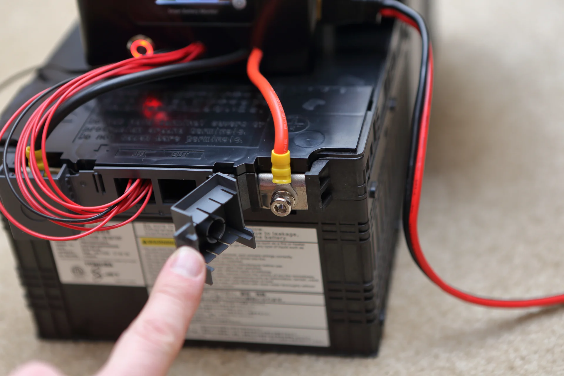

On a different note, a close examination of the battery pack reveals that all of the cells are in excellent physical condition - the outer perimeter of the battery pack is straight and true with no bulging along any of the sides or edges.
