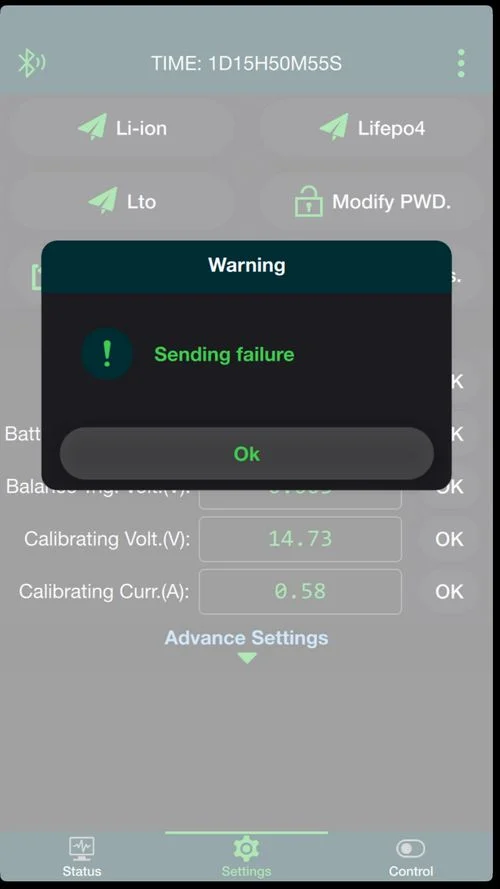

For some reason, I can't make this work. I connected a 27R 12w resistor across the red and black terminals that produced a current of 0.58A. When I type in a value and click "OK" I just get a Send Failure. I can't do the charge current calibration yet, I have to drain the battery more so the charge current will hold steady for a little while and give me time to match them up (if it lets me). I've been running a 5w camera in parking mode for more than 30 hours now and the battery has barely lost one full volt 🙂
I think it might be time to reach out to the JiKong tech support...

I was getting the same warning using 2ch dashcam drawing around 0.3A.
I then used an electronic load to find the lowest current draw at which I could calibrate, and in my case I think it was around 0.5A-0.6A.
Try discharging the battery at a higher current, perhaps around ±0.7A.
You could use a pair of dash cams with a total of 4 channels.
I think this current will be sufficient for calibration.
Guess I'll just start stacking up power resistors, then. The 0.58A draw resulted from putting one 27R resistor across the outputs. I have a few more that I can add in parallel that will drive the current higher. That should be enough if there are lower limits to being able to perform the calibration. By the time I get home tonight, the batteries should be sufficiently depleted to allow fixed current charging for a while, which will hopefully allow me to calibrate charge current too. The battery voltage level was only down to 14.5v after nearly 40 hours of runtime with a 5w, 3-channel camera. I think I've achieved my goal of longer runtime 🙂

Success! I was able to calibrate the current draw by using two 27R 10w resistors in parallel, this created a draw of 1.08A as measured with my DMM inline with the positive battery terminal.. Thank you for the tip about the minimum draw rate needed for calibration! I'll calibrate charging current tomorrow, the battery needs to be drawn down some more.
Edit: Ah, I get it now. If the Calibrating Current shows 0.0 in the app, then there isn't enough current in or out to allow calibration to occur.

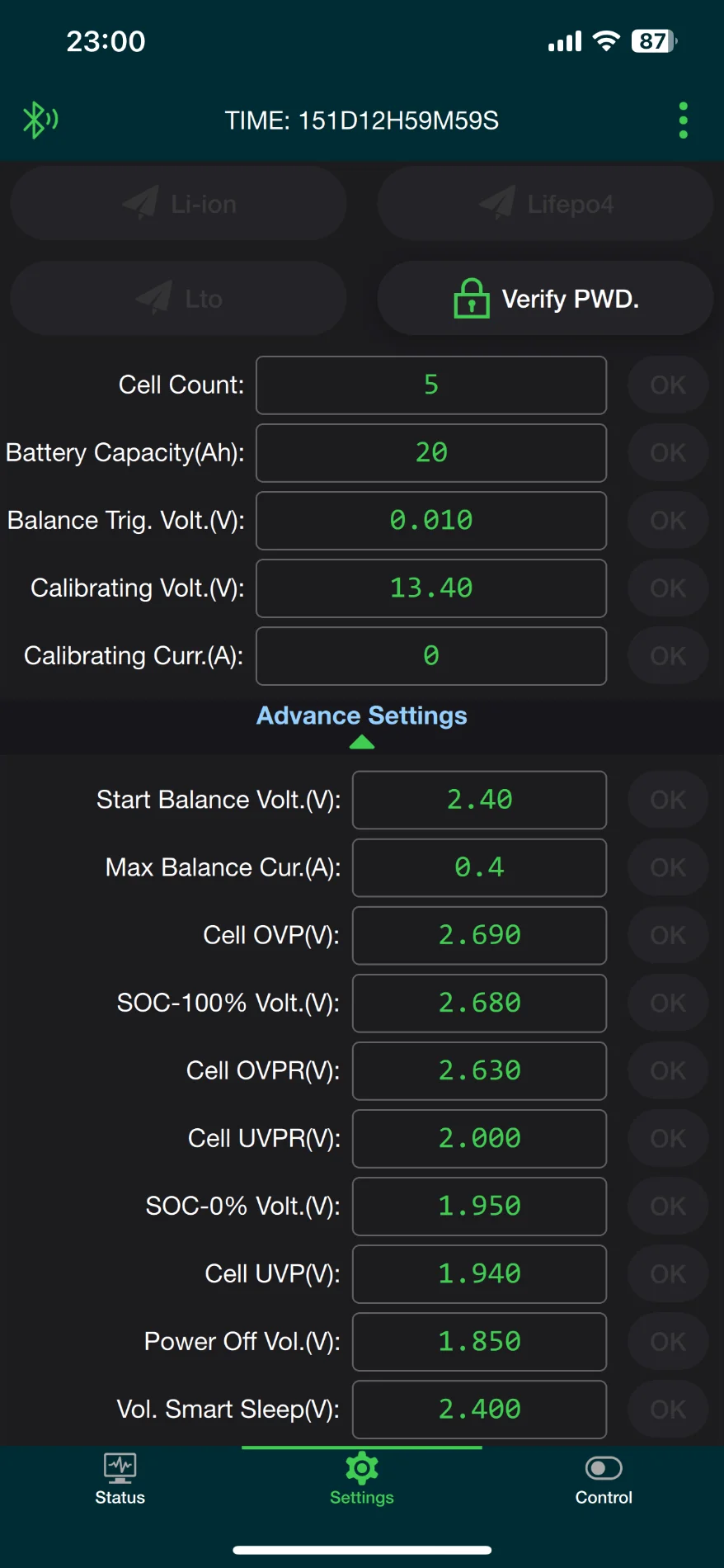

Attached are my updated voltage settings.
I can't/don't want to set the OVP(V) cell voltage to 2.7V - to do that, I'd have to open the box and increase the charger's output voltage (CV) accordingly to reach that voltage.
Currently it is 13.4V which corresponds to 2.68V per cell (for 5S battery), and it will take long time to get to 2.7V if it ever does.
So I set the "Cell OVP(V)" voltage to 2.69V and for the last 15-20 minutes of charging the BMS shows 0A charging but in reality the charging continues slowly, eventually reaching 2.69V at which point the charging shuts off with the message "Battery fully charged".
I set the "SOC-100% Volt.(V)" to 2.68V in my BMS without any problems.
