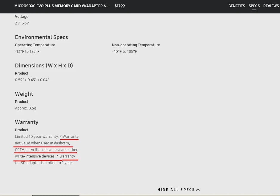

on samsung website says that:
Limited 10 year warranty. * Warranty not valid when used in dashcam, CCTV, surveillance camera and other write-intensive devices. * Warranty for SD adapter is limited to 1 year.
View attachment 48263Link: https://www.samsung.com/us/computin...rd-w--adapter-64gb--2017-model--mb-mc64ga-am/
That is because it is also limited by number of writes, and if you use a dashcam then you can reach the write limit before the 10 year limit. They are still good cards and used by a lot of people for dashcams.
