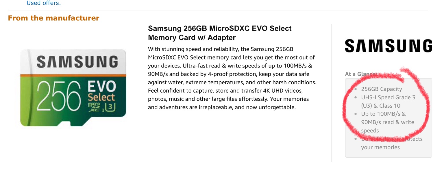

Whats up guys, how is the situation with y'all 256gb cards ??
Also there is a deal running on amazon, just not sure if it's a true u3...
Samsung Evo Select 256gb
It is a U3 Card, I was thinking of getting this myself. The camera will run a 256G card
