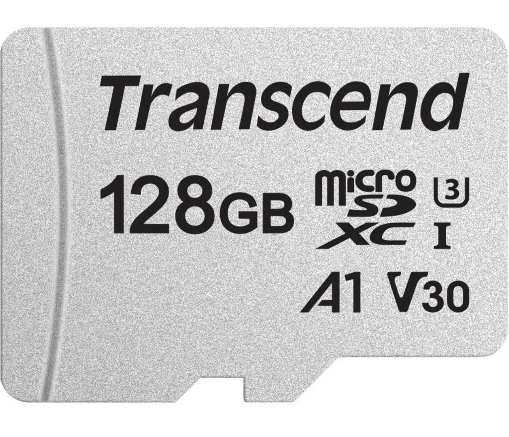

From VIOFO A119 V3 thread
Just back in from a trip out and sure enough the Transcend card was causing those random issues earlier with missing footage thanks - with the Integral Ultima Pro 256GB card all files are 3 minutes as expected 👍
This was the exact Transcend card that didn't work well at all for me on firmware 1.02:
https://www.amazon.co.uk/gp/B07C9PVLN8
I notice Amazon UK are pushing Arcanite cards as part of their Accelerator program so I guess there will be people using those popping up soon - no idea how they're performing but they're an Amazon exclusive and if they're no good they'd get sacked off very quickly.
we've returned several hundred of those same cards
Avoid this card at all costs. (Nothing but trouble)
That’s just a picture and does not say what card it is. All we know is it’s a 128GB Transcend card, and it doesn’t say whether it was simply defective or if there’s some known issue with it.

Transcend were a great card ... what happened? They were hard to find for a while ... Got no idea - did they change manufacturer by any chance and opt for a cheaper process? Anyone know why they are now dodgy and have their reputation going down the gurgler?
their new High Endurance cards are probably still fine, haven't tested them though, they haven't changed manufacturers, they are the manufacturer, why they have changed these particular cards though I have no idea, I don't think it's about price as they're actually dearer than some of the other options
I don't know but lots of people with lots of different cams have had problems with their silver cards 😡 Their old 400X was my go-to awhile back and it was superb giving about 3 times the expected lifespan for me, but it seems to have been discontinued 🙁
Seems the top brands are experimenting with different technologies to save a few $, Samsung Endurance is only U1, Sandisk Endurance doesn't appear to have a long life, Transcend doesn't work in cameras, Samsung Evo is rather variable in speed, etc.

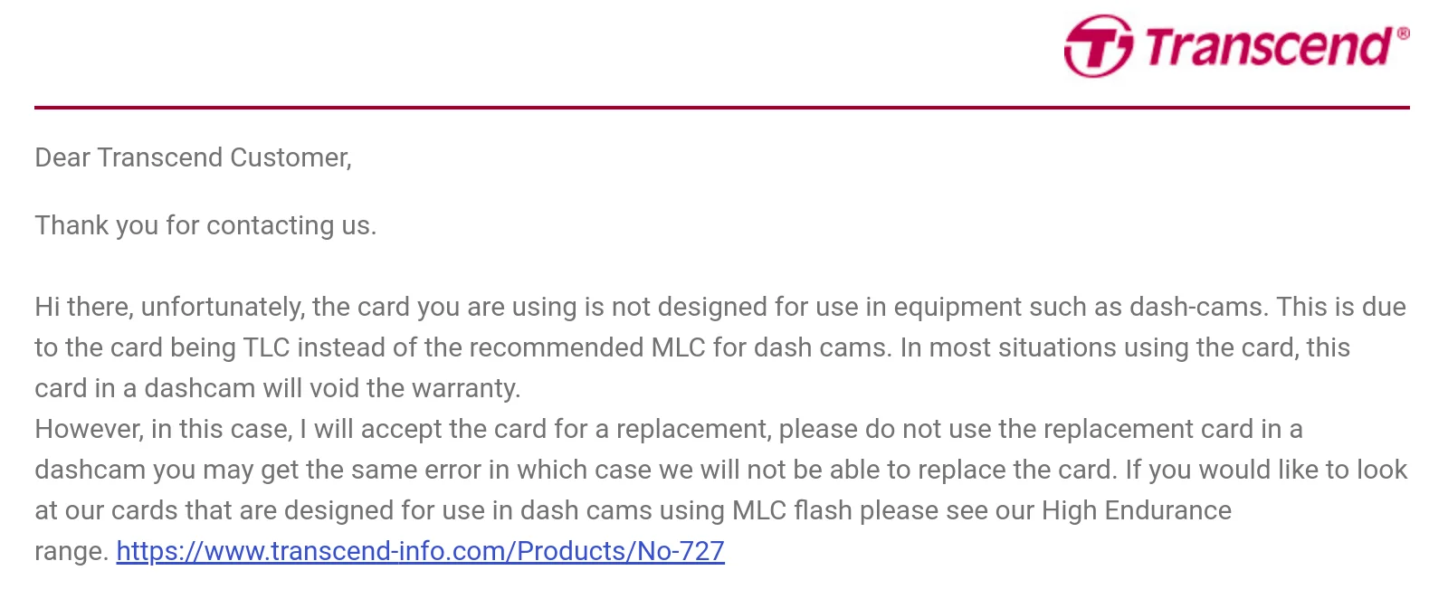

Just to add to the Transcend silver info, support have confirmed that they shouldn't be used in dashcams.
At least TLC cards used to work in dashcams albeit with a shorter lifespan than an MLC card, this one does not though.
all their prior TLC cards were no issue in dashcams, it's not the TLC that's the issue, I suspect it's the controller they're using that is the problem, not something they're likely to elaborate on though I suspect
