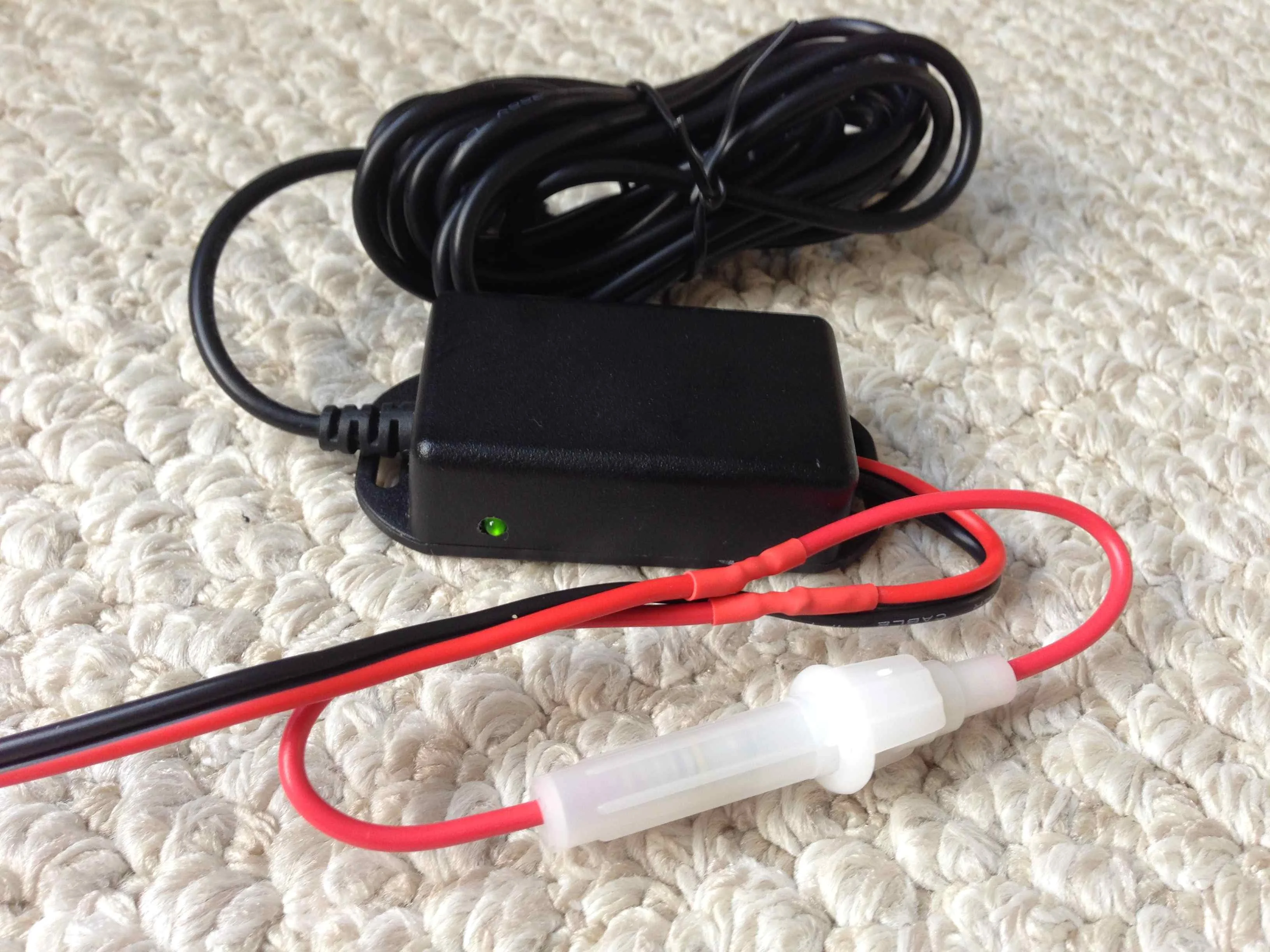

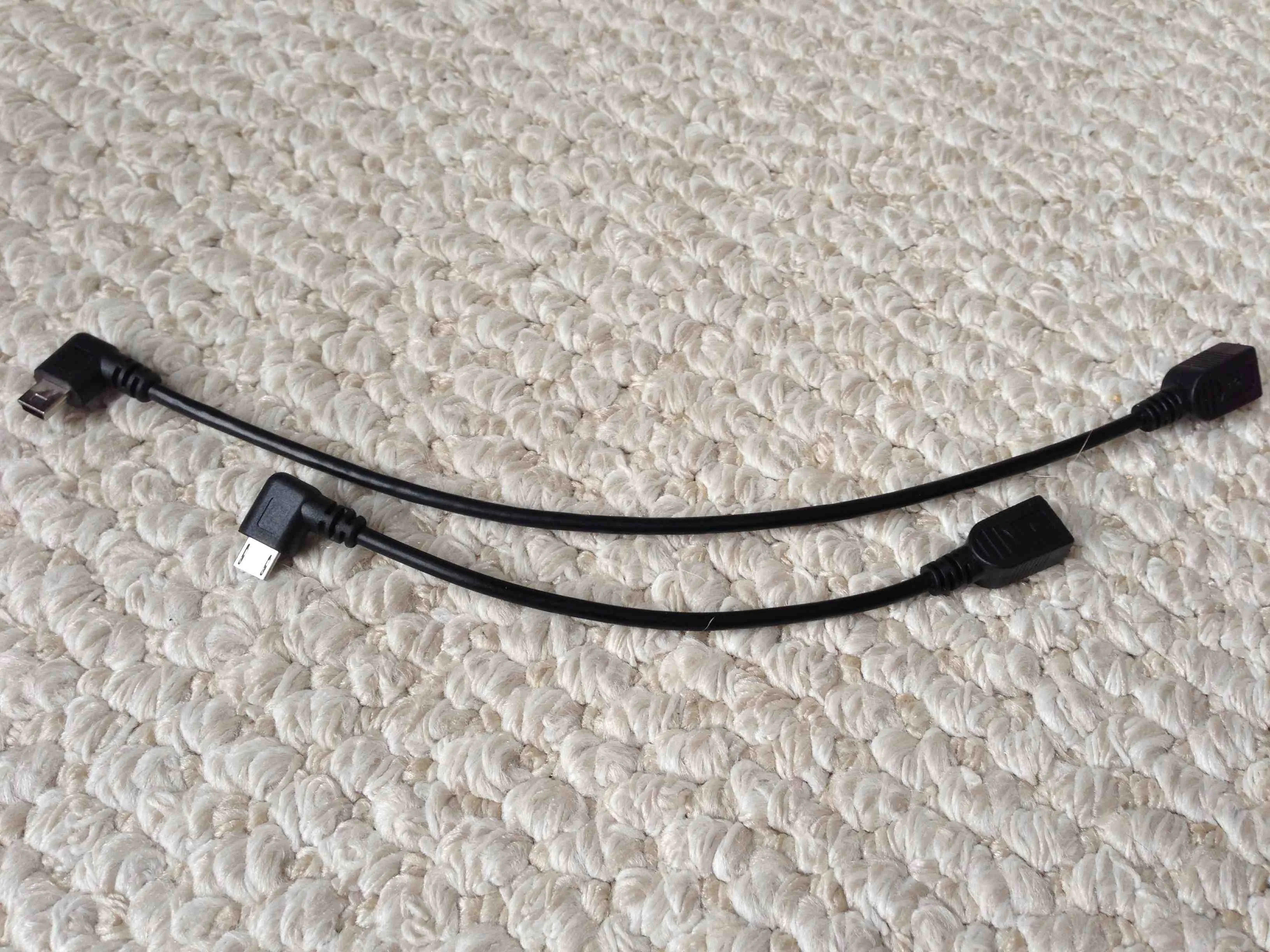

I do not worry about 0803 as I know I could easily switch to 0801 because of I set up direct PS (5V) terminated with mini usb, and use a specific short tail piece with connector matching the camera exactly the way I want it. I just converted the supplied USB cigarette lighter charger to direct one with cheap enclosure ($5) and fuse holder($1).
I know I could buy a direct 5V adapter for less, but when I looked inside of it - it was so tiny and microscopic that I doubt it could hold 3A it was rated for, also it supplied 5.15V only. The PS supplied with camera produce over 5V (~5.5V) to compensate for long cable run.

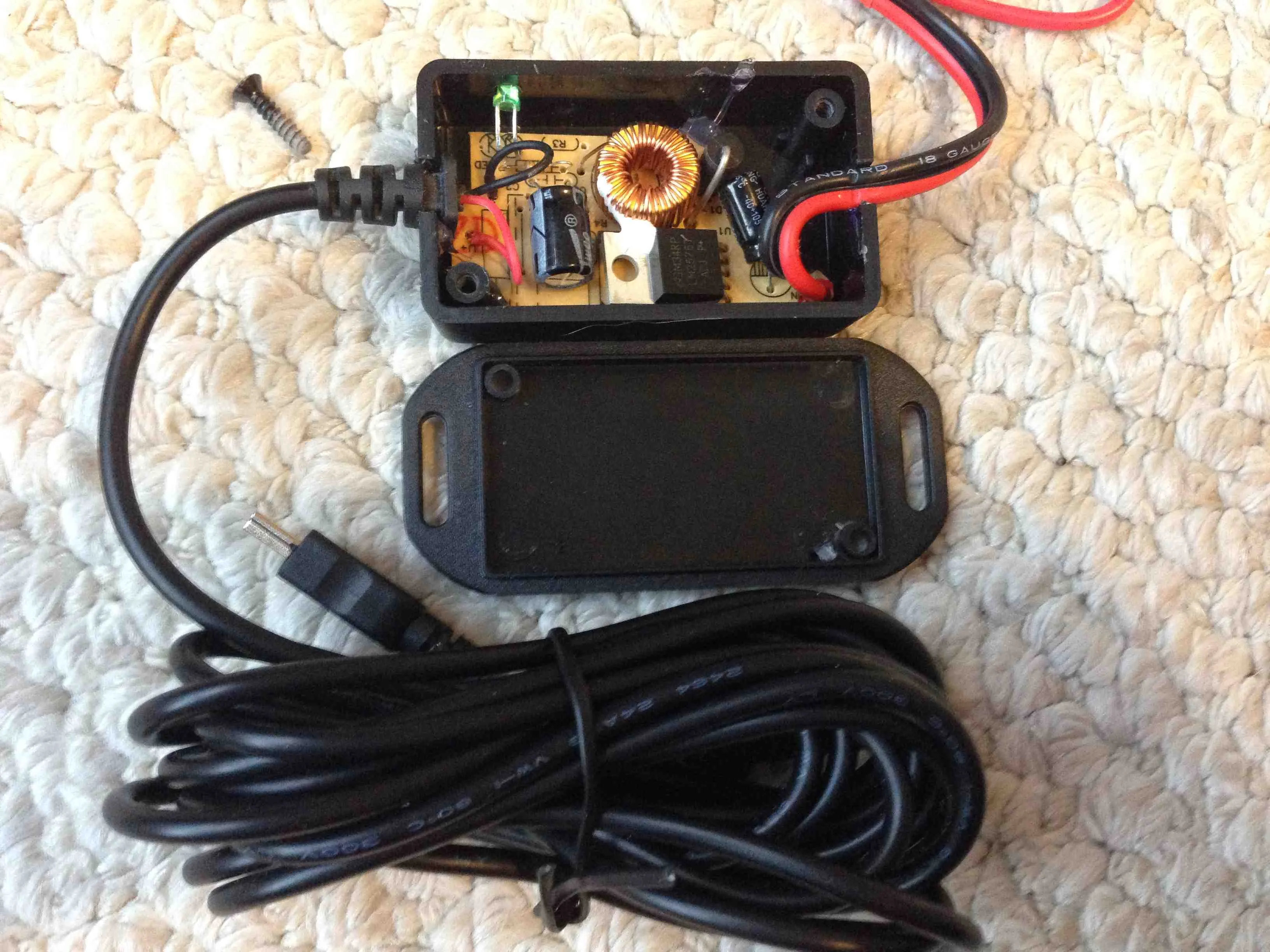

Do you have any links to the enclosure you used, and perhaps a photo of the conversion with the cover off of the enclosure.😉
Enclosure: https://www.amazon.com/gp/B003A698L8Fuse holder: https://www.amazon.com/gp/B0002KR8EE
I used double sided tape (same one as on the mount) to mount the enclosure to other parts surface on top/behind of the the glove box compartment, so it is easy to access it and replace fuse if needed. Left some slack in wires so I could just pool enclosure out enough and replace the circuit board if it fails in the future.
To fit PCB inside of this enclosure I had to file off small area of PCB, next to screw post to curve the PCB around it (opposite to LED corner). The filed off area does not affect circuit as neither optional components are used nor any path is interrupted at this corner. Dremel or grinding wheel would do this job safely.
I used this charger to get mini usb cable and will use its circuit board as backup: https://www.ebay.com/itm/121190461512This is the tail-end for micro usb (0803): https://www.ebay.com/itm/261129558804Here is mini usb tail-end (0801): https://www.ebay.com/itm/291121551273
Attached photo of direct USB adapter for comparision.

Thanks for the detail - will have to get some 'bits' and make a couple for our cars.
