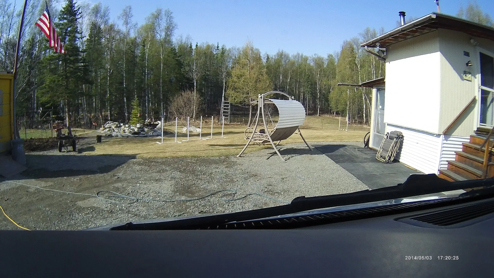

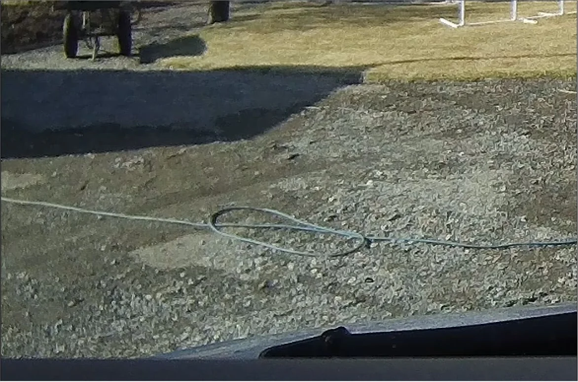

From the 0803: Windshield and camera just cleaned. There are 2 pics from the camera just sitting in the drive, one full screen and one zoomed into the gravel right under the nose of the car. The gravel looks like giant gray potato chips, not gravel. That is the same view I get from a license plate, just blur.

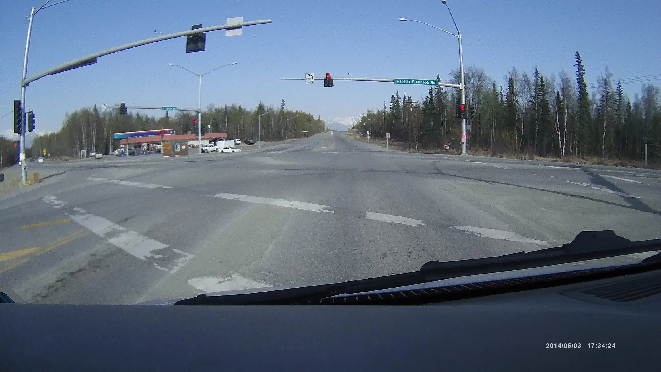

The pic from the intersection is in the 2304 x 1296 setting with WDR off. Pretty soft image and if I zoom in a little it is that watercolor look, everything runs together. Not much detail. Looks exactly the same as the 1080p.

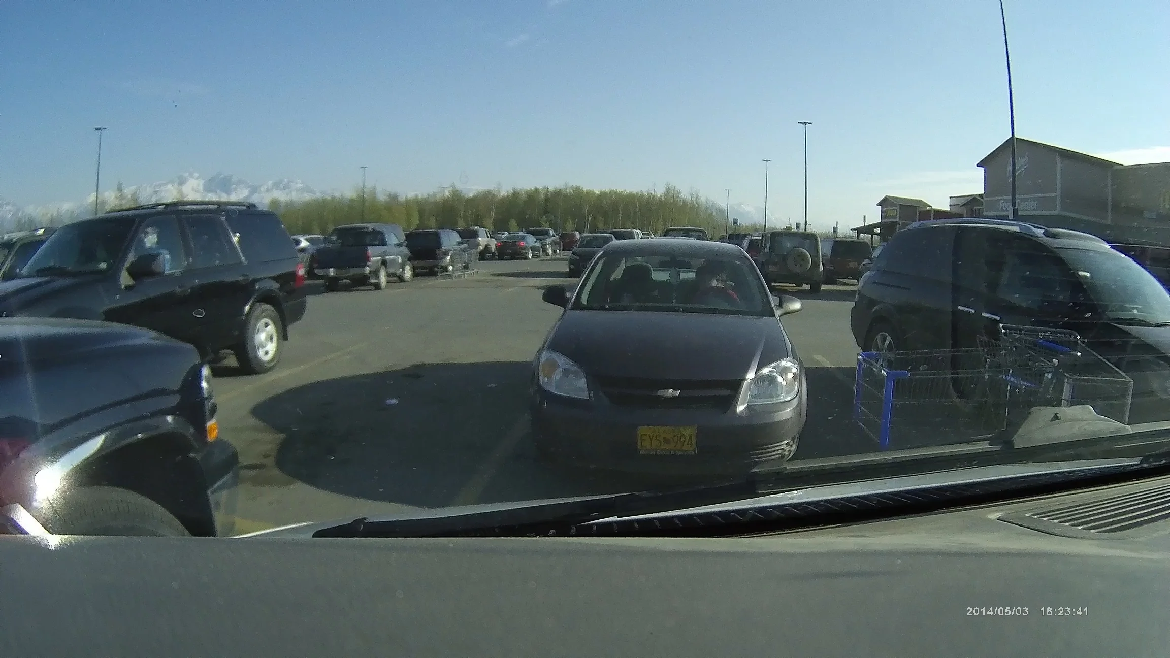

The picture with the car in front is in a parking lot. We are just about to touch bumpers, maybe 3 feet apart. I can't even see if the person in the car is a man or woman. I can at least read the plate, but it isn't very sharp.
Yeah, the picture quality is awful - I am preparing my unit for return. Even if it would be fixed - the bit rate is just crazy - it would be eating SD cards for breakfast.
I agree.
These images are terrible - as bad as my crap mobile phone.
I think I am definitely going to wait for a while after release of the final production units to see if there is any improvements to the image quality and the bit rate issue.
Ouch, looks like this camera isn't living up to par yet when it's suppose to be an upgrade from 0801.... I really hope these quality issues will be fixed because there's a lot of potential.

dashcams generally take pretty poor photos
this model never had a 5mp sensor so it hasn't been reduced
the problem has been oversharpening and has been a fix that Ambarella has had to sort out, it is much better now than the original version back in January was which was very poor to say the least, there's room for further improvement still but a big improvement overall
