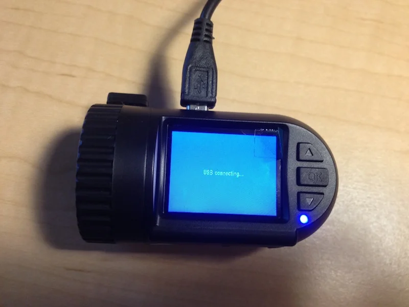

I'm new here but just purchased two 0803 mini dashcams from Foxoffer and I'm having the same issue that someone else posted above. When I try to connect them to my computer using the USB cable, the screen just displays "USB Connecting..." with a blue LED illuminated, but nothing happens. I'm unable to connect either of the cameras to any of my computers (running Windows XP, Windows 7, or OSX 10.8.1). The two cameras have 16GB internal memory and GPS base. 🙁
Try another USB cable ?

I am new here as well and am also having the same issue with my 0803 with 16gb internal memory when using the usb supplied cable, a blue screen saying usb connecting and that is it, cannot seem to transfer data to PC to view video.
I am going to try a micro sd card and see if that will work but still does not explain the blue screen with internal memory.

When my Windows PC is connected directly to the camera body, I also see 'USB connecting...'
However, I have assumed this to be normal, because my PC (under 'computer' from the 'start' menu) recognises the internal camera memory as a 'Removable Disk', and I can access and copy files.
There was no other functionality available with the camera whilst it was connected this way.
If the disk doesn't show on the PC as a removable disk, then maybe its a PC problem rather than the camera - have you tried another USB port on the PC?
When I connected it to the PC via the USB plugged into the mount, the camera options were all available on the built in screen.
Anyway, it is always better to use a SD-card reader
I tried three different USB cables - two of them came with the cameras, and the third one was my own. Still nothing. In fact, I used one of the cables to connect to another device (an MP3 player, not the dashcams) and it connected without issue.

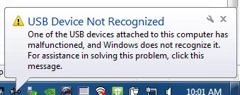

It sounds like Tatsudoshi's issue is identical to mine. I can't load anything, or view anything, from the camera on my computer.
A new drive DOES show up on my computer, but it doesn't work (as per the attached screen shot).
Also, Windows displays a failed USB connection message (as per the screen shot).
