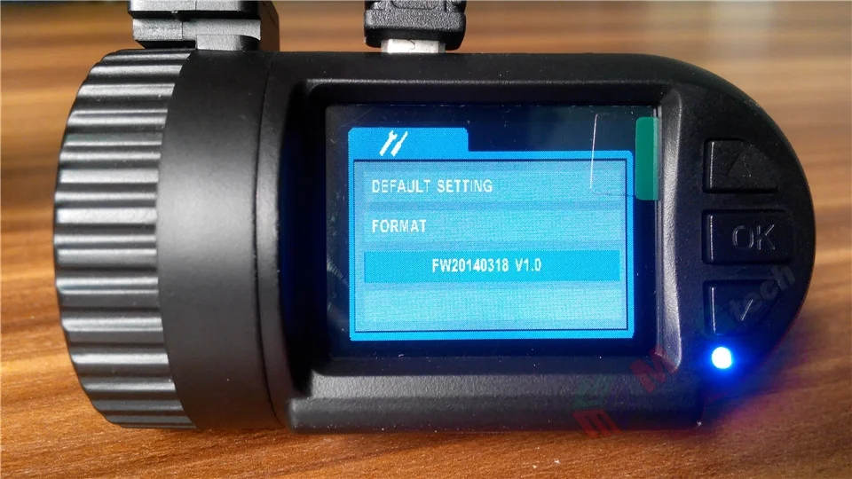

Hello. Tell please how to use LDWS? And firmware 0801 more nuanced than 0803. Will there be a new firmware with even greater settings and languages?
Thanks i'll give it a try, mine is awful. The wifes one is fine.Anyone having a little trouble with the mount being a little loose this is how I fixed mine
chris-s' post re. LDWS is here....Hello. Tell please how to use LDWS? And firmware 0801 more nuanced than 0803. Will there be a new firmware with even greater settings and languages?
Not sure about about the latest FW developments/languages. @Rayman.Chan - Any news about FW development for the Mini 0803, please?LDWS testing and GPS .srt from Registrator viewer testing 🙂
