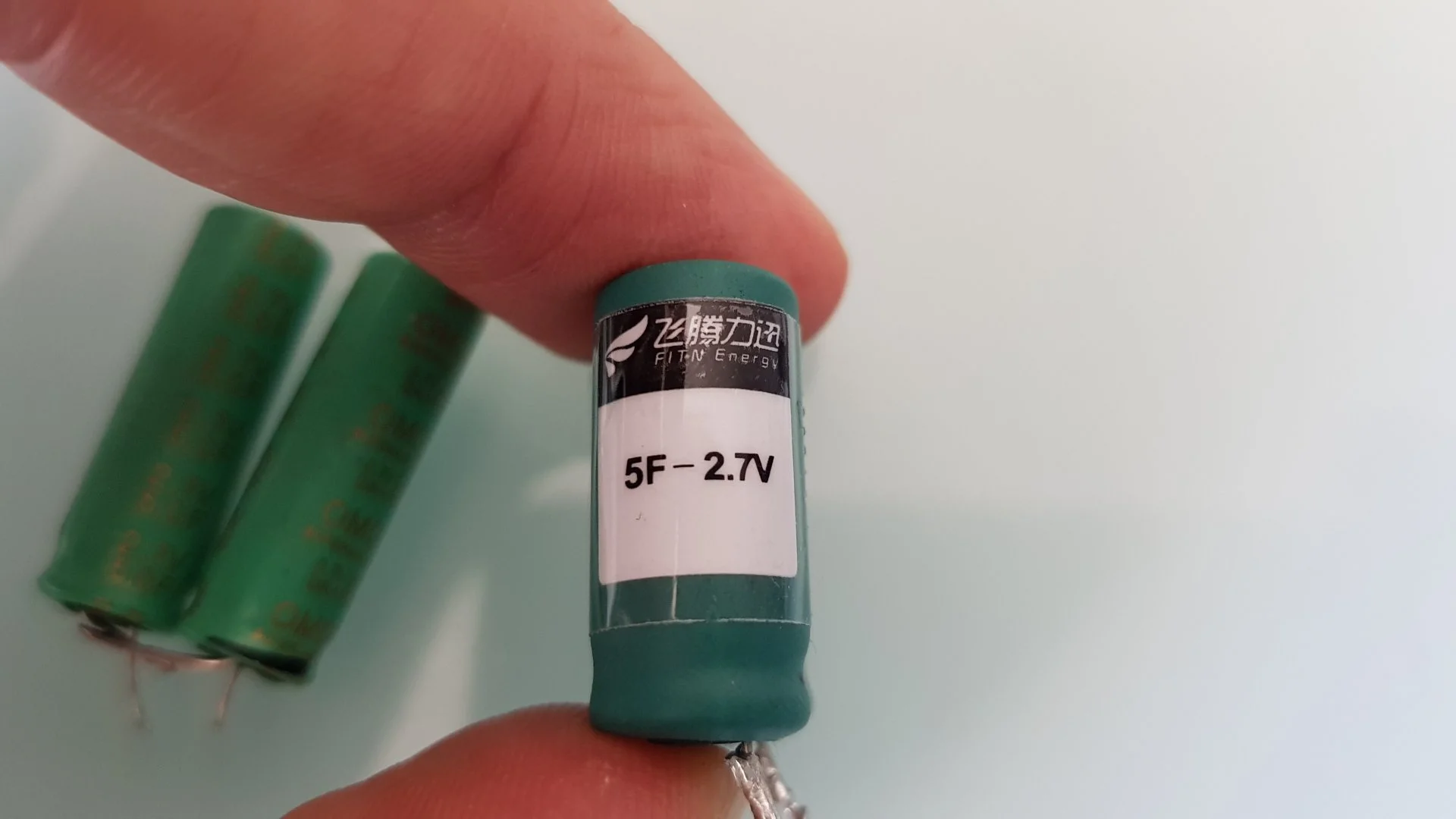

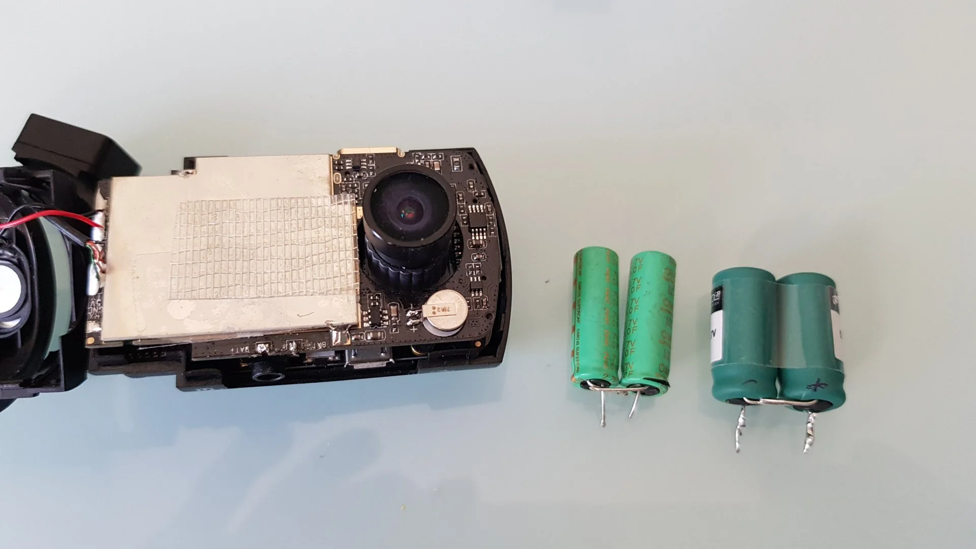

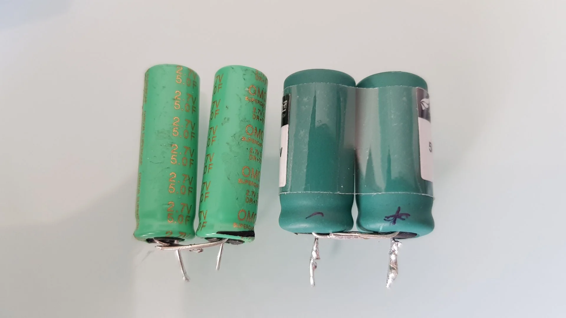

@jokiin okay, I find in 0806S 2x OMO IX SUPERCAP 2.7V 5.0F
but on ebay I only find 2.7V 3F or 10F
can I also use 10F instead of 5F?
OP
T
Tungsten E2
Mar 4, 2016
142
27
Germany
I received 5.0F-2.7V
They are too big, I can not close the housing, but in general the fix seems to work.
@jokiin Any idea where to order 5F-2.7V with right dimensions?
