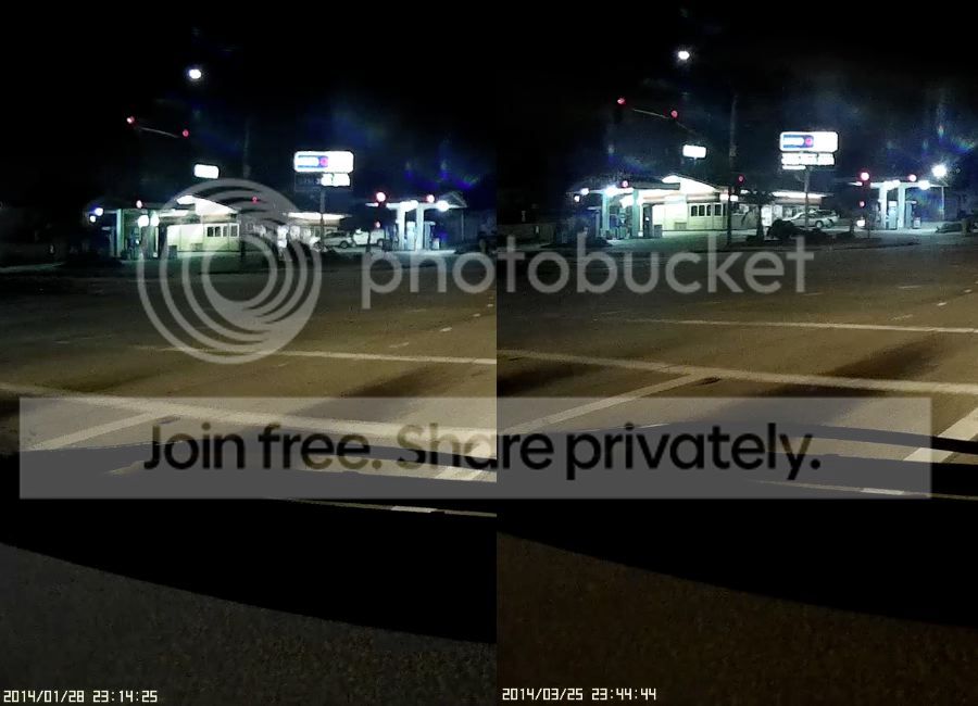

The image of the left of the frame was from version 1.13 and on the right of the frame is version 1.20. It's hard to get an exact match, but this seemed to be as close as possible. There's a tad more dynamic range with v1.20 compared to v1.13. Look at the wall on the far left of each image.
