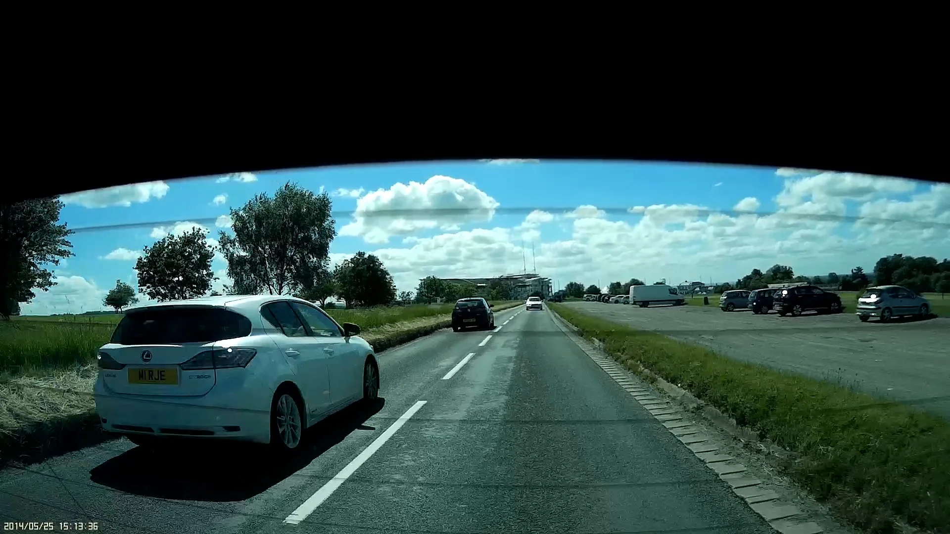

The rear screen tint was making the rear cam video a little dark, so I changed the White Balance Setting from 'Auto' to 'Cloudy'. I also changed the front cam FOV from'Wide' to 'Narrow', just to observe the difference. Both Mobius B cams currently have the same settings... Firmware v1.20, 1080p/30, Narrow FOV, Low-Light enabled, WB Cloudy, Data Rate Standard.
Here's a couple of video frame grabs taken in sunny weather...

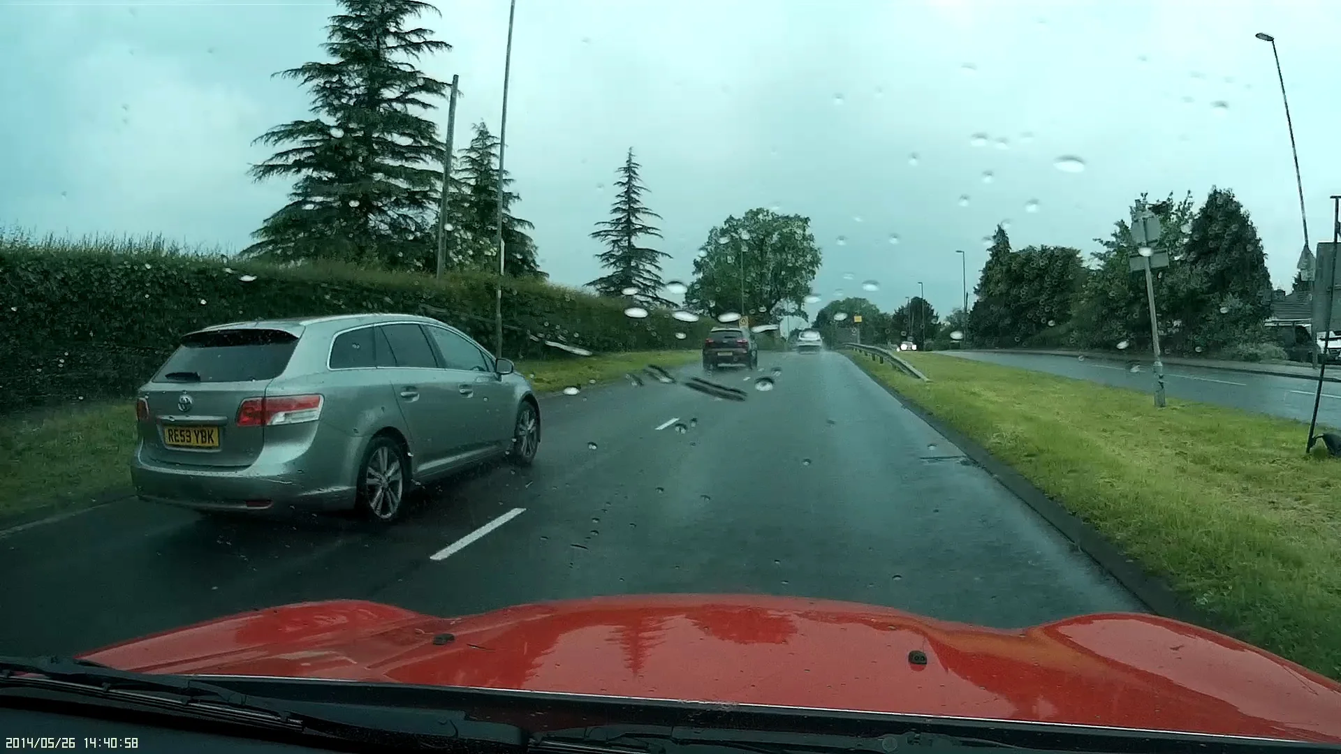

Here's a couple taken in wet weather...
Aesthetically, I prefer the Narrow FOV, though the Wide setting makes more sense from an 'evidence' gathering perspective. Think I'll leave both cams in the 102Β° Narrow HFOV setting for a while...

The rear screen tint was making the rear cam video a little dark, so I changed the White Balance Setting from 'Auto' to 'Cloudy'. I also changed the front cam FOV from'Wide' to 'Narrow', just to observe the difference. Both Mobius B cams currently have the same settings... Firmware v1.20, 1080p/30, Narrow FOV, Low-Light enabled, WB Cloudy, Data Rate Standard....
....Aesthetically, I prefer the Narrow FOV, though the Wide setting makes more sense from an 'evidence' gathering perspective. Think I'll leave both cams in the 102Β° Narrow HFOV setting for a while...
I've just moved my Mobius B lens to the back of my car to make way for the Mini 0803 at the front (for the time being at least). The timing of your post re. using 'Cloudy' WB setting was great, as my car has a dark tinted rear window. Suffice to say I am now using that setting on my rear mounted Mobius B, thank you!

I found the FW 1.20 no-flickering 'sweet spot' just once with the my Mobius B.πŸ™‚ But I couldn't find it ever again, even after trying more positions than an contortionist during a circus act!πŸ˜›
It may not be the optimal solution for your dark tint, in which case experimenting with the 'Exposure' slide might yield better results?
