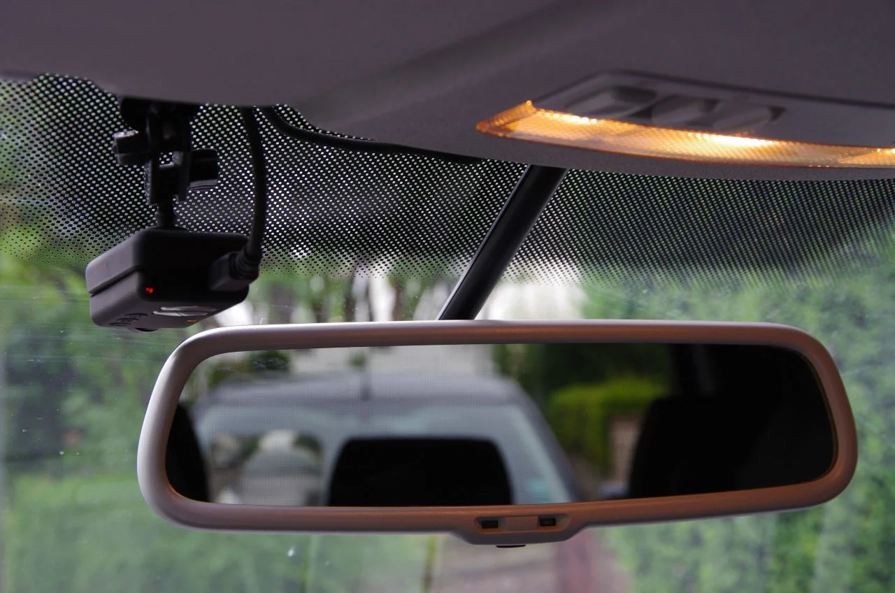

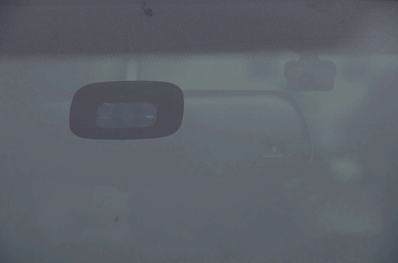

VW Caddy 2012
Bruuuz, how do you keep the suction cup attached to those patterned circles? My gopro mount wouldn't stay attached.
It's not a suction cup, just a plate with a thread. I used a special tape from Ford, which is used to mount the rear-view mirror.

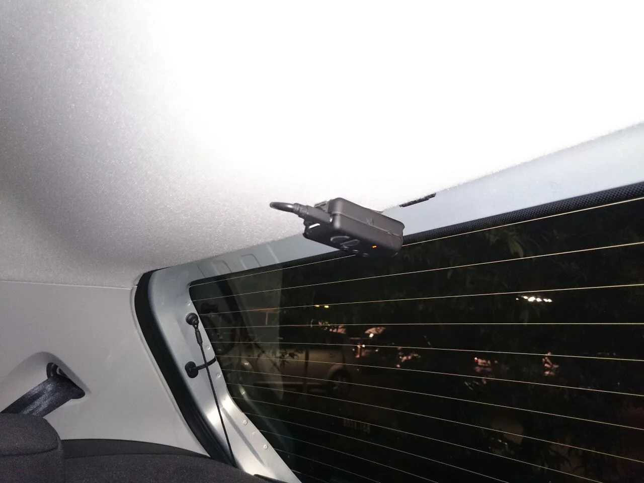

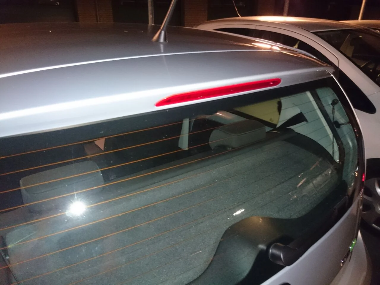

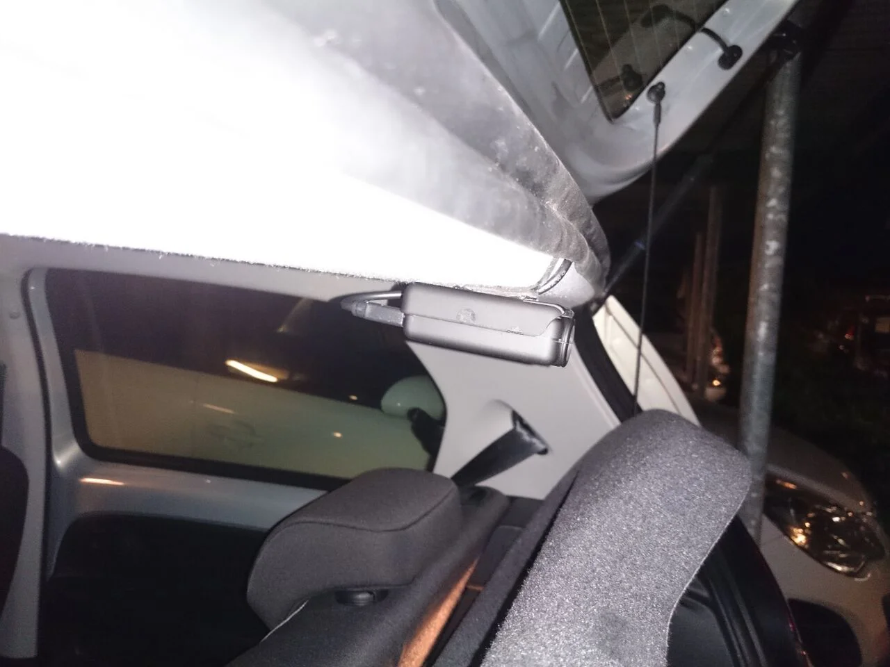

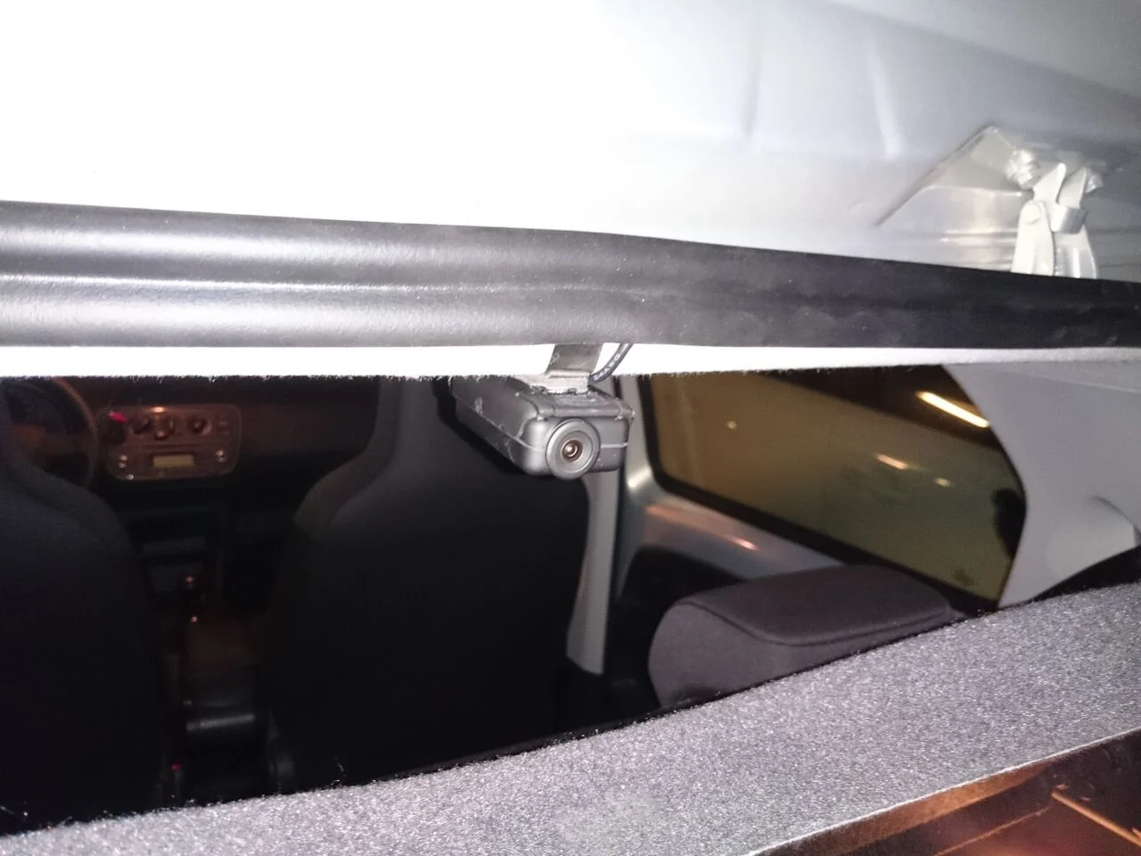

I've used a spare money clip and some double sided tape, to make a very low profile mount for my rear-facing Mobius.
I had to sand the rubber-like coating off the cradle to get the tape to stick. It is also layered in a wedge shape, to angle the cam downwards a bit.
The clip was bent into shape using a clamp and a rubber mallet, so that it hooks over the ceiling.
