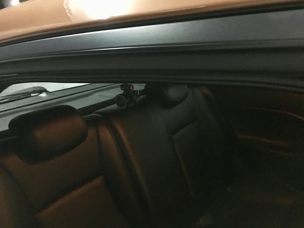

Coverage wise this position gave the best view but the module gets in the way, hit my head and moved while getting in and out of the car.
Had attached the Mobius to the grab handle using a small piece of VHB tape, didn't like how the entire set up looked, especially how the lens module looked hanging off the FPV holder.
Moved it closer to the B-pillar and attached the Mobius to the interior B-pillar trim but this set up resulted in the B-pillar eating up most of the FOV.
Really wanted this mounting location to work but the coverage wasn't adequate. All the camera saw was an angled view out the rear window, useless.

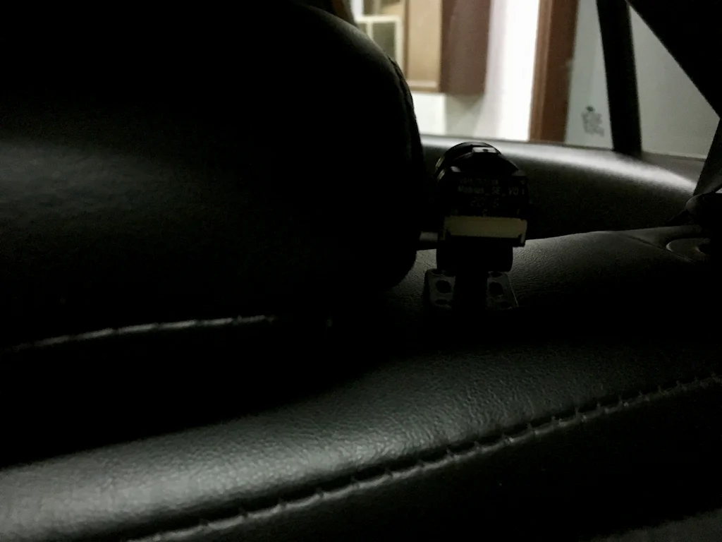

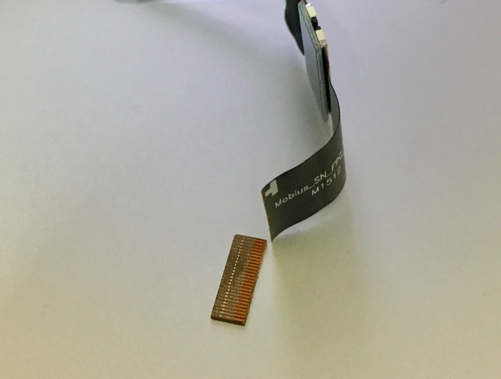

An example of how fragile these bits are, snapped off while I was aiming the lens from next to the rear headrest. The 8mm's ribbon-cable came to the rescue.

@Harsh, how about moving the camera over so that it is farther back? From my experience this may work better. The camera's FOV can then be adjusted by aiming it more to the left or right. The wide coverage of the C2 lens provides some wiggle room for aiming preferences.
Also, once you apply the heat shrink tubing, the fragile ribbon cable assembly will be well protected. The shrunken tubing makes for fairly good armor.

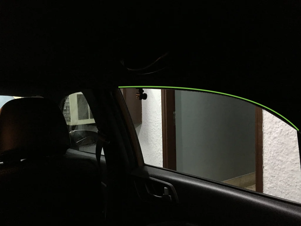

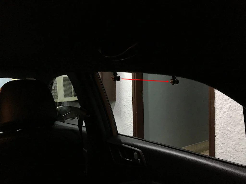

Tried it at intervals along the green line but still came in the way while getting in and out. Also moving away from the grab handle meant mounting the Mobius directly to the headliner, not something I want to do. Just didn't look right either...
That's too bad. I really like the possibilities of that mount you found. I wonder if it might be possible to mount the module directly on the lip of your door so that it won't block egress or ingress?
I know it's not ideal but maybe it could work?
Don't think that'll work, especially the way the wiring will have to go. Also too obvious just sitting there.

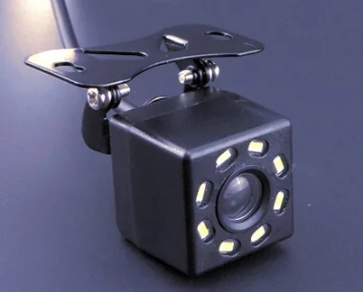

I was wondering about a small cube box like many Chinese backup camera to put the Mobius inside. Have you tried that?
I read your post while searching through the forum. I'm not skillful enough for DIY project so I wonder if there is something available out there
Off hand I don't think you will find a ready-made solution (small cube box) that will not require at least some sort of DIY work.
