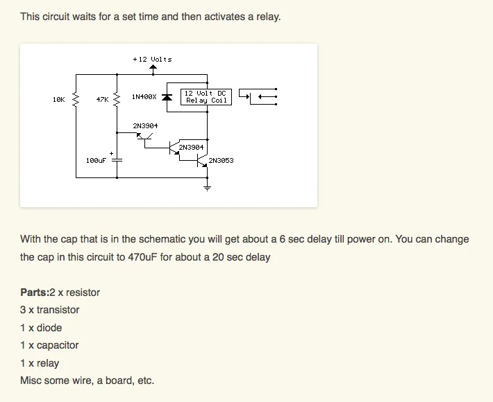

I've already stated that I don't know much about electronics, so I make this suggestion with the knowledge that it may not be at all practical but wouldn't it be fairly easy to build a little DIY relay delay hardware accessory that would plug into a cigarette lighter socket and would have another socket built into it? (like a short extension cord) Over the years I've had friends with good electronics skills build little circuits for me that I've used in my photography profession and short wave radio hobby, for example.
a quick search turned this up:
They should be able to sort this in the firmware, I don't think there's any need to resort to making up relays etc just yet

If all else fails, there's always my DIY delay circuit gadget idea to try. πŸ™‚
There's certainly no harm in doing your timer circuit, I believe the problems are addressable though
