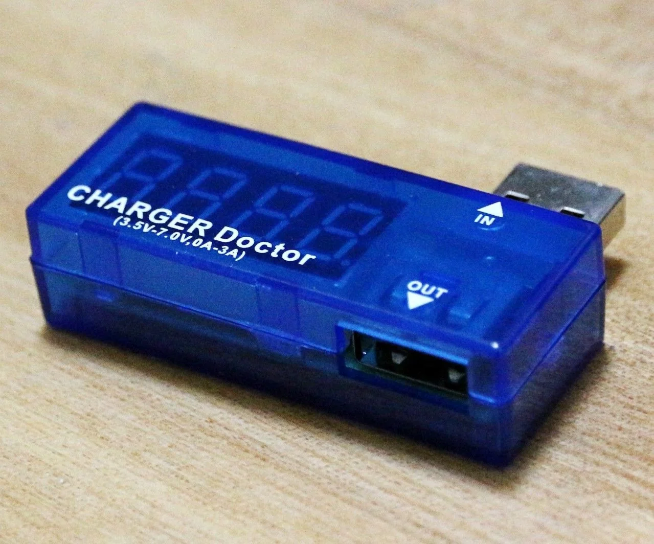

I understand, I was just wondering if it could be defective in some way and not putting out what you are expecting from it. I have a great little gadget called a Charger Doctor that I was planning to do a post about that shows the live voltage and amperage of USB ports. (with or without a load) It's been an eye opener using this thing.
