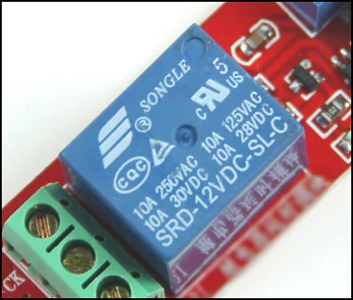

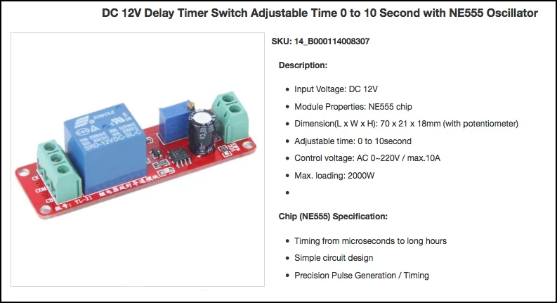

So, I posted the DIY circuit diagram that will do this back in post #203 but perhaps the readily available (and inexpensive) switch below would do the job? (available on eBay) (USA vendor)

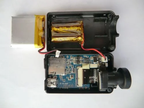

Today I remembered I'd intended to take a photo or two, but forgot to do so! Removed Mobius from car, unscrewed case again & took photo below. Note how small the capacitor is by comparison with the old battery. Battery weighs 10g. Too late to weigh the capacitor now it's stuck to the case bottom, however, it's lighter than the battery.
It's early days, but so far so good. I'm happy that the LiPo battery's gone, even though it gave me no trouble. Come the scorching English summer (max 93deg F last year), I'll leave Mobius in the car while parked in the sunshine.
