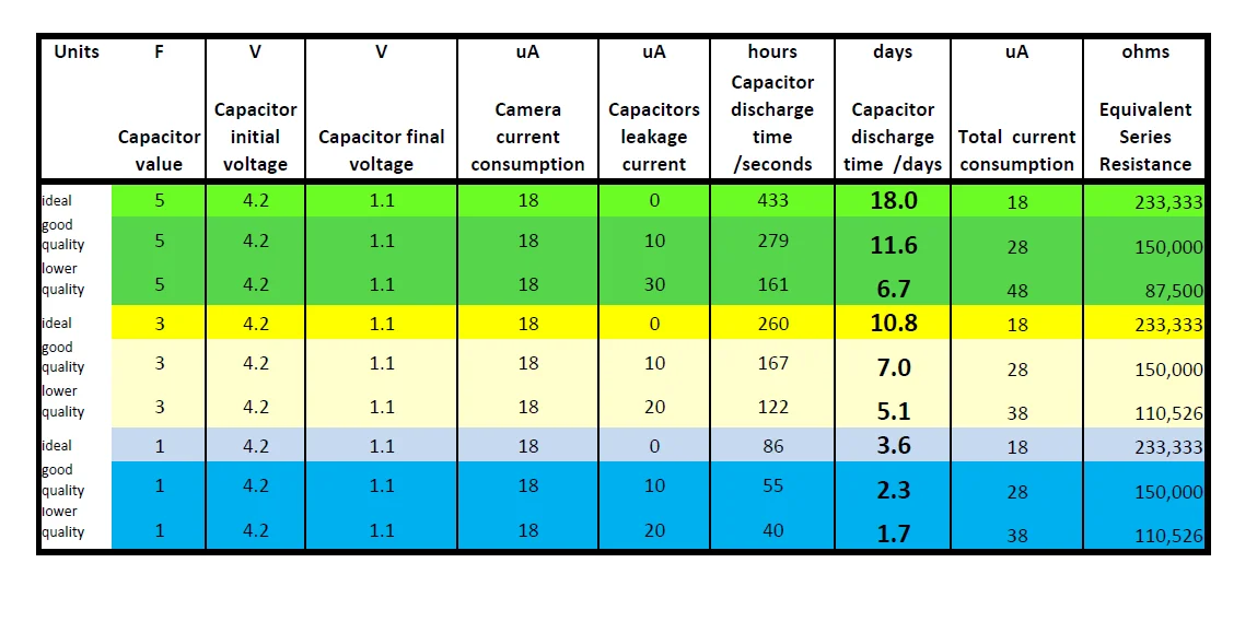

About discharge times of a capacitor connected to MOBIUS dash cam.
Firstly
The low power real-time clock (RTC) minimum voltage level = 1.1 V (it’s not as I had initially assumed that to be around 3V-3.3V). This will give more room to keep the clock up and running on capacitor power supply modified cameras.
Secondly
Based on the test I have done, using various capacitor size, using various capacitors type, for the measured 18-19 micro amps camera power consumption, in the ideal conditions ( this means : capacitor leakage current = zero), using a 5F/5.5V capacitor (two 10F/2.7V series capacitors) we may expect for a total duration up to 18 days. Lowering the capacitance, up to the limit, we get smaller time duration, as for example a 3F/5.5V capacitor may produce a maximum duration of 10 days and using a 1F/5.5V we may expect up to 3-4 days.
However, there’s no such thing as the ideal capacitor, therefore the leakage capacitors current will decrease the total time duration. Based on examples of the capacitors technical datasheet, the expected leakage current value is situated in the 10 micro amps up to 50 micro amps range.(greater the capacity, greater the leakage current , and some good quality capacitors have lower leakage current)
Optimistic time estimate provided in the attached chart
Using a 5F/5.5V -> 7 days up to 14 days
Using a 3F/5.5V -> 5 days up to 10 days
