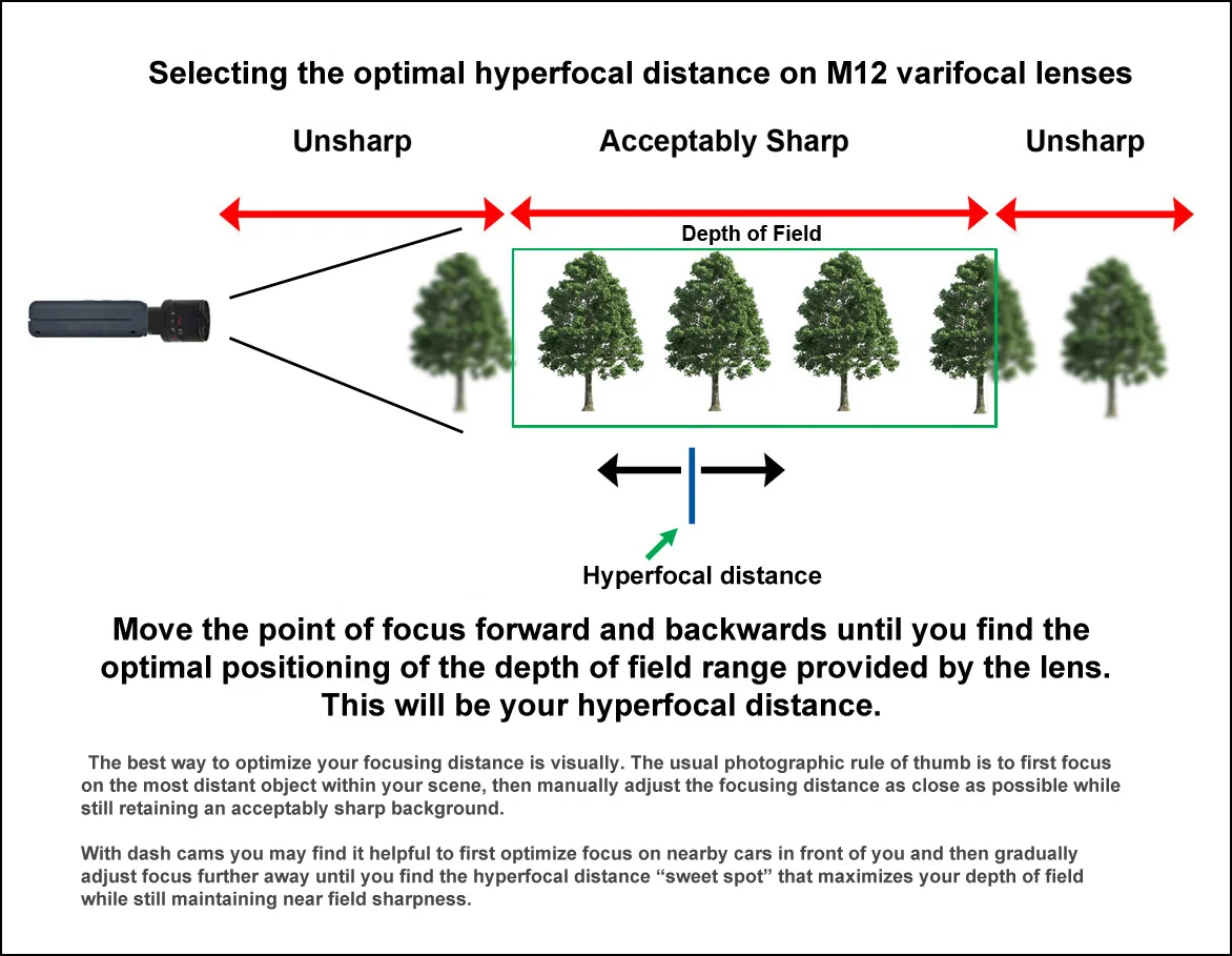

I think it looks OK but I can see where you might want to "tweak" the focus to be more optimal for how you use the camera. For example, if you wish to have farther away objects more in focus such as cars ahead of you in traffic you could move the optimal point of focus slightly farther away from where the lens is set now. The C2 lens is excellent but like most dash cam lenses it doesn't have the deep depth of field that some other lenses might. Each lens has what is called the hyperfocal distance. This is the point of focus that provides the optimal depth of field for your lens and your use of that lens. The depth of field is the range the lens can focus on simultaneously from the nearest object to the farthest object. The idea is to move that range closer or farther to meet your requirements.
Here is a graphic I made which I previously posted to another thread that may help you. The graphic refers to a variable focus lens from the thread Mobius 5MP Varifocal Zoom 6-22mm ƒ/1.6 but the concept is exactly the same for focusing any dash cam lens including fixed focus M12 lenses like the C2.
FYI: The resolution has no effect on the focus of the lens.
Here is a graphic I made which I previously posted to another thread that may help you. The graphic refers to a variable focus lens from the thread Mobius 5MP Varifocal Zoom 6-22mm ƒ/1.6 but the concept is exactly the same for focusing any dash cam lens.

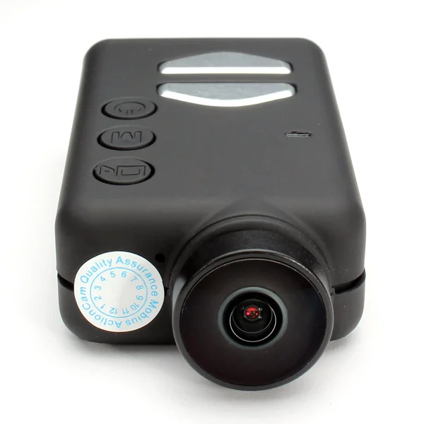

You mentioned you may have a Mobius 2 camera and we need to clarify if that is the case.
I think it's a Mobius 2 with a "C" lens

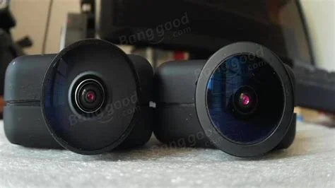

Just to be clear which camera you have, does it look like this one below? This a Mobius 1 camera with a C2 lens.
Or does your camera look like this one? This is a Mobius 2 camera.
Note the difference in the appearance of these two lenses. The C2 lens is on the left and the original "C" lens is on the right.
