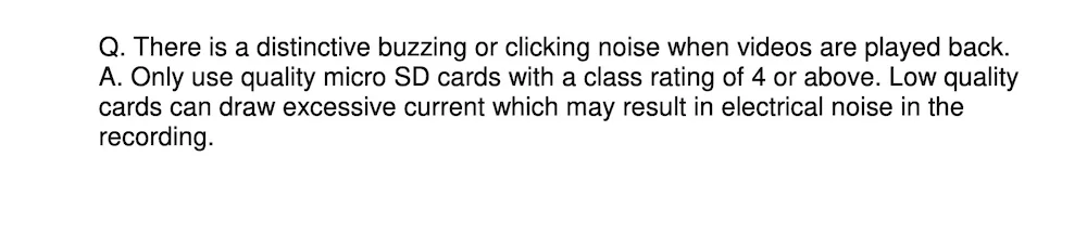

From my experience, noises, especially a pulsating buzzing always has to do with the camera not receiving enough voltage and or current. This can be from a long cable run, a weak battery or a poor power supply. For example, I've had this happen occasionally using a power bank with a very long cable run, but with my 12V adapter the problem goes away. Often, the problem is specifically related to which brand of MicroSD card you are using. Try a different brand card and see what happens.
Here is a clipping from the troubleshooting section of the Mobius User's Manual.

Well thanks for the pointer.... the card has obviously developed a fault, swapped for another known working card with the original capacitor and power supply most recently used and I would say it back to how it always was!
The card in question was bought with the camera it in 2015 a Kingston 32GB SDHC class 4. Tried with a much new Samsung 64GB SDXC from another dash cam.

Yeah, I was going to add that an aging memory card can also draw more current than when it was new. Technically, I don't know why that is but I've had it happen with one of my Mobi. There would be a soft pulsating buzz when used with a power bank on a long cable run, but there would be no buzzing when I plugged it back into my vehicle's 12V power supply that put out more amperage than the power bank. Come to think of it the memory card was also an old Kingston 32GB.
