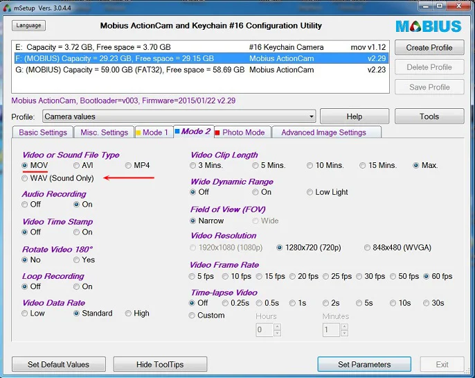

Requesting Assistance - My mobius appears to only be recording audio and no video. Is there a setting or something that I need to change? I did recently have issues with the red light staying solid vs flashing and the camera wasn't recording. I updated v2.37 and reset my settings, just now only recording audio and no video. Any assistance would be appreciated!!
Is there a chance you set the camera to record .WAV (sound only)? It should be set to .MOV.
Also, are the Amber LED and the rear Red LED slowly flashing after you start up the camera. If not, what are you seeing?
Ok - I set all parameters to default and now ALL is working fine! Then I changed the settings I wanted again and no issues. Thanks very much for your quick reply and assistance. When in doubt, start from scratch is the lesson here. I've had this cam for quite a long time and it's been awesome.
