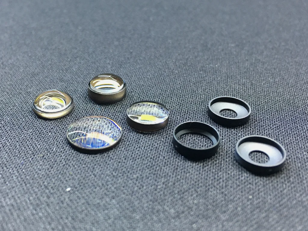

Brute force didn't help either, resulted in accidentally unscrewing the top ring that holds everything in place and the elements fell out. Here's what they look like.
