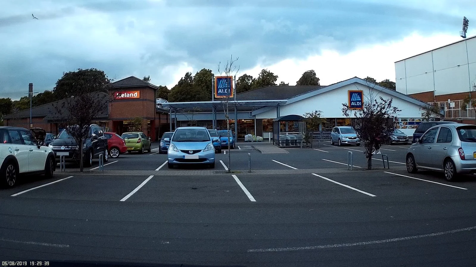

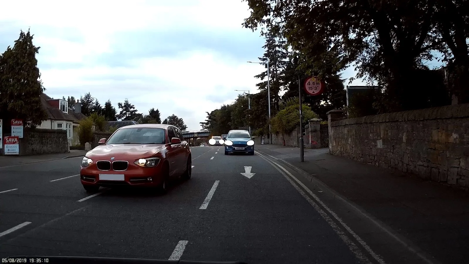

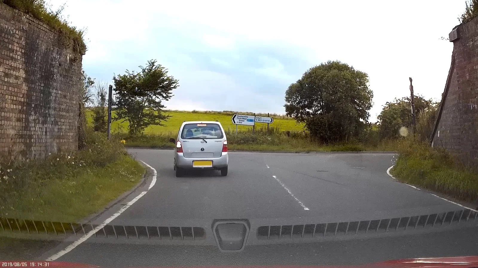

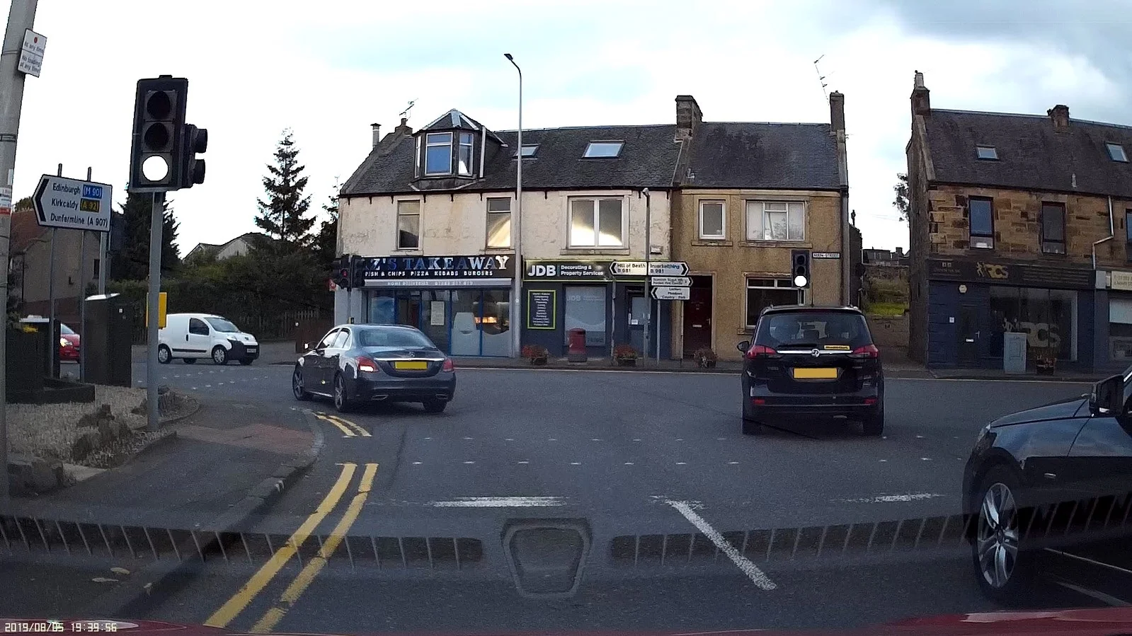

I finally had time to try out my front and rear cameras fitted with the 3MP F1.2 4mm lenses, they are set to Lens C with a narrow field of view which I find looks to have the least fish eye distorsion.
For this alone they are a massive improvement over the stock mobius lens.
The next job is a polerizing filter for the front camera those reflections are very distracting.
Do the the images look OK to you guy's regarding clarity/focus/brightness/contrast.

I think you have done a good job with focus front & back. I also used Lens C colour profile with this lens. Even with the 'narrow' FOV it's good that you have a tiny bit of the front of the car visible in the front camera.
