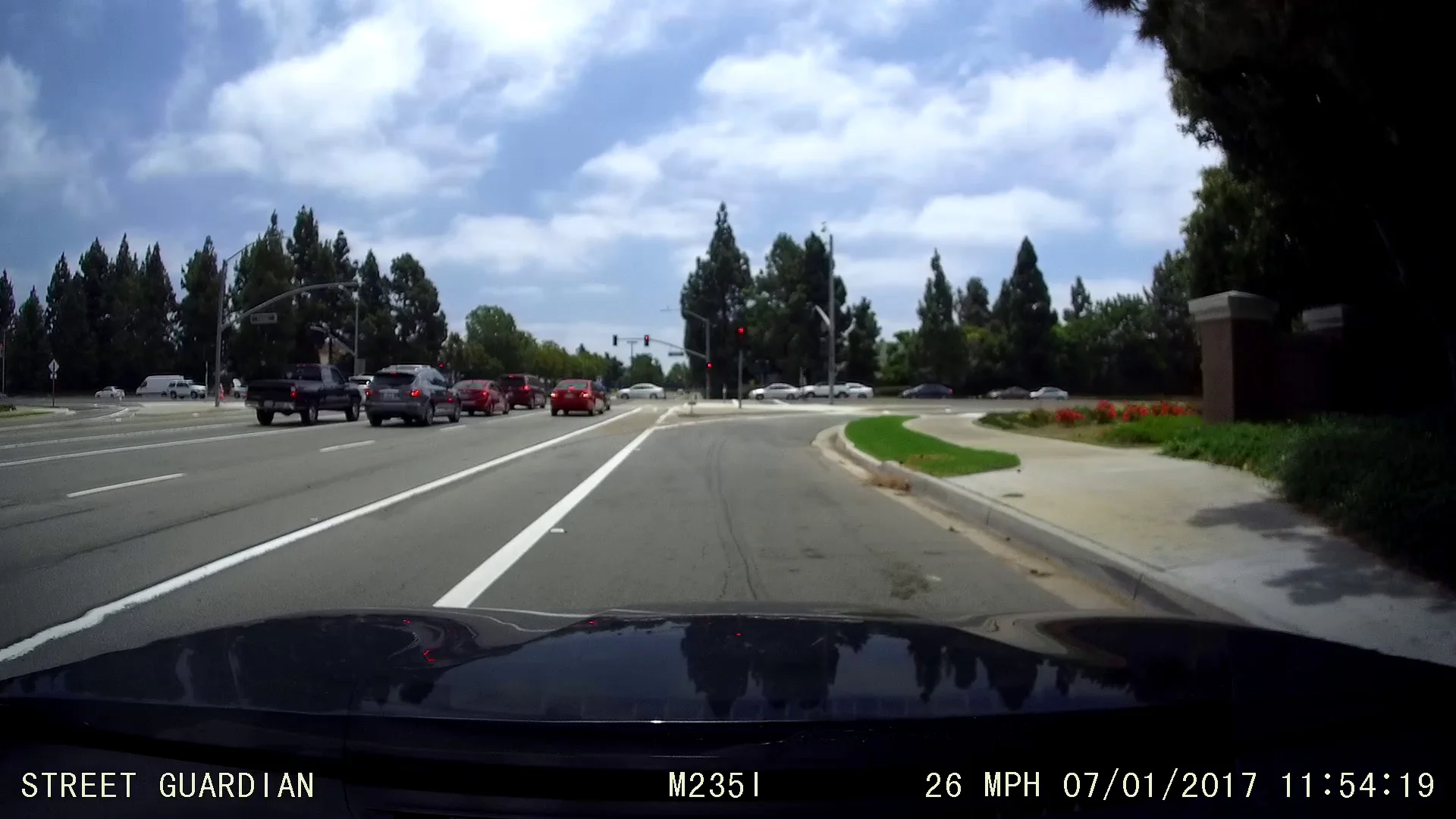

I just checked the video on my new V3 and the focus is bad when the camera heats up. My 3 year old Mobius in the rear has a better image.

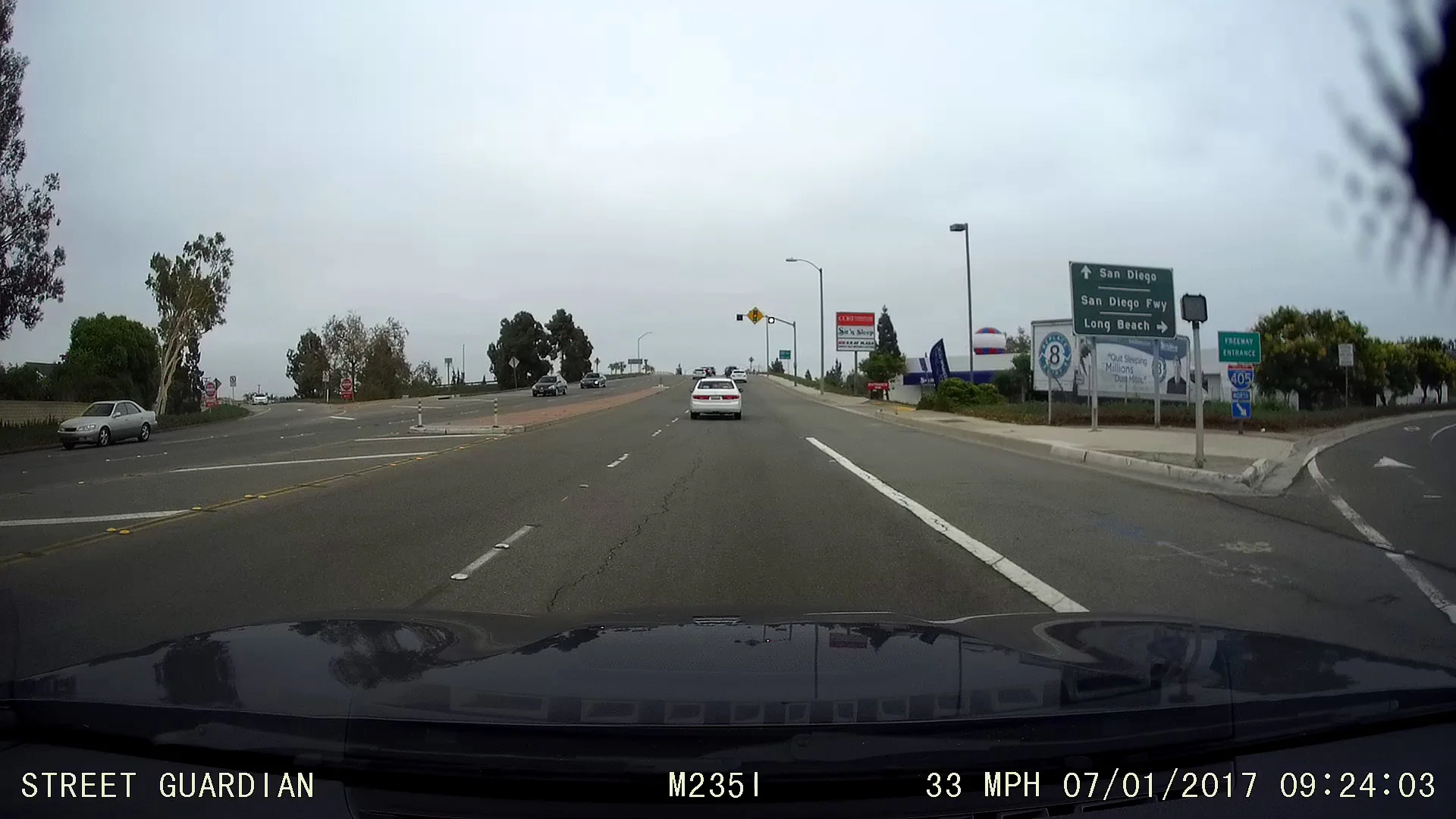

The focus quality on the V3 is okay when it is cold but after it heats up in the sun the focus goes out. This week has not even been a hot week with temps only in the 70's and low 80's F. I don't want to just exchange at Amazon if there is a manufacturing issue that prevents the focus from holding when it heats up. What do you say @Street Guardian USA ? Is mine defective or will all of them get fuzzy in the heat? It will get much hotter here as we get further into the summer. Should I swap out via Amazon or do you want to arrange to swap it out? I'm in the USA, CA. Purchased 6/28/17 direct from Street Guardian at Amazon SC9665GC V3 2017 Ed.
First picture V3 screen capture when cold. 2nd Pic is V3 after being parked in sun a couple of hours. 3rd pic is today after being parked in sun about 30 minutes and in A/C car for 30 minutes driving.

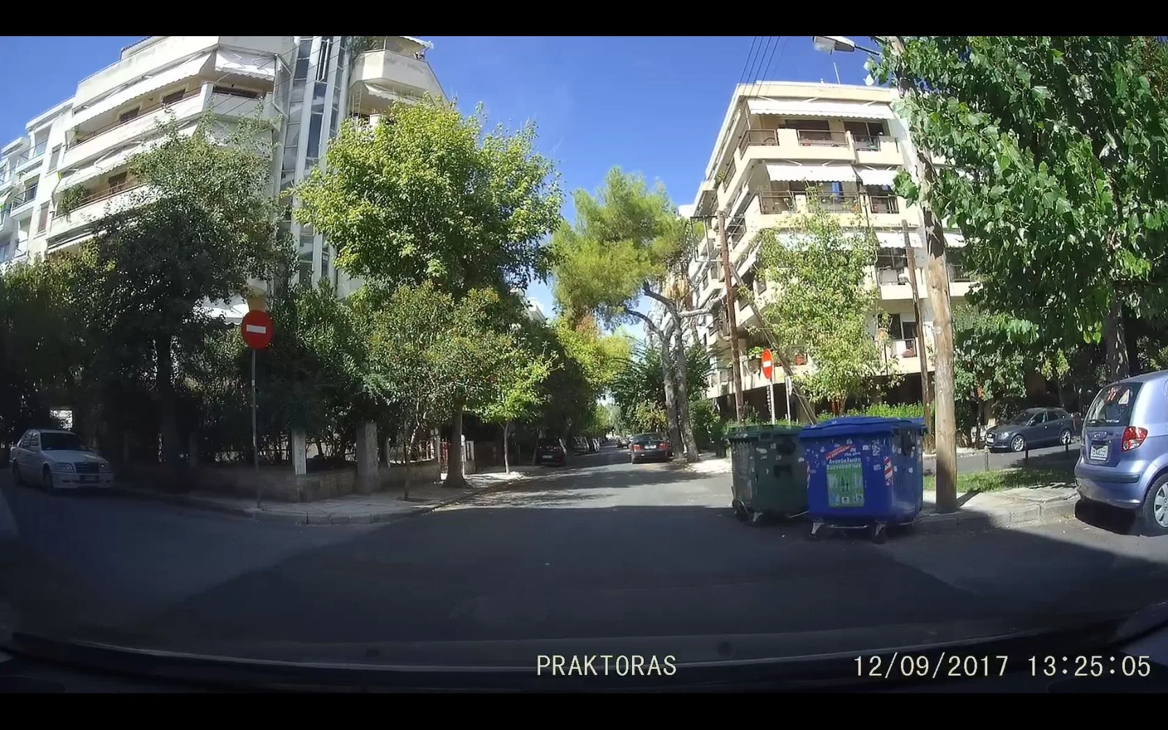

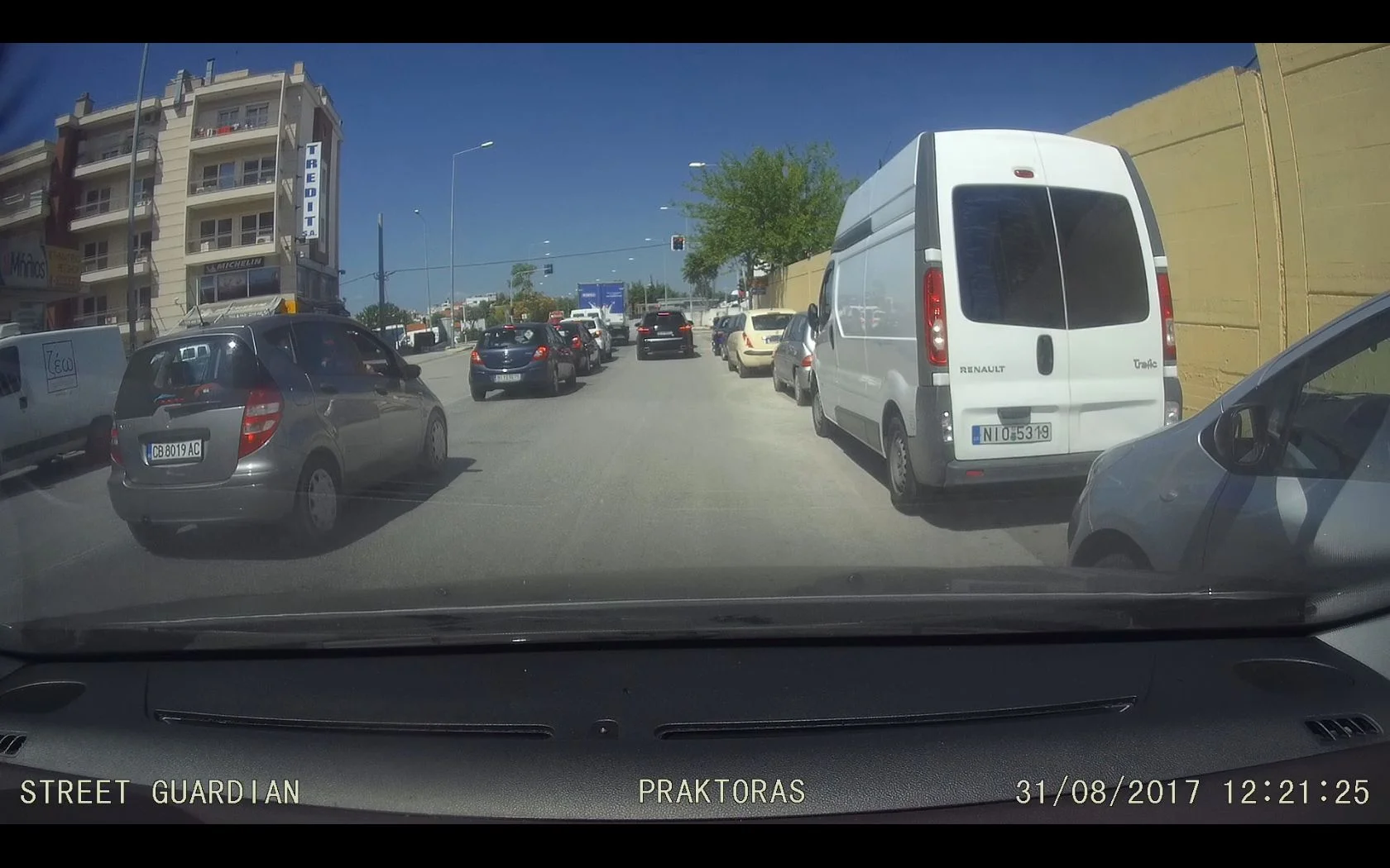

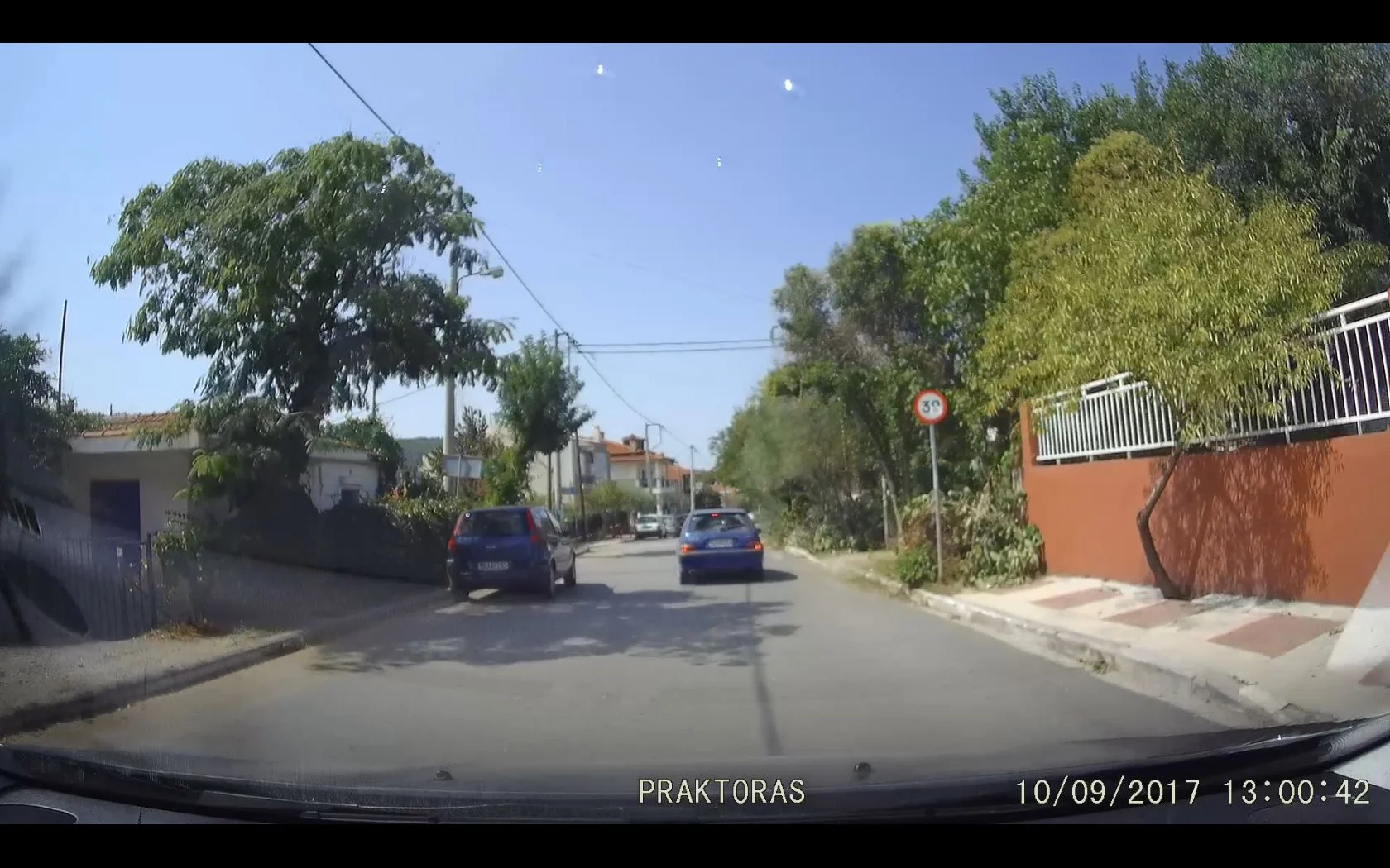

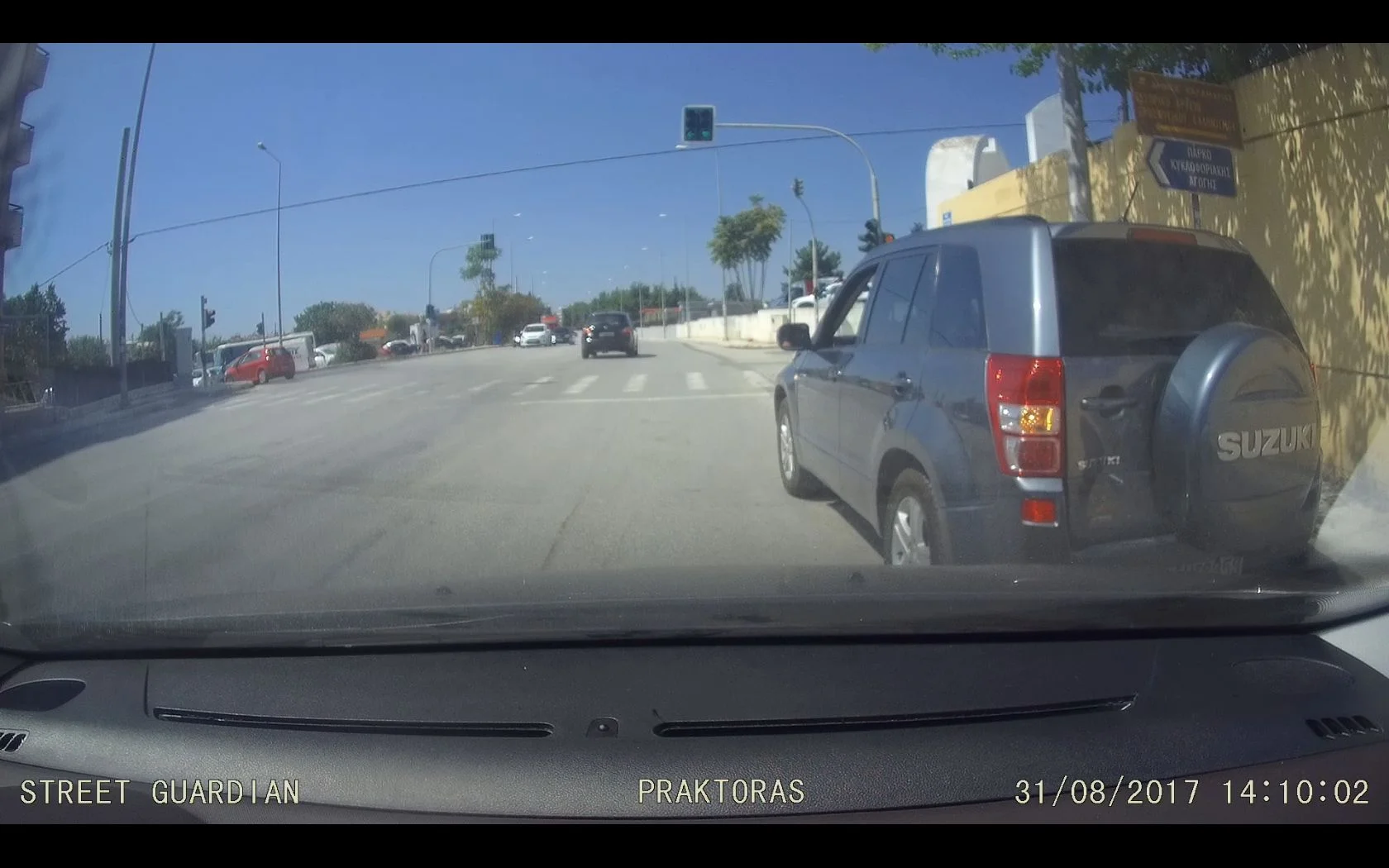

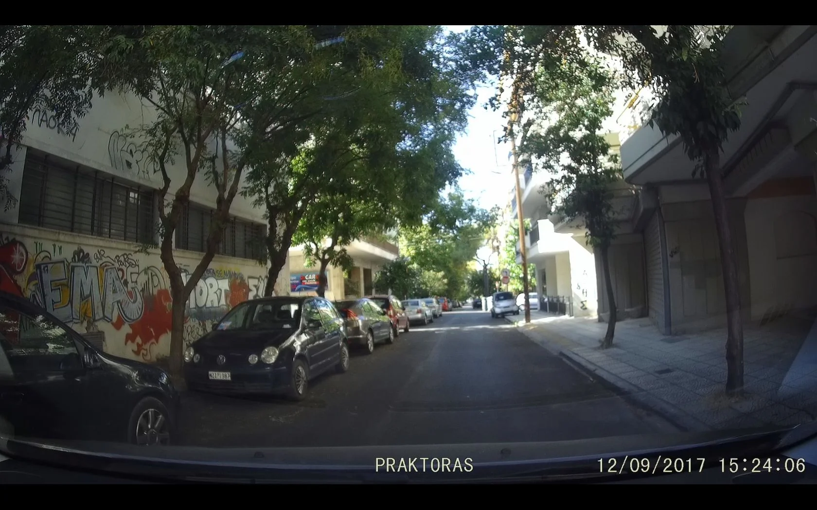

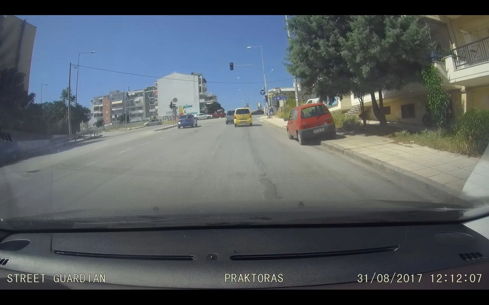

Niko is not aware of this, just found out, as I search in deeper and deeper within my videos; it seems that the blur on video was there from the start, just getting worse with the use (+heat from the Greek sun) and when the cam cooled down, it was better but not 100% there. You see, this is my first cam and my experience very low.
This is the first ever capture from the very first 3 min clip, all seems nice;

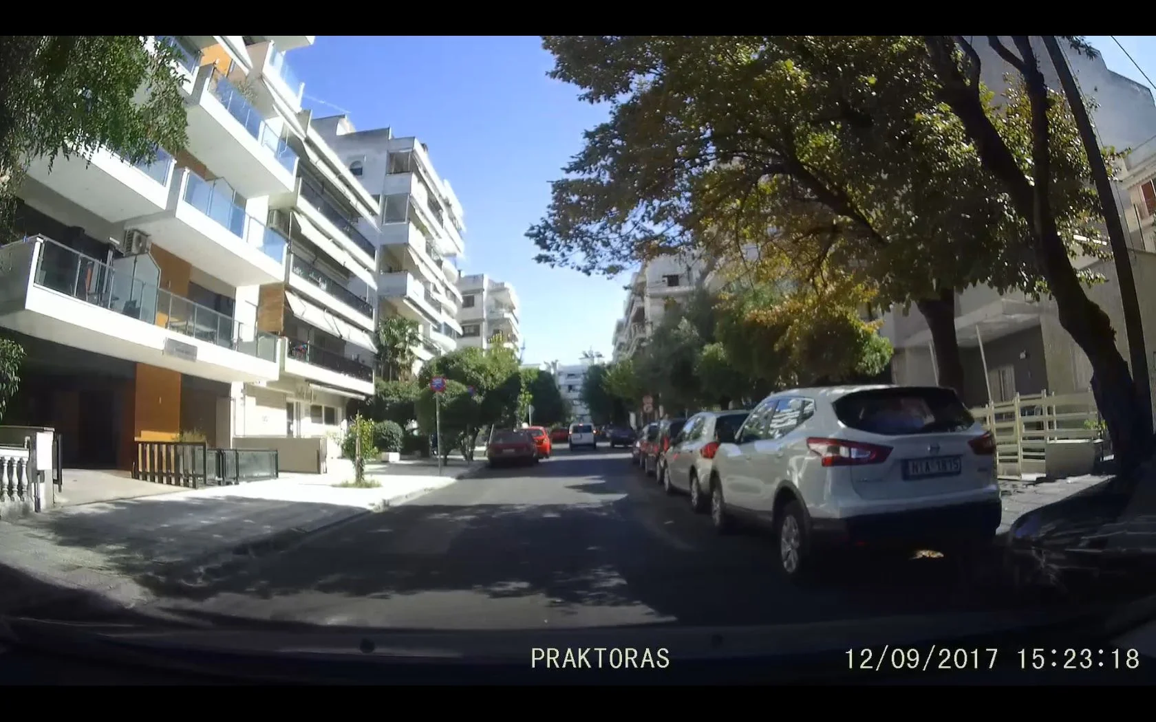

Few minutes later, and driving towards the strong morning Greek sun, it seemed ok;
Here as well, at 95%;
Until...catastrophy! πŸ˜€

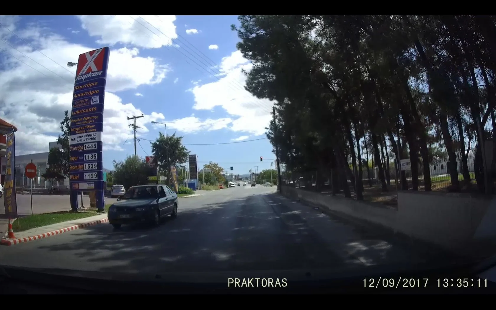

11 days after that and with the cam cool enough, took a 20 min ride.
Screenshot was taken with car still, reaching my destination. All was kinda well;
And then, after 2 hours with the cam shut down while on the wind shield at 30 degrees Celsius, this happened;

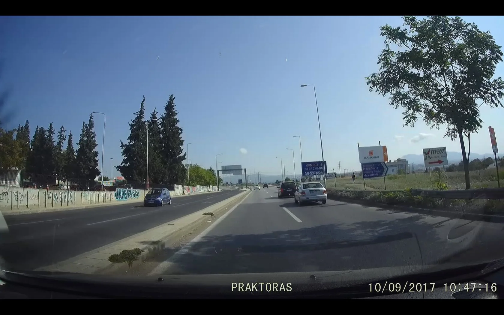

2.5 hours later, with the cam cooled down, image was a lot better but not as sharp as I would expect in the middle of the frame, but maybe I am wrong? ;
2 days later, took another drive, screenshot with cam just started recording, still not 100% at the centre of the frame, at least to my eyes;

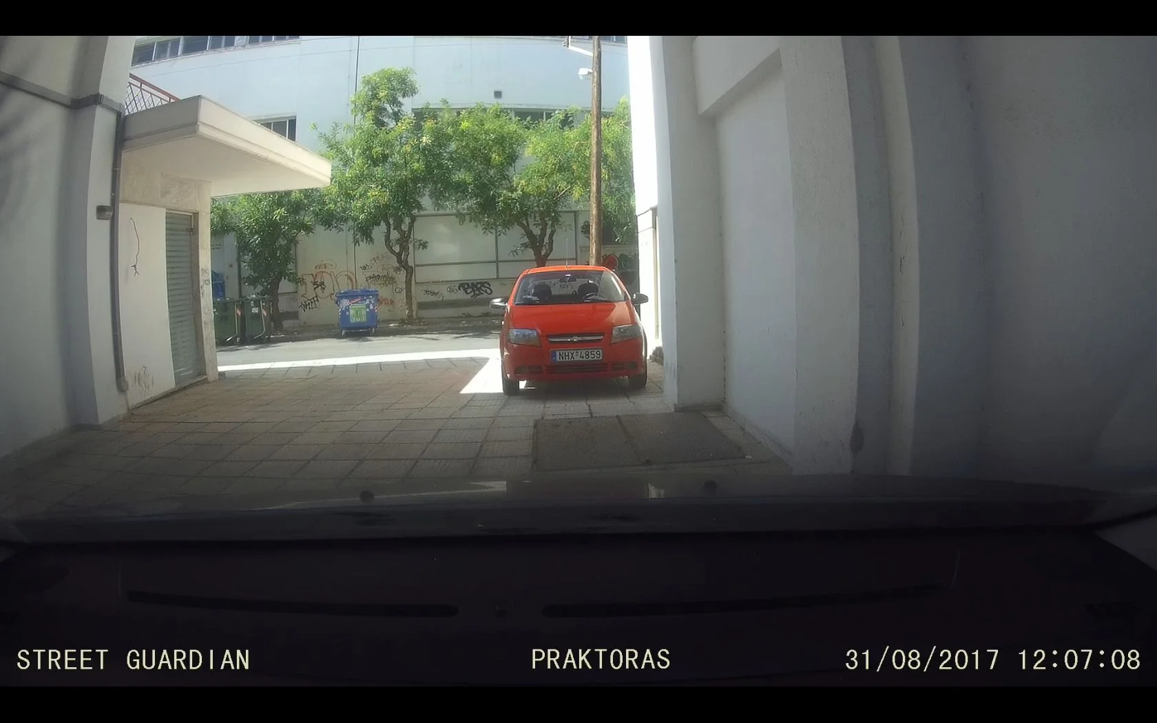

10 mins later, again blurred/out of focus;
Clearly shown here;

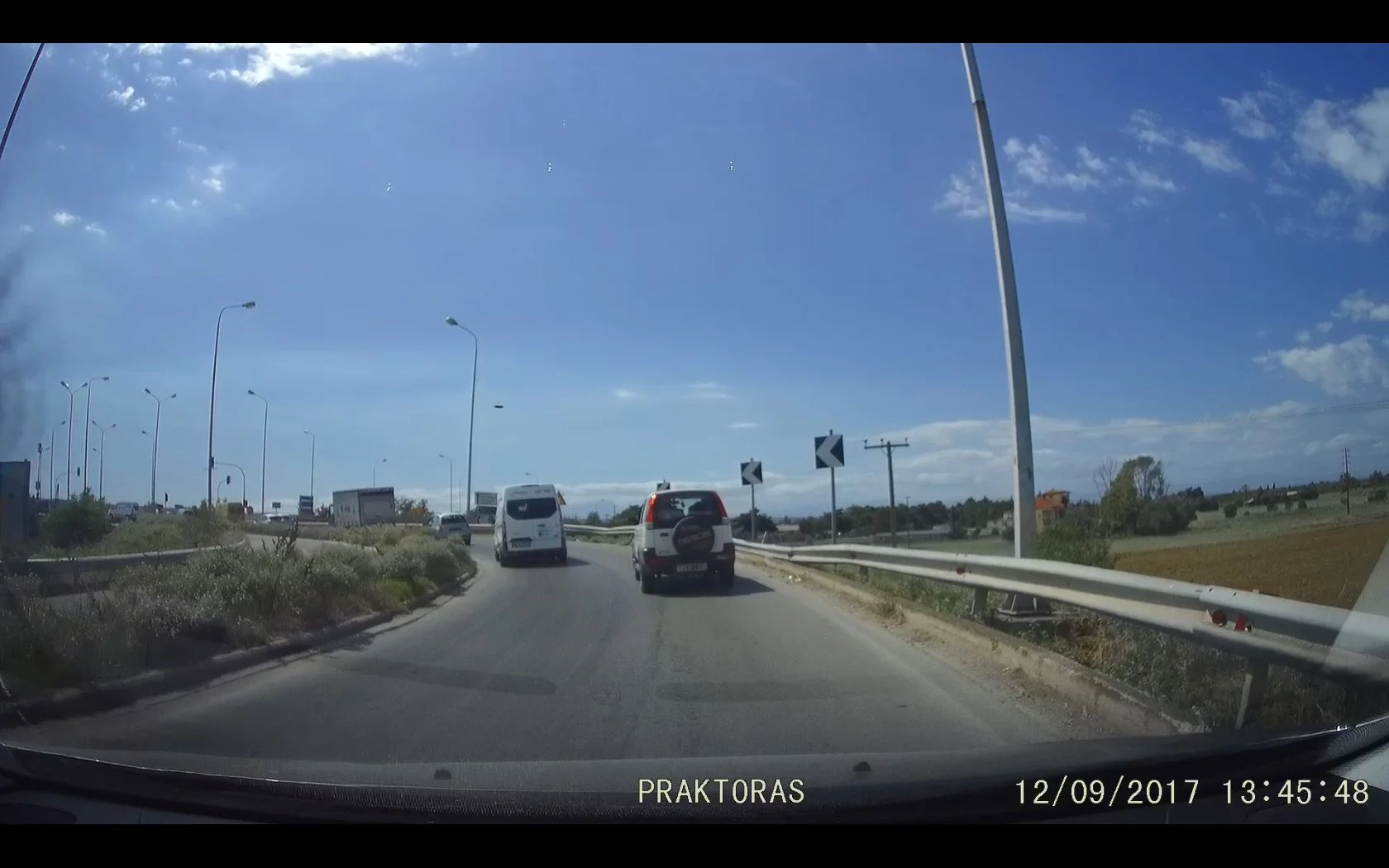

While car was parked at any time under a fat shade, driving around in traffic and heat, made it worse;
This is the last screenshot when I came back;
This is the last screenshot I took yesterday, before starting packing it for it to go back to Niko for further tests and tear down to find the reason behind this;
