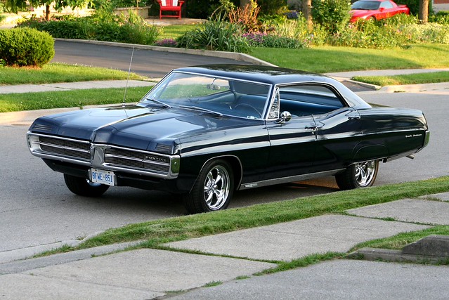

Here's a more "Traditional" dash view..
1967 Grande Parisienne. Ex USSR Ottawa embassy car.
Not originally meant to be muscle, but it's getting there...

OT But i love Us and Canada all the old cars is much cheaper there.
Thanks for the nice comments on the car, but please stop or I'll get another negative rating!

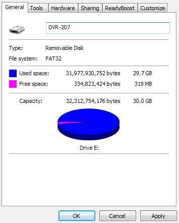

Edit: Nope, have now found that the disk is FULL and that's what probably stopped it turning on:
I thought this thing was supposed to overwrite old files automatically?

Nope, there is no such menu setting. It's supposed to happen automatically.
There should be something there related to file size or recording length or similar, not sure what its named but all car dvr's have some option for this
Sure, you can set fps, resolution, duration of each clip.
