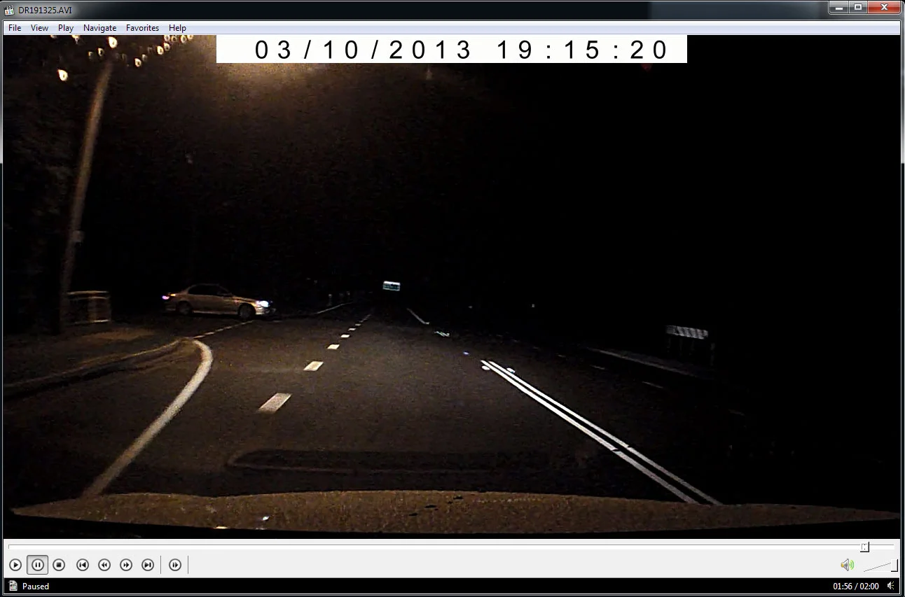

Compare this to an area with streetlights

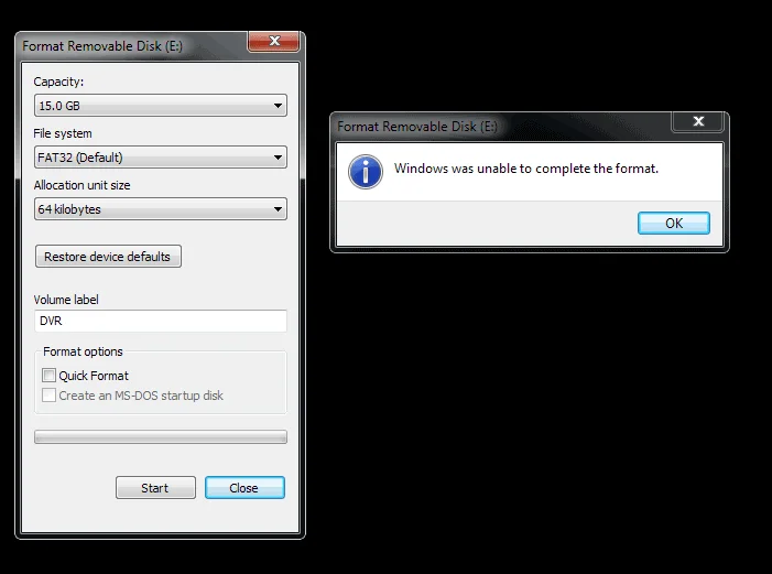

I am now fully formatting aforementioned 32GB card in camera, but using my computer to do it. The camera only does a quick format.
Bad news :x
I came back to the formatting process to find it had failed, and now the SD card is unreadable, unformattable, and shows 0 bytes. :shock:
I hope it has not been ruined by this camera.
Perhaps foolishly, I tried another brand of SD disk, a 16Gb one, and the same thing happened! :evil:
Is that 2 SD disks trashed?
Ok, put them in my Sony digicam and they formatted (instantly, so must be a quick format) and are usable in the digicam. Whew!
Anyhoo, I suggest you all download the formatter here, just in case
https://www.sdcard.org/downloads/formatter_3/
Now to buy a SD card reader that allows me to format the 32GB card properly for the DVR.

Panasonic offer a formatting tool also, Windows does not actually follow the proper protocol for formatting memory cards
jokiin said:
any reason why you're using 64kb allocation instead of 32kb?
I think I read in another thread here that that is the correct size. Please correct me if I'm doing the wrong thing. ๐Ÿ˜ณ
Ramshackle said:
I've seen that suggested as a way to get larger cards than officially supported working, the camera formats them at 32kb so I don't really see a reason to do otherwise

Bottom line:
  • If you format the card in the DVR, using the DVR's "Format" option, it does a Quick Format, and this may or may not work for you. It did not work for me on the abovementioned new 32Gb card, because the problems with shutdowns began thereafter.
  • If you format the card in the DVR, using Windows, it usually fails on larger cards. It worked for me on a 512MB card, but failed on 16Gb and 32Gb cards, making them unusable until reformatted in a Sony digicam.
  • Old, slow cards can work fine, and there is no need for an ultrafast card.
I now think an expert formatter, like the one linked above, should be used with a proper card reader, via Windows.
I will be able to prove that this is right or wrong when I get my card reader and reformat the 32Gb card, and re-try it.
