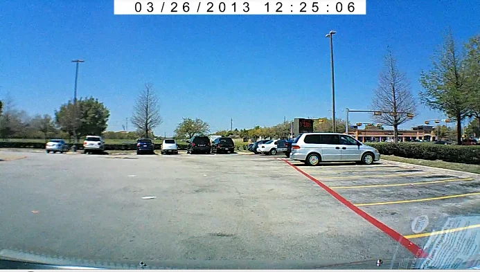

Once I got back to work, I found the f500LHD has much better video quality than the DVR207.
If you look at the lower left corner, the image is very soft.
You're comparing apples to oranges. The F500LHD is Full HD 1080p and the DVR207 is HD 720p (forget about the 1440x1080p mode as it's Interpolated). The DVR207 has half the resolution of the F500LHD, and is probably half the price.
The blurriness in the image could be from the lens not being mounted correctly. I have seen other photos showing the lens unit not sitting flush with the CMOS sensor, it can be corrected by carefully adjusting and re-seating it yourself.
Cheers :) Mario
