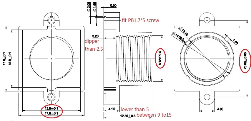

re-focus will not works for the pre-production nanoQs as there is lens base problem in the pre-production batch. the vendor provide working lens base samples but deliver the degrade ones. Our fault, we havn't done temperature cycle test again on the production cameras again. We have set the QC guide for more test now.
for the pre-production nanoQs, we have to recall them back for factory rework. We hope the users how got the pre-production batch can help on recall process. Especially the users in Australia or other areas between tropic of cancer & carpricorn, the summer will heat the camera up and focus changes.
and the M12 17*17mm lens base is not so common to find anywhere, I guess it is not easy for users to get this lens base locally.
