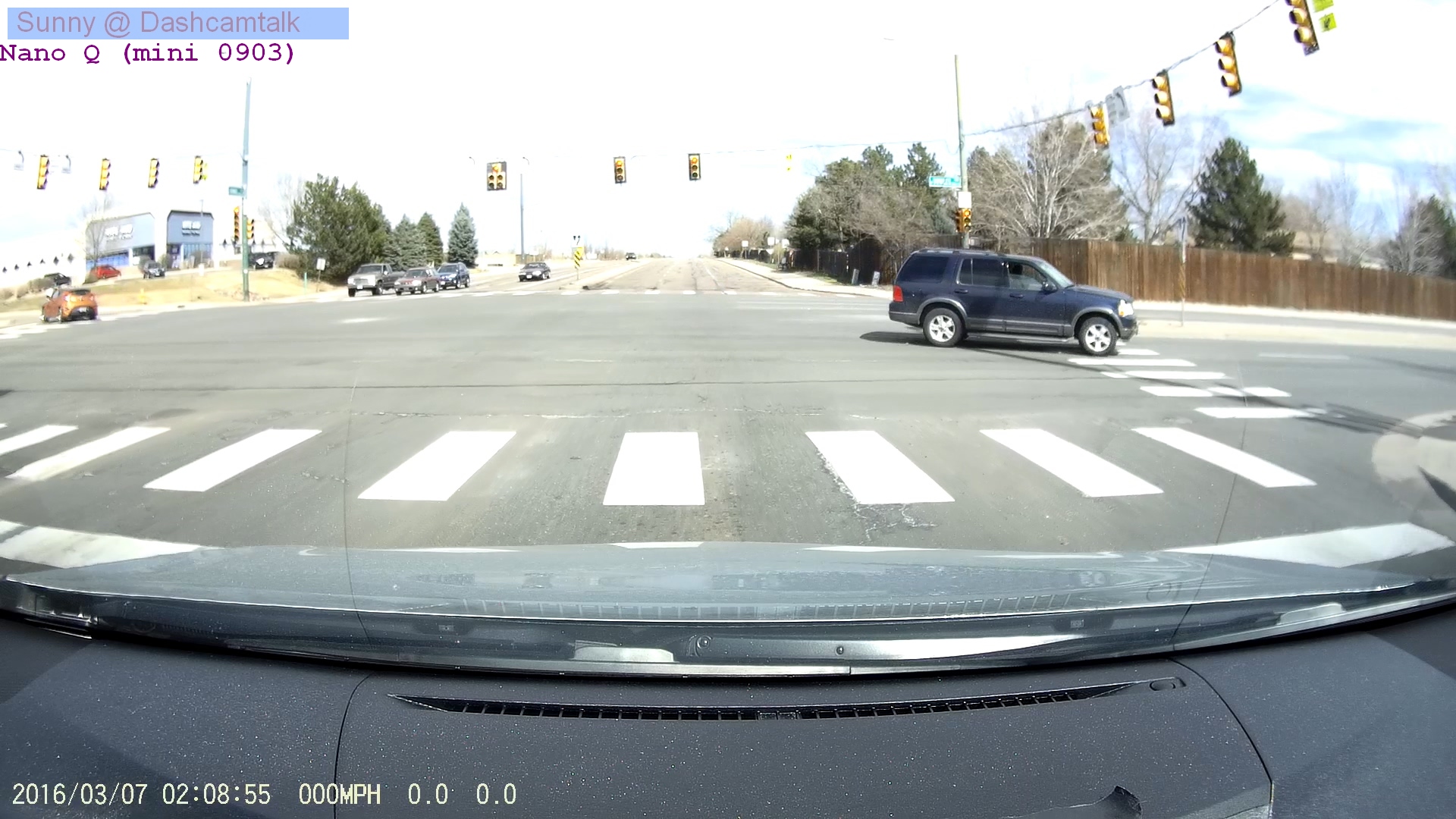

Haven't read all the posts but here are issues I found during testing:
[Note: It is a pre-production sample so obviously has few issues.]

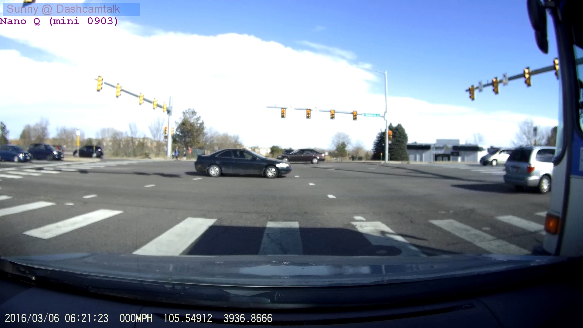

Focus is sharp only in a small center area, everywhere else, it's out of focus.
Not sure if heat makes it worse but it's pretty bad to start with.

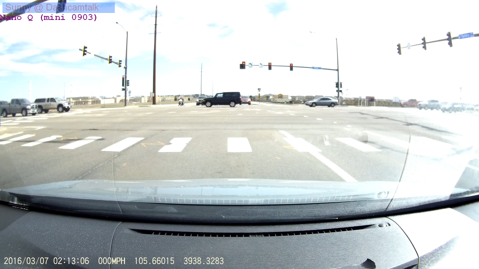

Exposure is off. It's very bright when there are white clouds or anything bright.
Purple fringing on trees.

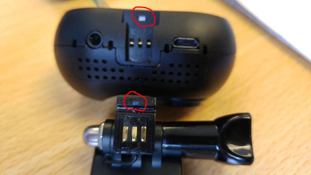

The small square plastic clip to lock the mount into the camera is too small.
Extra GoPro style mount (the one without charging pins) doesn't even have that small plastic lock tab so the camera just slides out. I have multiple of those extra mounts and none of them have those tabs. It's just flat. 😱

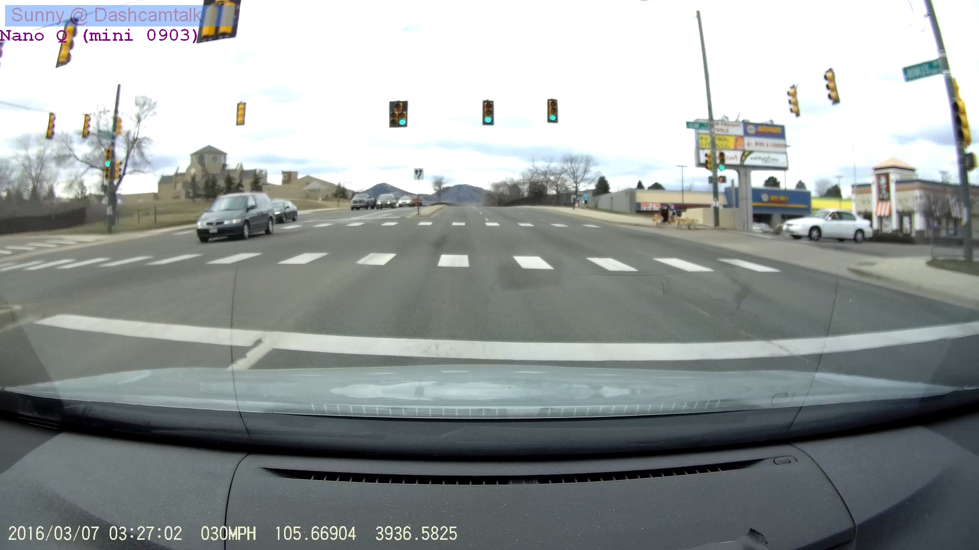

Few screenshots:
oof:
Oof way too much.
Wow that's terrible footage and as you say well out of focus and over exposed and I would expect more from a $20 cam.
OMG Out Of Focus is a common theme, I hope someone will post the re-focus procedure to help the rest of us new NANOq DIY'er so we won't have to send it back to manufacture. TIA.

Yes, it's sample and issues need to be/ should be sorted.
Wow Sunny, if the focus of your sample can't be improved, there is only one place where this cam belongs - the garbage bin 🙁

@Sunny, please use this firmware to update your nanoQ and have a try again.
the IQ in last firmware was adjusted to improve the night view but seems too much for day light.
re-focus will not works for the pre-production nanoQs as there is lens base problem in the pre-production batch. the vendor provide working lens base samples but deliver the degrade ones. Our fault, we havn't done temperature cycle test again on the production cameras again. We have set the QC guide for more test now.
for the pre-production nanoQs, we have to recall them back for factory rework. We hope the users how got the pre-production batch can help on recall process. Especially the users in Australia or other areas between tropic of cancer & carpricorn, the summer will heat the camera up and focus changes.

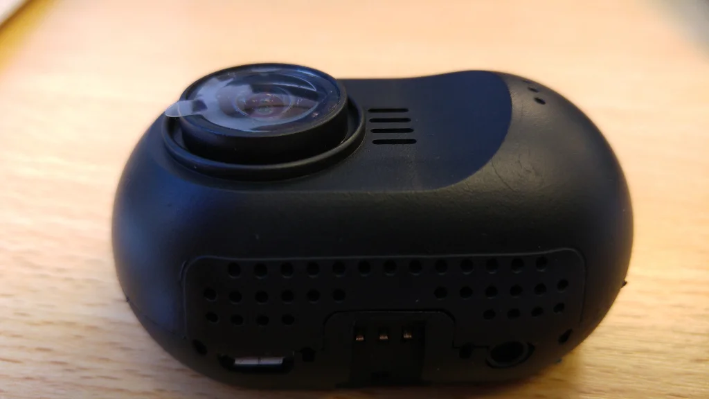

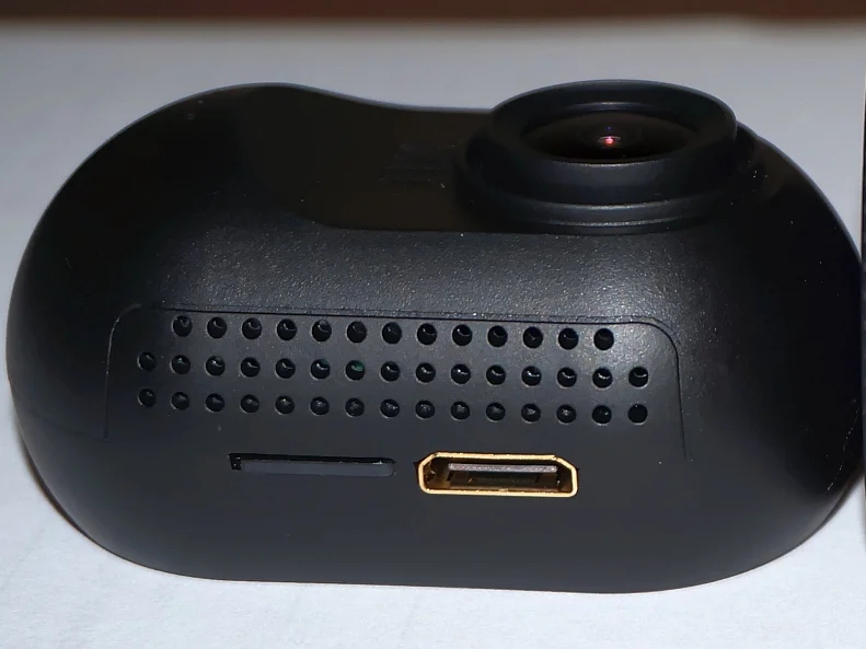

Does the camera in @Sunny 's review have a different lens? Mine looks different:
Sunny's:
Mine:
I just received mine today (it should be the latest batch according to the seller).
My lens looks like this:

The lens looks the same as mine. Maybe @Sunny had some kind of prototype? My GPS mount also doesn't "snap" but it is quite solid.

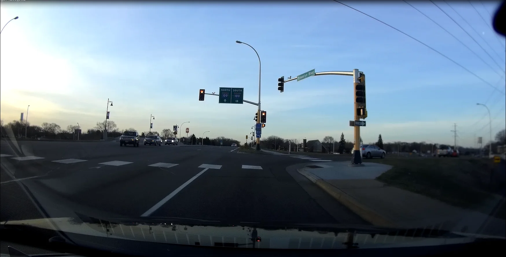

16Mbit PQ FW is looking great, but the manufacturing quality control needs to be stepped up a notch or 3.
I have a production 0903 that has a sensor housing that isn't sitting flat.
You can see the right side of the image. The only solution is to either send back the camera (china is a long ways away) or take apart the entire camera and see why its not sitting flush.
