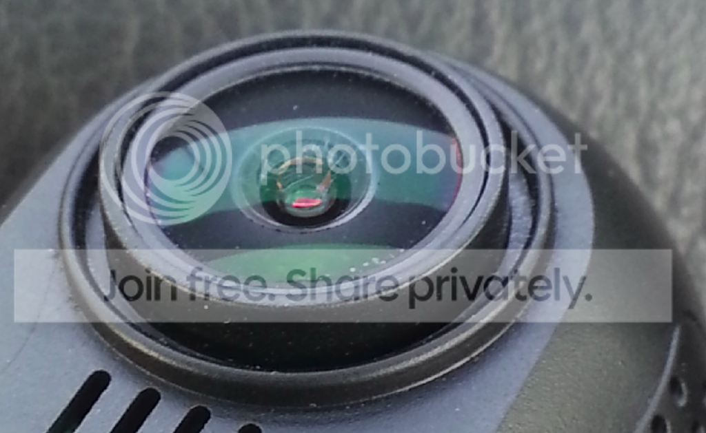

Clean the lens and your windscreen. It looks like you have grease on the windscreen so use some detergent.
Yes, upon 2nd view it seems there's some dirt/scratch at the middle of lens, which explain why light only disperse at the middle. I will try and clean it.
Seems like my lens has some scratches. Not sure if this is production issue but I didn't mistreat my nanoQ. May I know if there's any hacks to fix this?
Wow, that's some major scratches. Is it repairable?

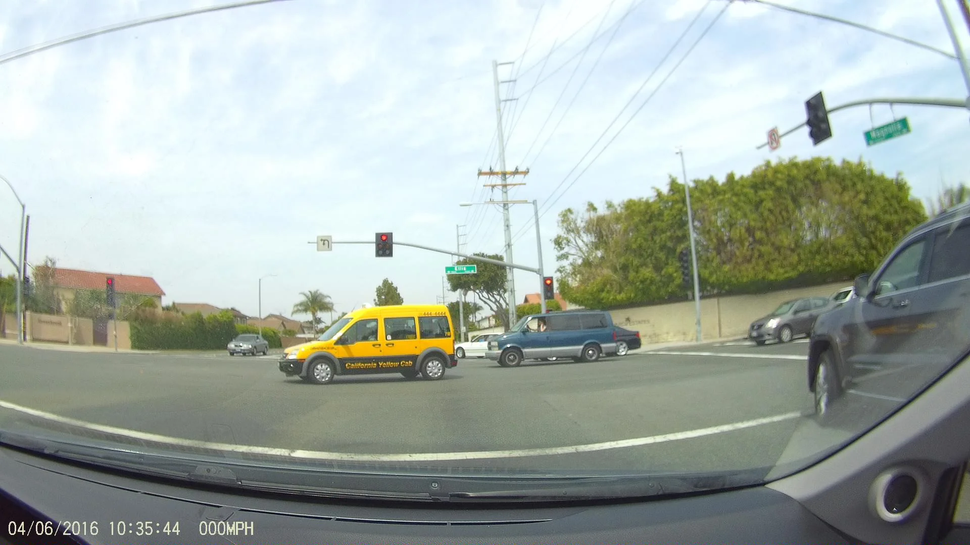

Do you guys think I have a focus issue? Here is a sample picture:
It does look like it's focused a bit too close. Were you stationary?
The latest cam i just got from diggcams was nicely in focus. I think QA is picking up a bit.
I was stopped at stop light. Other dashcam should be able to get the sign perfectly. This dashcam seems to be foscus on the dashbaord.
