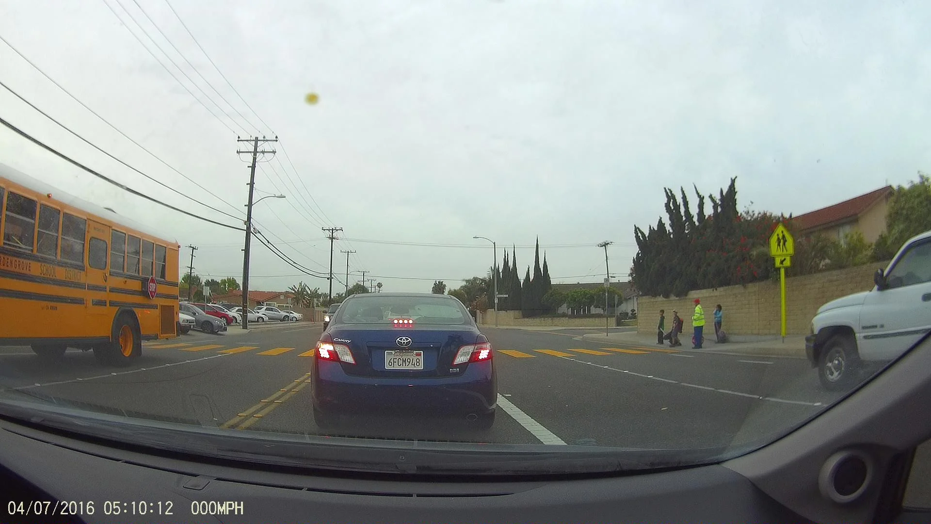

I was stopped at stop light. Other dashcam should be able to get the sign perfectly. This dashcam seems to be foscus on the dashbaord.
Right. Looks like you are in for a re-focus procedure 🙂 If you're going to do it, you should also make sure the base is flush with the circuit board.
I'm not that fond of refocusing a new equipment. Do you think this is due to plastic housing on lens or if a metal lens housing would prevented this? I could have sworn day 1 focus was acceptable. But in the sun a few days the focus seemed to have shifted.
There were some reports of substandard plastic being used for lens housing which caused focus shift. User @blake actually 3D printed his own...
Is the DashCam lens not set to Infinity ∞ focus ?
Or is it an autofocus lens setting that has been glued into a fixed focus setting at time of assembly / manufacture?

Here is another example. I think the licence plate is ok. But the signs blurriness is unacceptable. The Video is the same and still no SAT/GPS signal all 4 hr of driving. I'm sad at its performance.

Too much hassle to do a re-focus. I will likely put it up on ebay for someone who would like to tinker with it. I like the nanoQ's concept but the product failed to deliver as promised. However, This will not deter me from buying the next dashcam.

It's actually out of focus in the corners.
GPS should be there, probably stamping is off.
In the dark, it's not that noticeable. It's the day time out of focus seems more noticeable. So your nanoQ is not have GPS issue?
you can disassemble it. And easy to fix that with no problem. Conneting it with a computer as a webcam.
Not every 0903 have focus issues.

you can disassemble it. And easy to fix that with no problem. Connecting it with a computer as a webcam.
The point of a new product is that we shouldn't have to tinker with it so much. However, GPS, focus, & mount issue; it can take a toll on the end user. Luckily, my Git2 just arrive too so the nanoQ will be on the back burner. I'm hoping Rayman will bring a solution for those who are toying/tweeking with the product. I love the nanoQ. It's small and discreet. I like the fact the the night quality is almost on par as the SG's series without the $$$ price. But if I a choice to go back I would've paid $200 for the SG and not have to tinker with the nanoQ. I've made my bed, now I got to lie in it.😉
