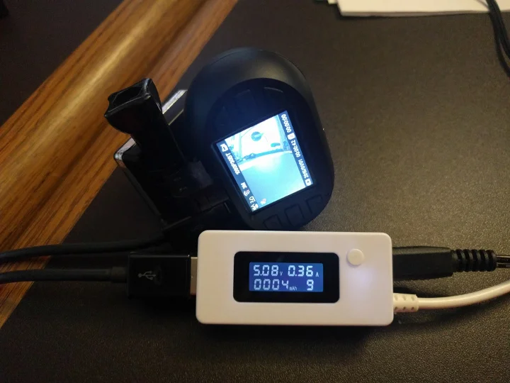

Does anybody knows about it's power consumption? I know, it's depends on bitrate, resolution, gps. But an esimated range in milliWatts (without GPS). So I'd like to calculate the expected runtime from a kind of battery
It's going to be less than 500mA. But why estimate when you can measure :)
