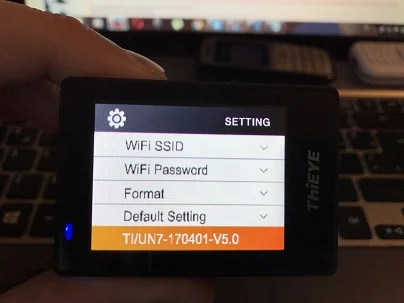

just bought new THieye t5e but its came with version TI/UN7-170401-V5.0
Why the version is different from official website

Interesting, not sure perhaps they forgot. No rep here on the forums for ThiEYE from memory, and emails i have sent them have gone unanswered.

Hi ilkyar rashid,
The update was reported, including a new microphone port, on just about just about every FaceBook site related to ThiEYE but strangely the only place one would logically search, ThiEYE Official Page has no new information.
Firmware has only just been updated as we speak.
Firmware TI/UN7-170401-V5.0 in now their Support Page - LINK HERE OR MEGA Download
Changelog:
Version:TI_UN5-170228-V5.0 NOTE: Changelog has not been updated???
NOTE: The way of upgrade has changed.
Please follow the instructions enclosed with Firmware RAR.
1.Add the language Thai
2.Optimize the deformation problem within 720P 240FPS and 200FPS resolution.
3.Solved the occasional crashes.
4.Optimize Bluetooth remote control function.
5.Solved the factory reset setting problem when the camera is turned on again.
6.Add the timelapse icon
