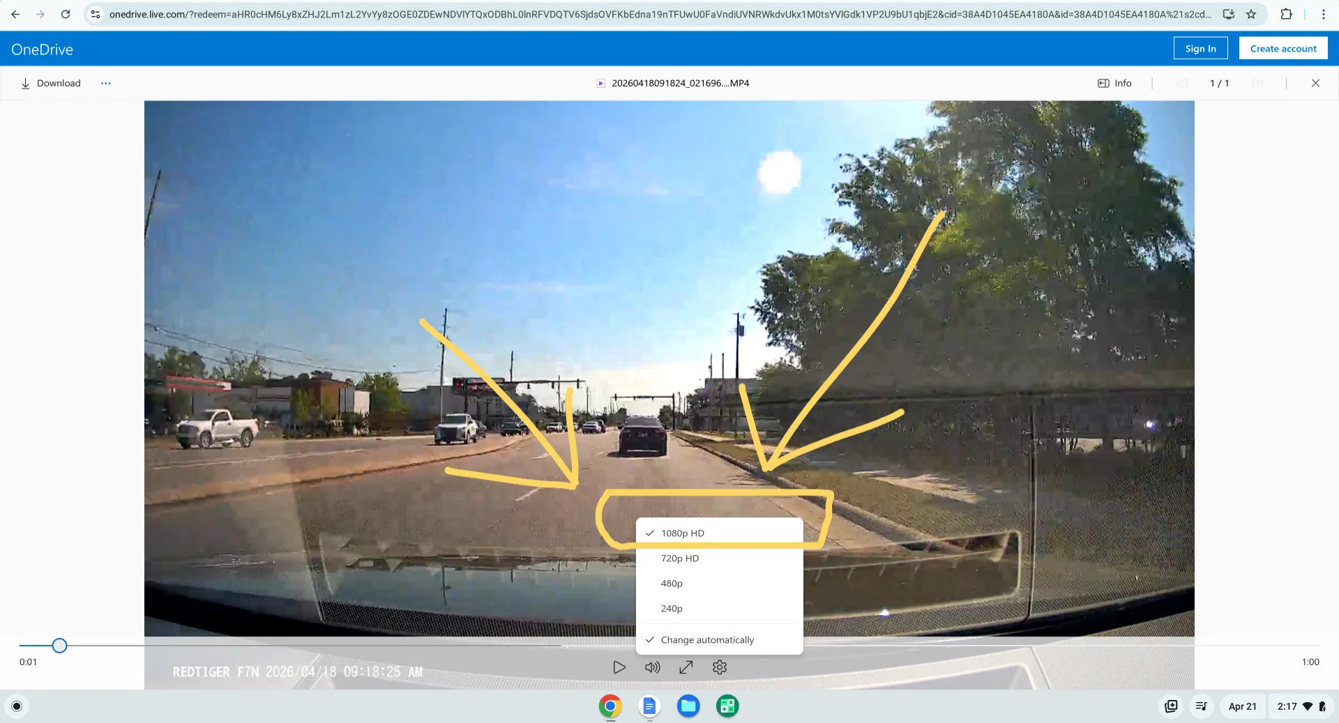

Well, I clicked on the file and it just played without any problems. I'm running Linux Mint with firefox, and it played fine in firefox.
Video played just fine on the OneDrive link via Brave browser on my android.
Same here using MS Edge on a Windows 11 OS.
Edit: Also played fine using Firefox on the same system.

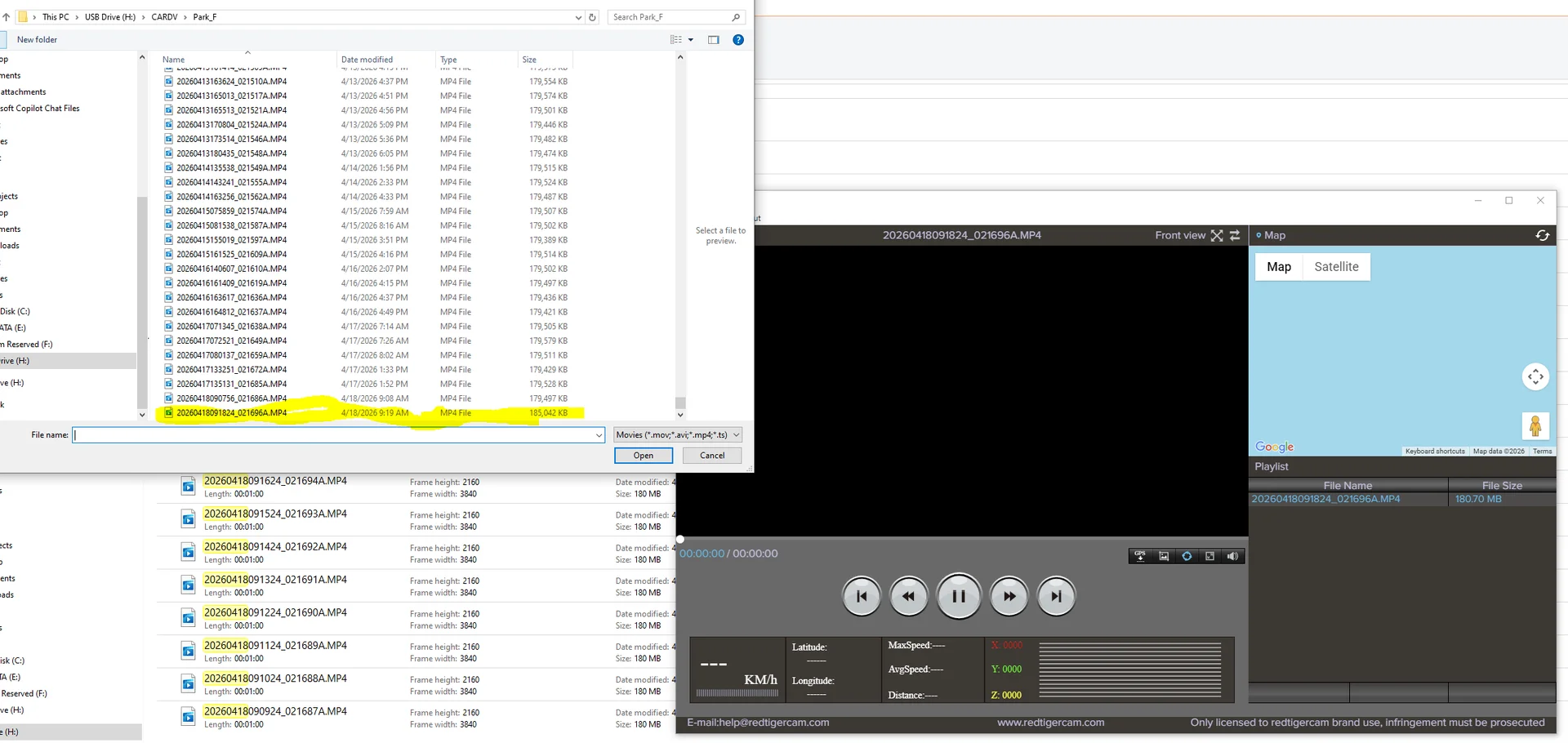

It turns out the video file was on the SD Card but your computer could not play the video.

I clicked the link, and it started playing on my Chromebook.
But the resolution was only 1080p.

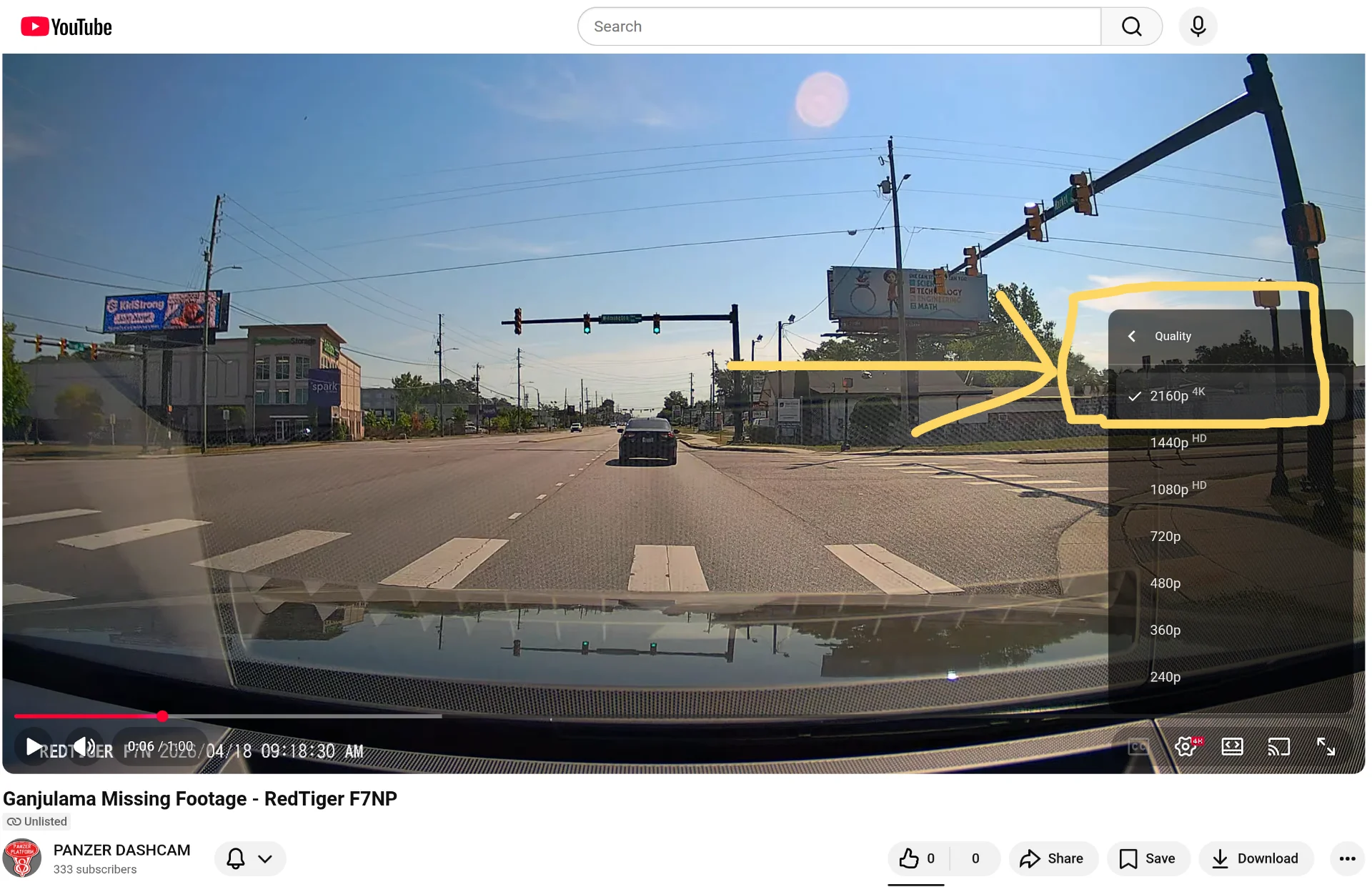

I downloaded the video file to my Chromebook.
However my Chrombook could not play the file because it's H.265, (all I get is a small black screen with audio only).
So I uploaded the video file to YouTube, and not only does it work but we get the full 4K resolution.

Based on how the camera is designed to work, footage triggered by an impact is usually saved in the Urgent/Locked folder (it may show as “Parked” when viewed on a computer). From what you described, it sounds like the file might actually be on the SD card, but not playing properly. In some cases, a sudden impact or power interruption can result in the video not being fully written or becoming corrupted.

I was able to connect to WiFi. This leads me to believe its the card. I got a PM from Elena. One thing I didn't mention was rear camera was not working at time of accident. I lost the rear view image in the camera preview that is always on a few weeks ago. I didn't have time to troubleshoot and assumed it was just recording, since enabling that view was optional on set up.
I have no way to test back camera because it was unrecoverable from the vehicle.
I did get error 'the memory card is abnormal please format or replace memory card'. However, there was no card in it. When I put SD card back the error resolved.
Does that mean the redtiger did capture the accident?
Yes, the footage of redtiger has been restored, and it was recorded at that time. At least the front camera has been restored; our customer service will continue to follow up with Ganjulama to resolve his issues.😊
