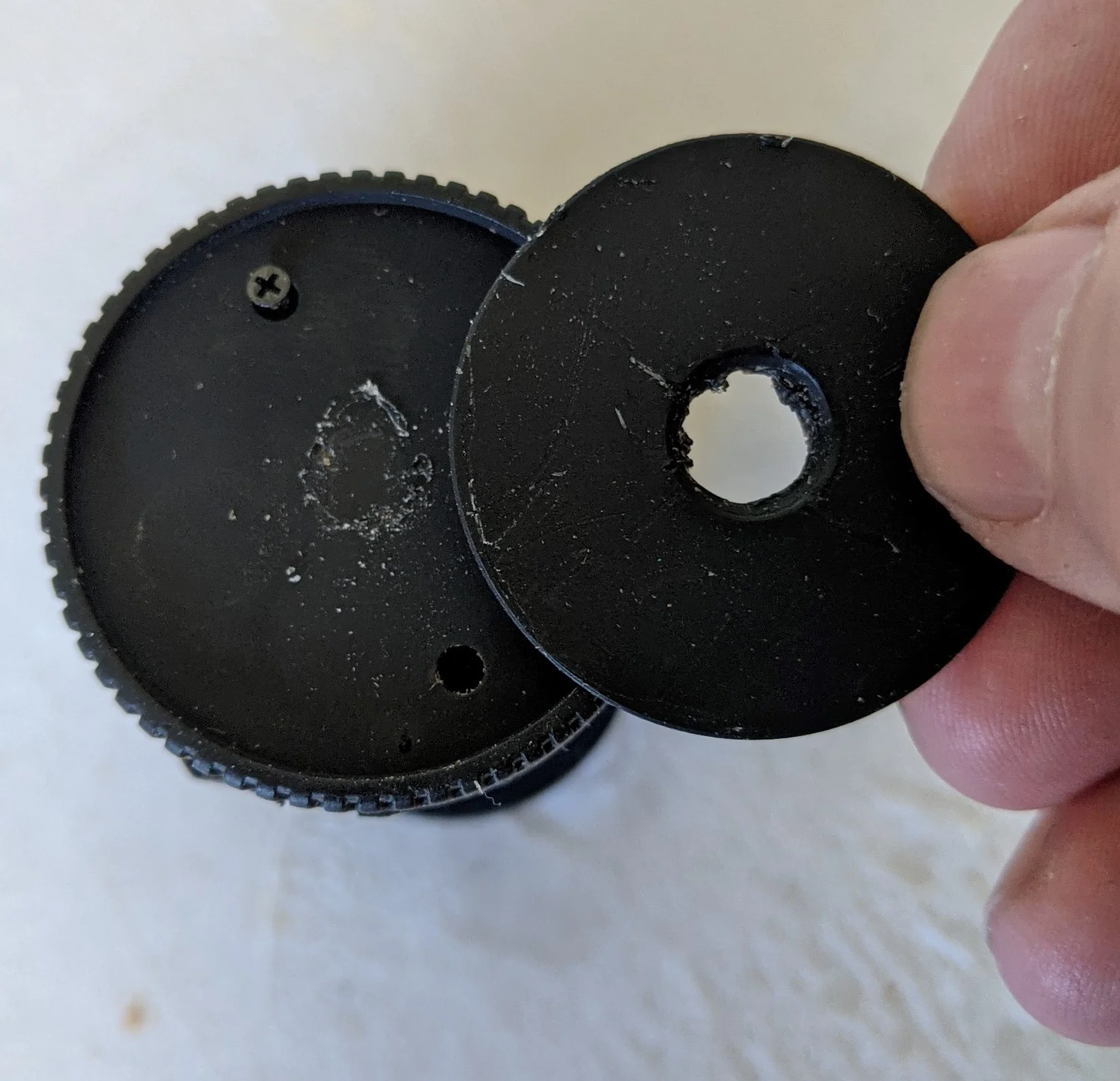

Ok got it worked out - caused a little damage though - the end caps are not initially removed as they screwed in so cannot be prised off like in the above video of the 0806. The end caps are two piece have a cover plate that has to be removed first.
You then gain access to two screws that allows the end cap to be removed.

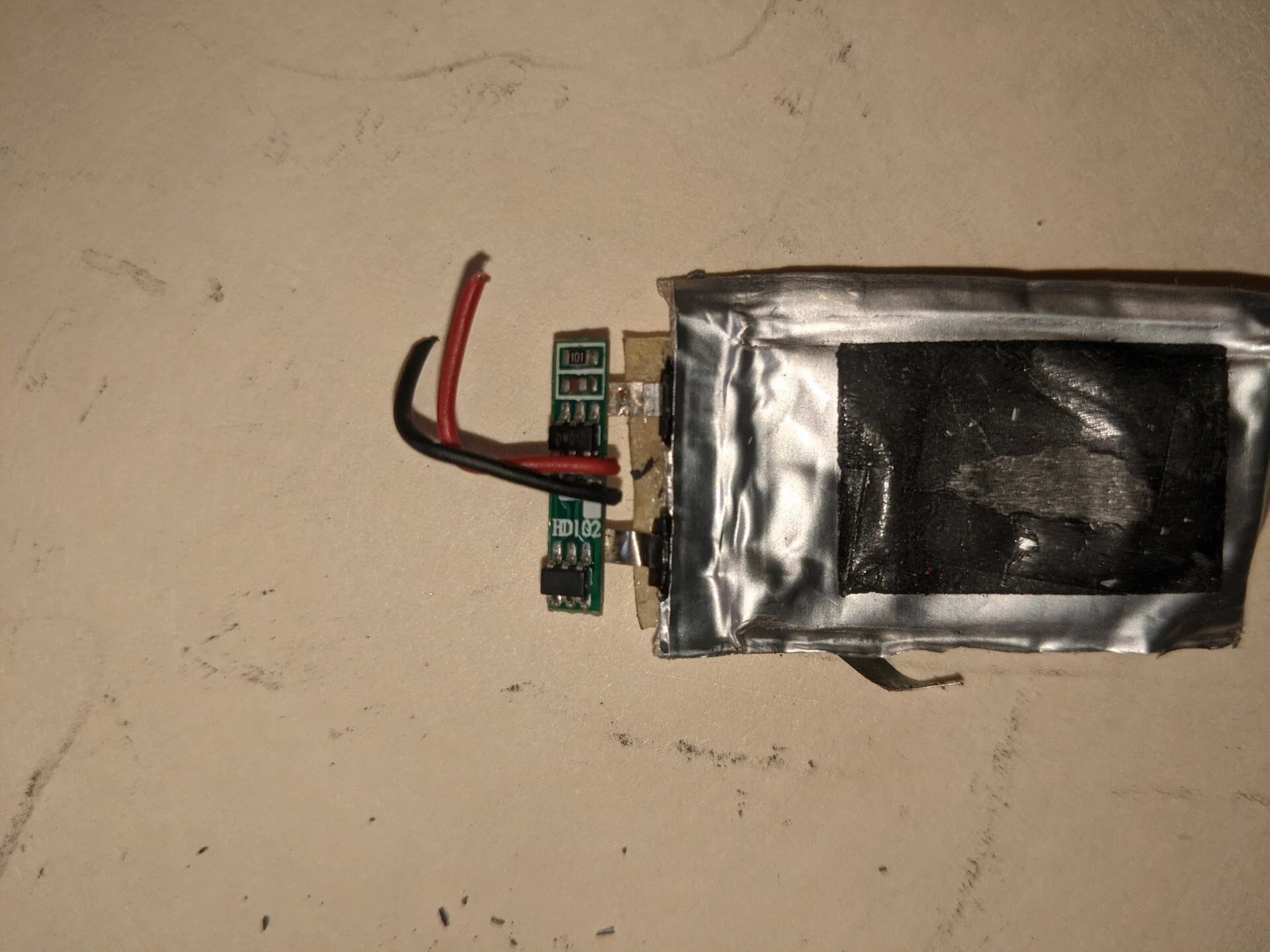

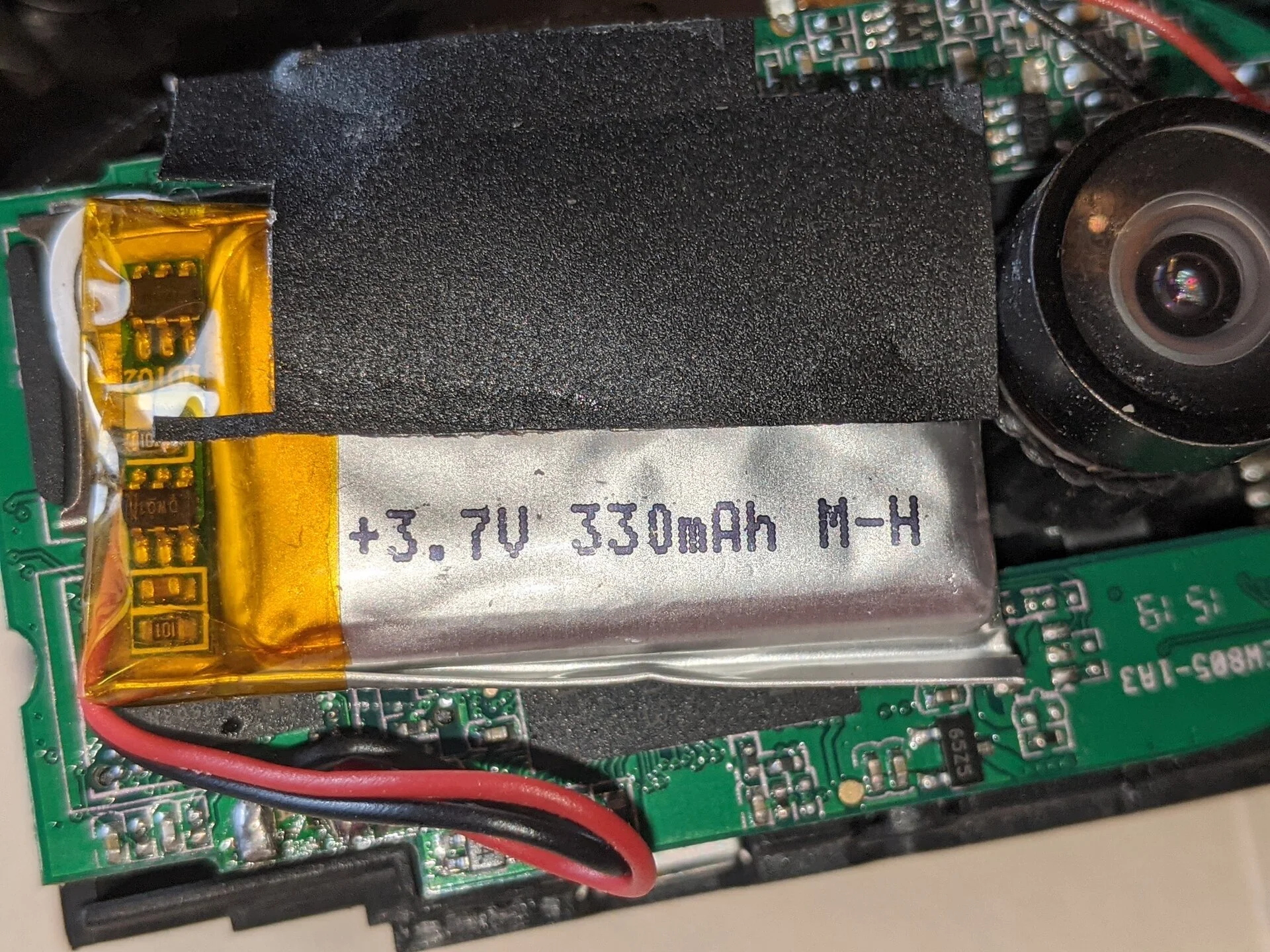

Ok - pulled the unit apart - this is the battery
I was expecting the descriptor to be Li - ion but it has M-H so is the battery a Metal Hydride?
Also has this little circuit board - I guess it is the controller - looking at battery pics online it looks as if it is actually part of the battery - is that correct? If I go ahead, I am thinking of actually putting the battery outside the unit, velcroed to the underside of the unit with a plug and socket.
