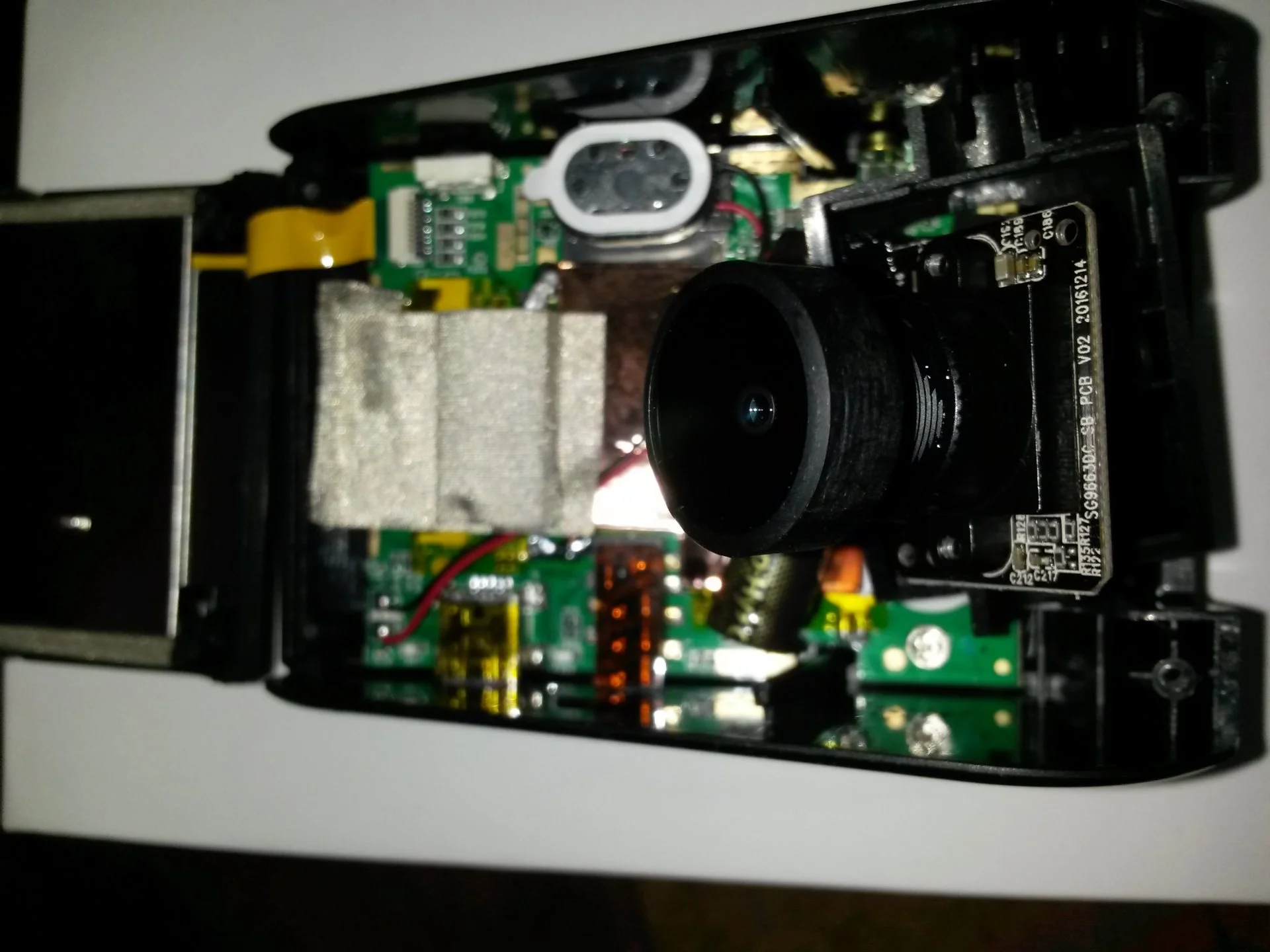

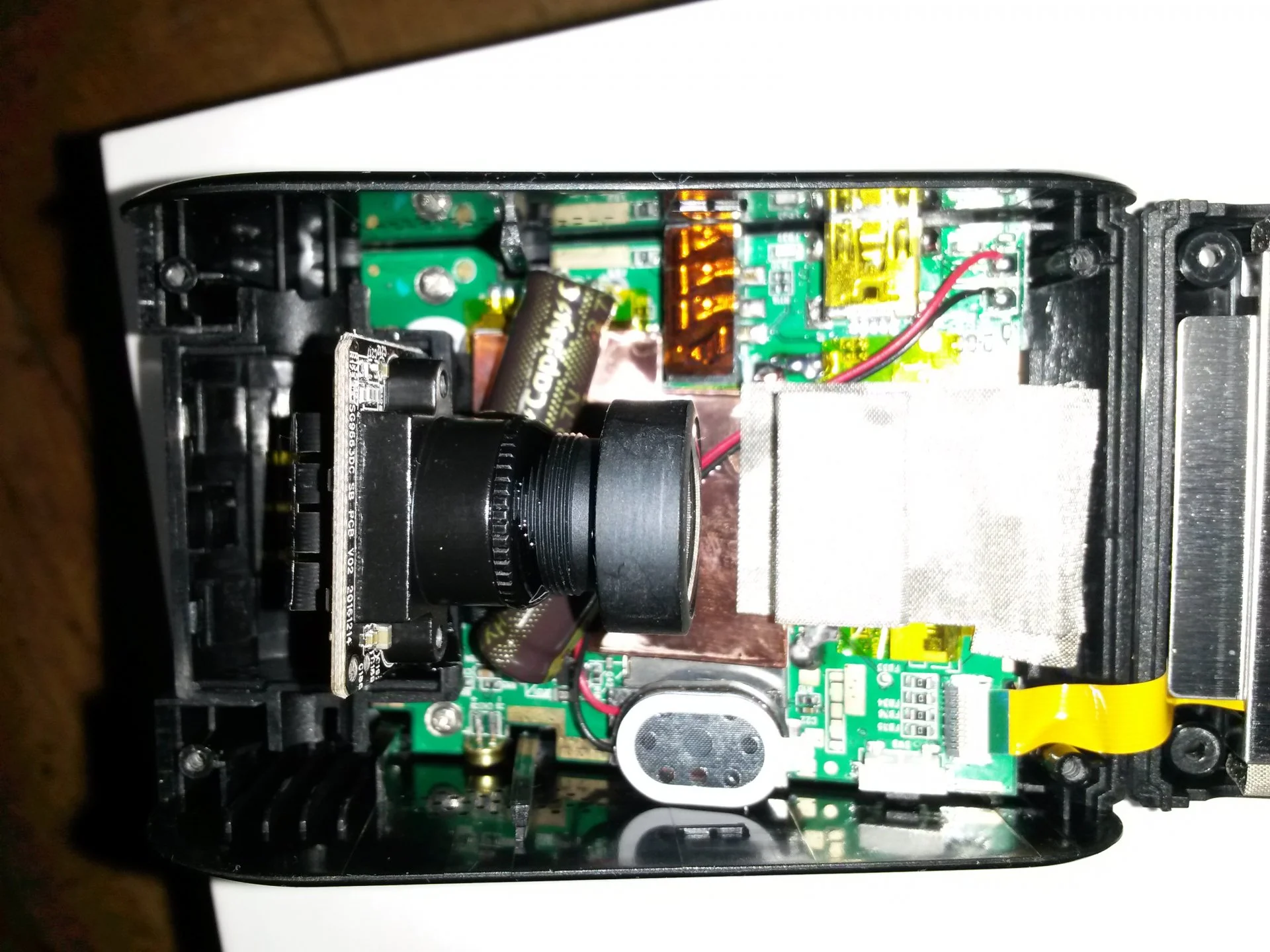

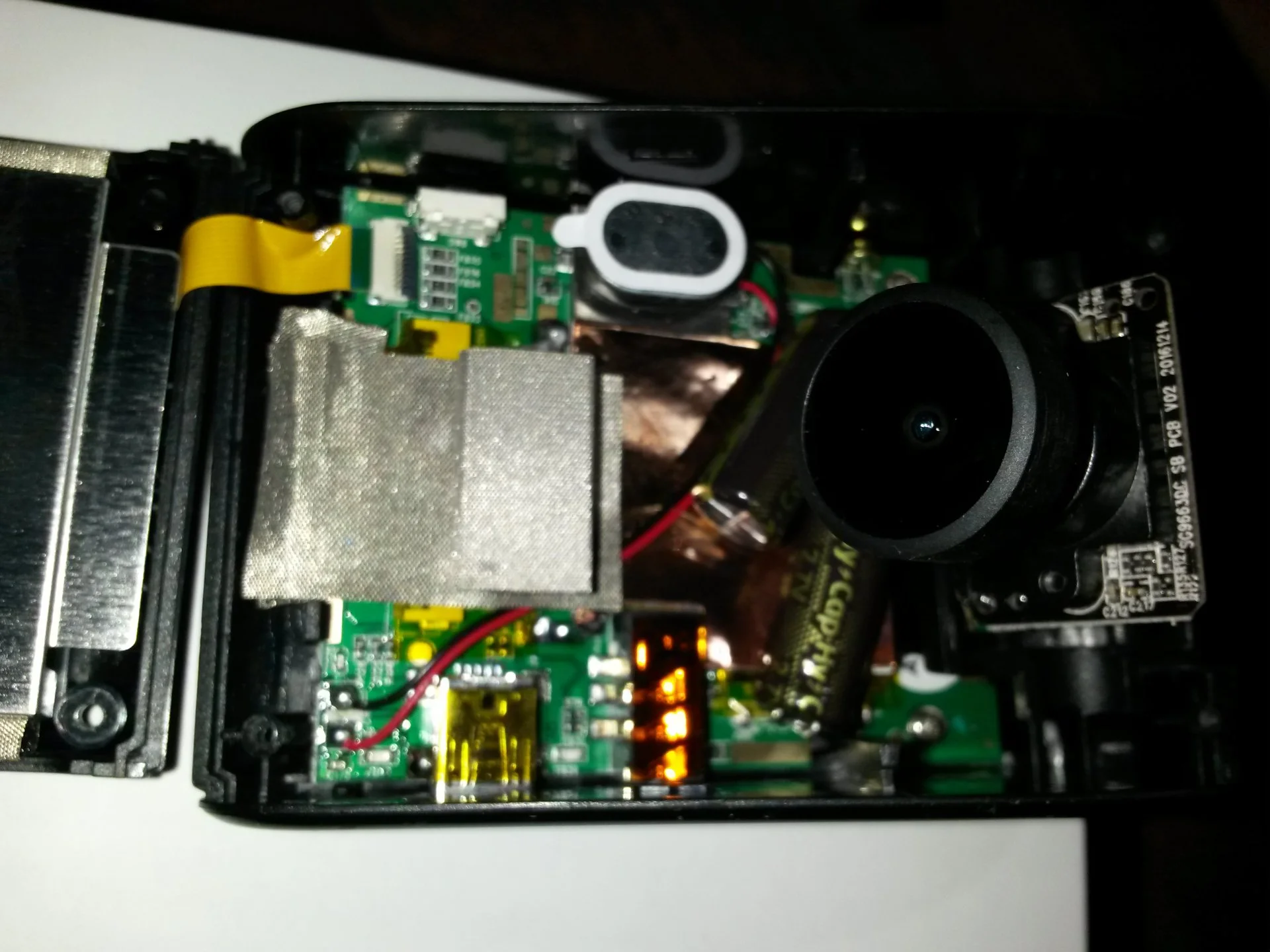

Very good work. But please change the position of the speaker wires.
It was the way how they were fixed right after I opened the cover. What is the better option please?
Put it at the bottom of the housing.
Away from the copper sticker
Make it like in this video

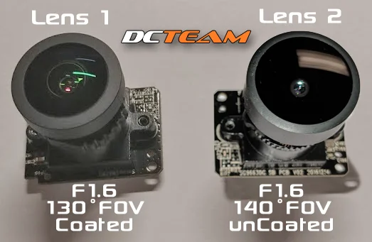

It's lens 2.
The newest viofo lens (it's out for a long time though).
That is the original A129 lens. Not sure why it's referred to as V2 in the picture in the previous post. It's a good lens.
It's not any official V2 lens designation. It's more for general knowledge that us members of the forum here use. Differentiating between the various lenses and mountings that the A119S has had over it's production is more for the modified firmware user's knowledge. This is important for us, since the official fw, as well as many of the modified fw we're using have different picture quality results/quirks based on the specific lens that A119S has.
And I guess as well to get a CPL filter that doesn't vignette the picture. A119S lens 1 does not vignette, lens 2 (also used on A129) does vignette unless you have the newer CPL filter design.
It's lens 2.
Thanks for identification.
there's a lot of misinformation about lenses which just leads to confusion

Great questions and you are correct, its all screwed up by my 2017 mistake.
My old Lens Comparison video was accurate except for one digit. All A119S Dashcam VIOFO Lenses use F1.6 aperture, I mistakenly used F1.8, its more of a "label" to tell them apart for reference. To be accurate only the A119Pro has the F1.8 aperture Lens. To be more precise in that video was the very first Public photo of the current Lens 1 being used in A129Duo, it was sent to me for testing, both the old 2017 Lens V1 V2 are my own references numbers and not official designations and the reverse of my current Lens1 Lens2 names.
Its all very confusing due to the mistake in my video referencing F1.8 aperture. In an effort to clarify the Lens versions and answer your question here is current known information Dec 2018.
FACTs
Back in 2017 when that video was made it shows the original 2016 Lens.
F1.6 uncoated Lens with defective metal base 135 FOV used in original first generation A119S fits original CPL Filter without vignetting = now abandoned not used in any A119S as of Jan 2018.
F1.6 coated Lens with plastic base 130 FOV used in original first generation A119S fits original CPL Filter without vignetting = still found in some A119S as of Jan 2018. = (BCHobbyist 2018 name = Lens 1)
F1.6 coated Lens with new metal base 130 FOV used in second generation A119S fits original CPL Filter without vignetting = used in A119S and A129Duo as of March to Dec 2018. = (BCHobbyist 2018 name = Lens 1)
F1.6 uncoated Lens with new metal base 140 FOV used in second generation A119S & A129 requires larger beveled CPL Filter to stop vignetting = used in A119S & A129Duo as of Jan to Dec 2018. = (BCHobbyist 2018 name = Lens 2)
I changed my own Lens naming scheme also by mistake, the new and different wide angle A129Duo Lens became Lens 2 due to A-1-2-9 more accurate name should be Lens 3 but too late now.
These are my own Lens names for reference only and have nothing to do with official or ordering specifications.
Correcting YouTube video today.
Actually both lens are F1.6, main difference is FOV.

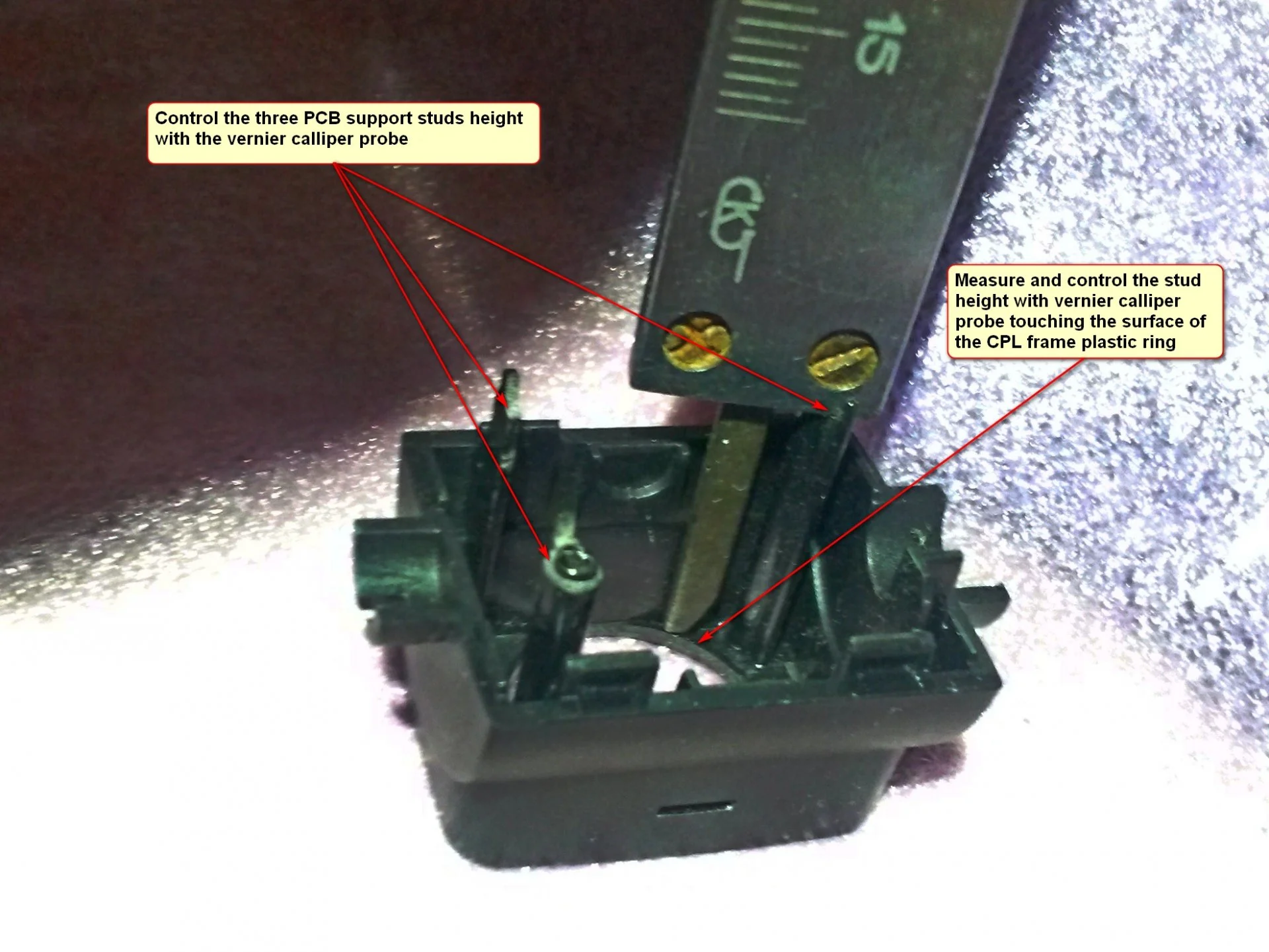

I pointed the lens on gray LCD test screen and discovered very slight corner vignetting while CPL is attached. It took me about half an hour to get rid of the problem. Hope this will be useful for other users.
Instructions

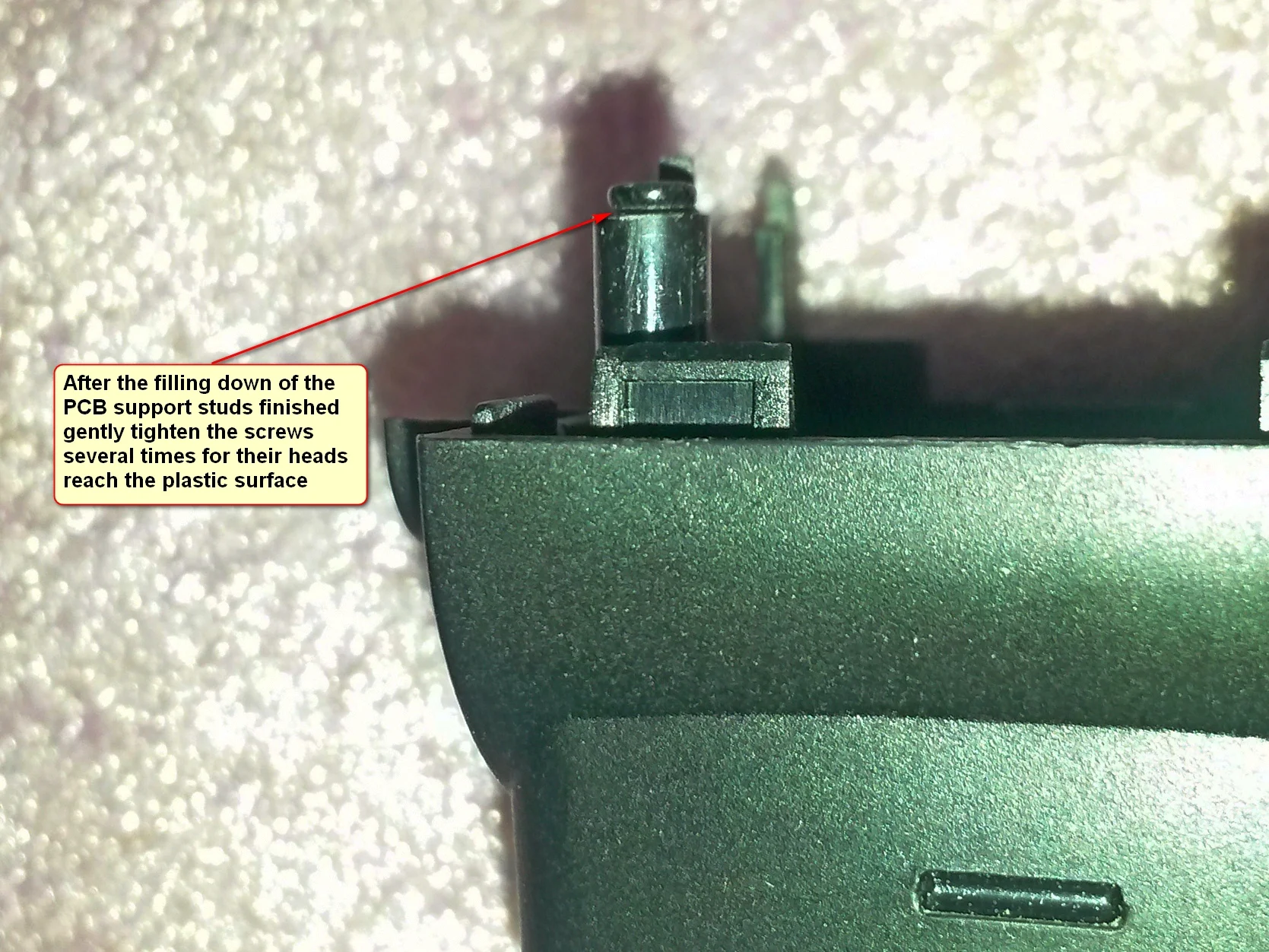

1. Remove the camera cover and disassemble the upper lens case. Unscrew the lens PCB and remove the front lens cover. There are three points (studs) that should be shortened for about 1 mm to move the lens forward accordingly. Measure and control every stud height using vernier calliper as shown
File down the 3 support points for about 1mm as shown
After the filing down of PCB support studs done, gently tighten the screws down and up several times for heads to reach the plastic surface as shown
After modification is finished tighten the lens PCB with two screws and assemble the lens case as well as the camera case.
As it shown in the photo the lens overtops the frame for 1mm, whilst it still doesn't touch the inner CPL surface.
The above modification completely removes the CPL frame vignetting effect from the wider type 2 lens.
