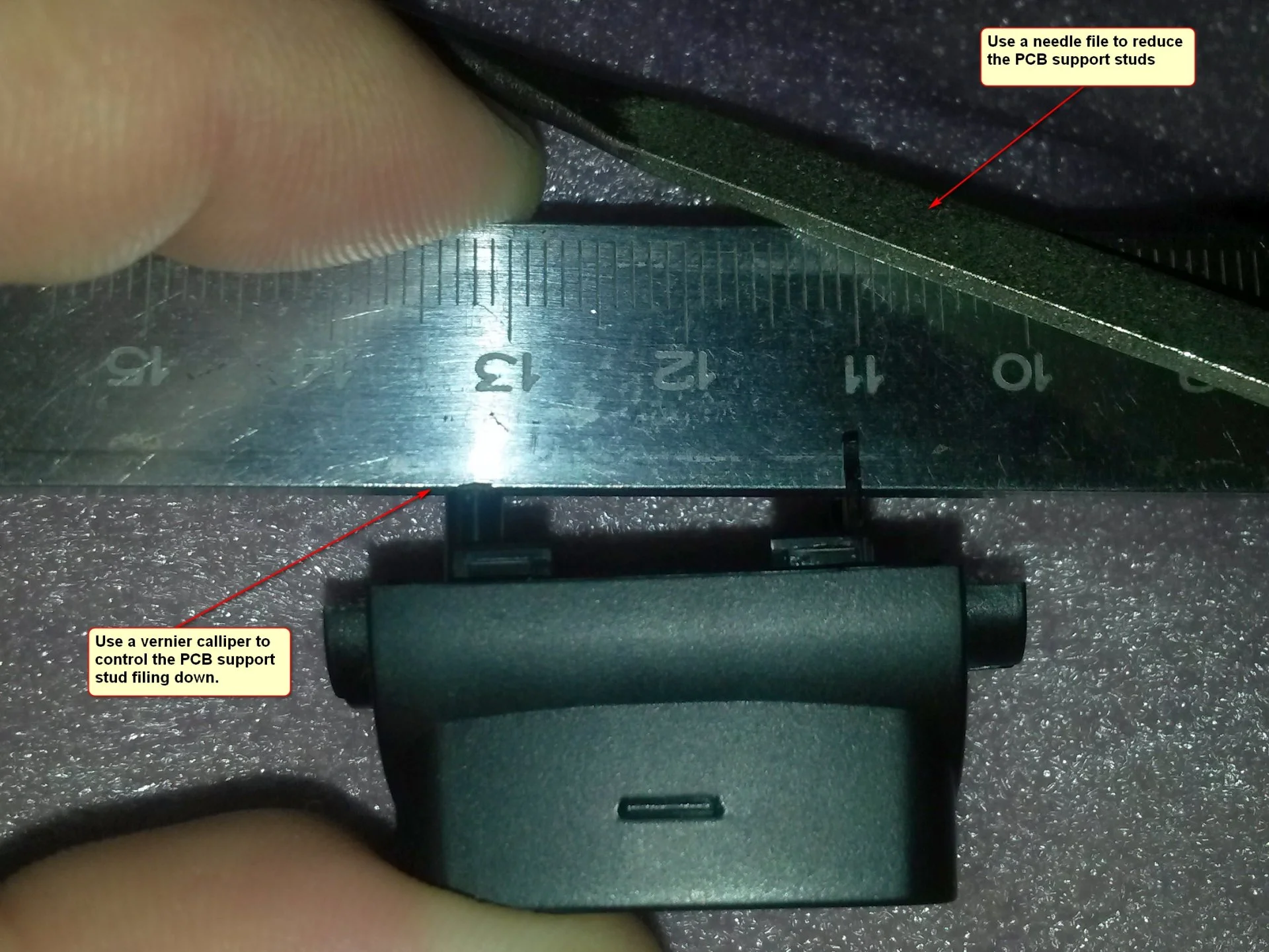

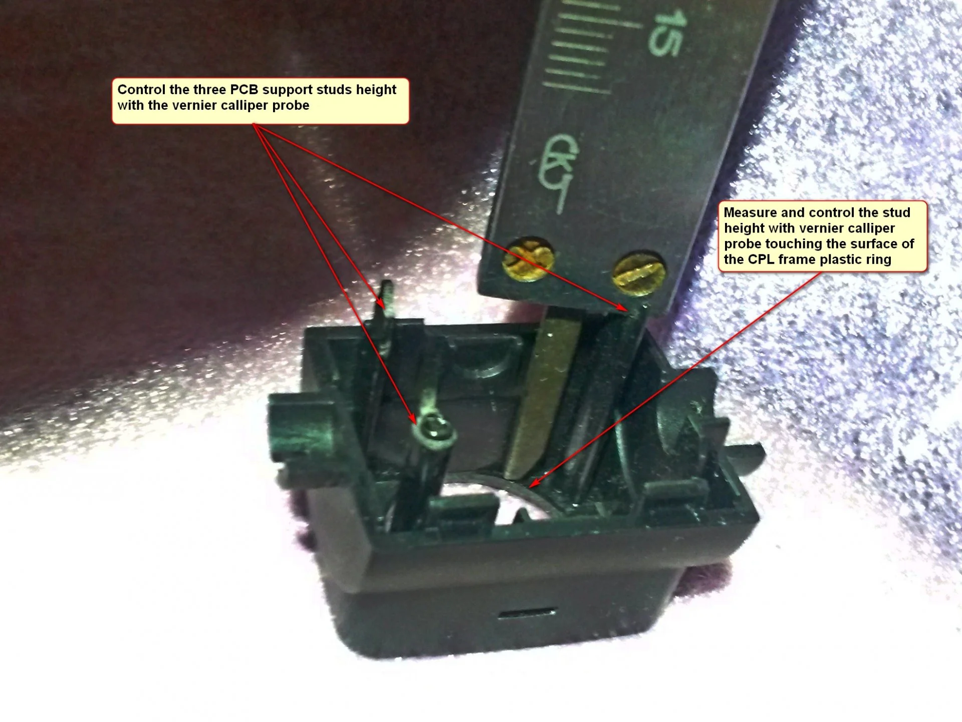

I pointed the lens on gray LCD test screen and discovered very slight corner vignetting while CPL is attached. It took me about half an hour to get rid of the problem. Hope this will be useful for other users.
Instructions
1. Remove the camera cover and disassemble the upper lens case. Unscrew the lens PCB and remove the front lens cover. There are three points (studs) that should be shortened for about 1 mm to move the lens forward accordingly. Measure and control every stud height using vernier calliper as shown
File down the 3 support points for about 1mm as shown
After the filing down of PCB support studs done, gently tighten the screws down and up several times for heads to reach the plastic surface as shown
After modification is finished tighten the lens PCB with two screws and assemble the lens case as well as the camera case.
As it shown in the photo the lens overtops the frame for 1mm, whilst it still doesn't touch the inner CPL surface.
The above modification completely removes the CPL frame vignetting effect from the wider type 2 lens.

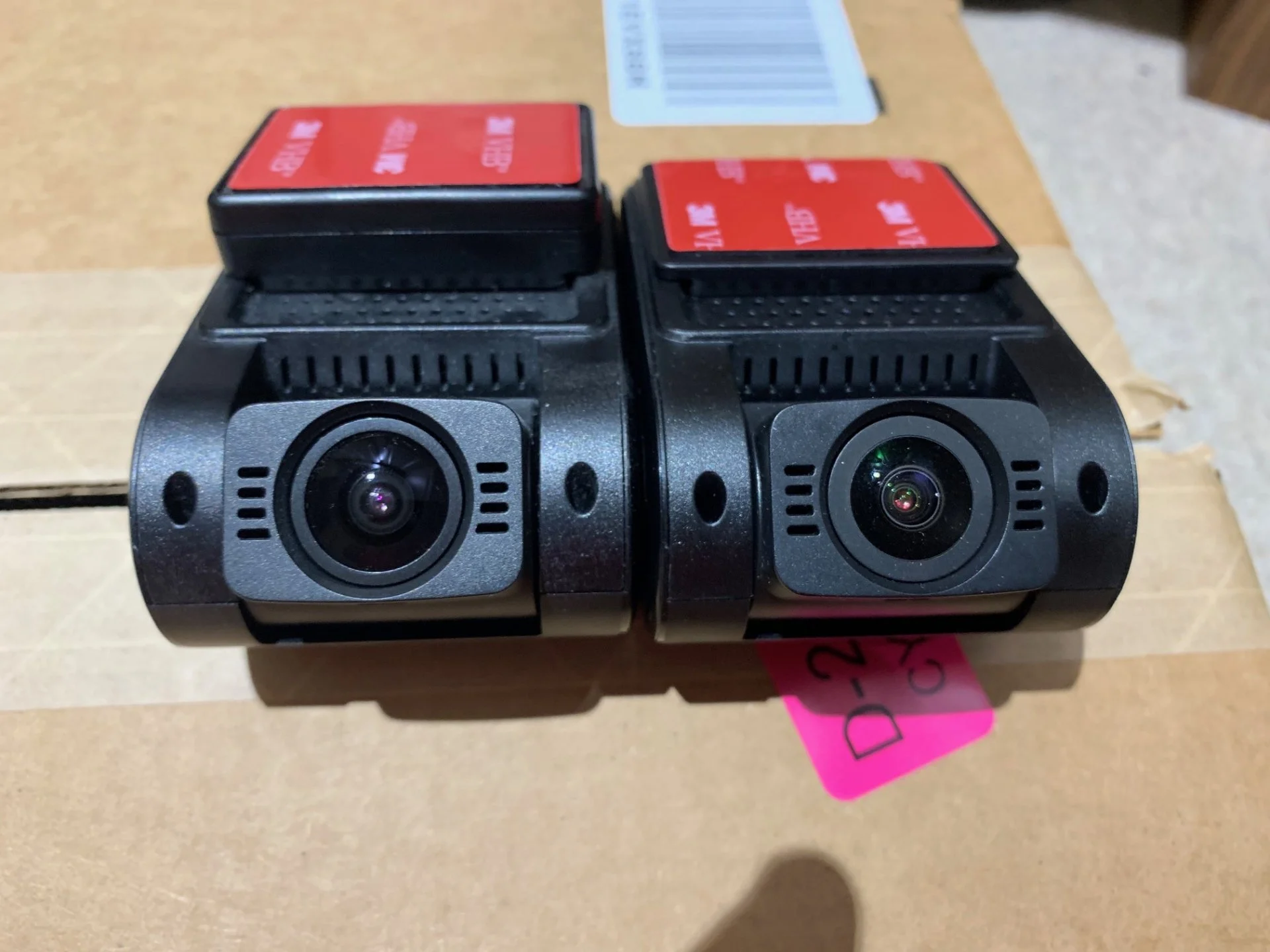

Here's the 2 VIOFOs I have right now:
OK now I'm a little confused.... which ones do I have here and which one is best? I need to put the best one in my Wife's car.
We recently had an incident on the road with a truck throwing rocks (very negligent trucking company) and when I went back to try and ID the truck the footage was horrible (original VAVA camera (non-2K), daytime sunlight footage, me and the truck traveling at 70MPH with the truck in the lane next to me).
On the left side you have so called V2 lens, on the right side V1.
It's hard to say which one is better without checking some footage (preferably taken under same conditions).
One of the cams can be perfectly focused, the other one can be slightly unfocused...
I prefer the V1, but it doesn't mean it's better then the V2, it's just my V1 is focused better.
The best way to determine which one is better is to install both of them (same firmware) and compare video or\and screenshots.
Readability of license plates depends on many uncontrollable factors, so it's best to install and run the cams simultaneously.
MOD firmware comparing to the VIOFO stock firmware can also improve video quality, especially by increasing the bitrate.
We will never know unless some gets a different lense and reports its photo on the forum I guess🙂
