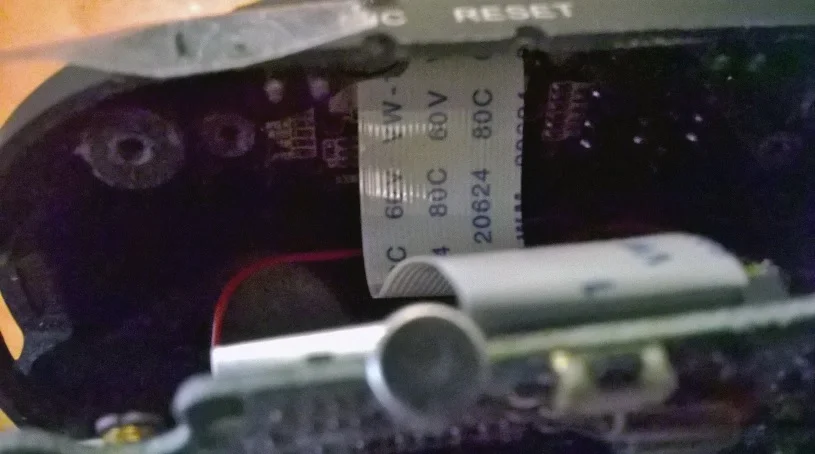

There's a circuit board right in front of the len. I can't even pull it out.
Same here.
I opened it up and took the board out but there is another board all the way in the case that won't budge even after taking all the screws out.
Adjusting lens is not an option in this one so I'll just use it as it is for now and for rear view once I get something better for the front.

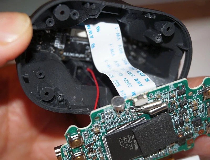

It does have NT96220FG chip. Good deal for the price though.

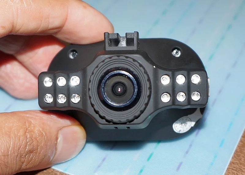

Here are few pics:
Shiny 12 IR LED's look cool even if they don't work.

You can disassemble this camera, if something inside doesn't budge then you probably haven't noticed a screw somewhere. It's easily taken apart.
I took 4 screws from the inner board and couldn't pull it out.
There were no more screws.
I'll try again.
If I succeed to take it out, do I have to put everything back together for each adjustment?

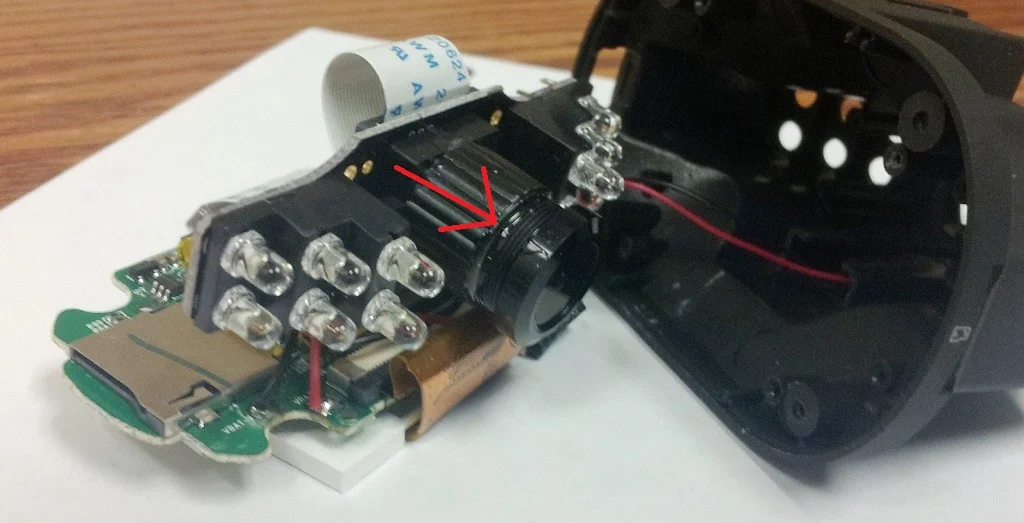

Nope, you can adjust a disassembled cam. Take still photos with it and watch on a large enough monitor to see if you got it focused or not, you only have to alternate between car charger and PC USB connections for this. Assemble when you have achieved the desired focus.
Okay took it out. just had to push on the LED's from front.
Now trying to take the glue off from the lens mount so I can twist.
