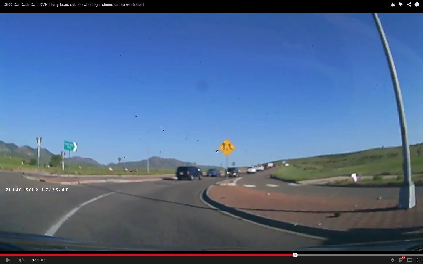

Out of focus (blurry) C600 dashcam videos and pictures.

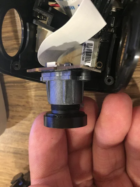

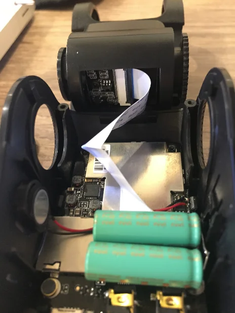

Undo two screws on the back side of the sensor board and remove the holder, put it in a vise (don't tighten too hard) and use pliers through a piece of thick cloth on the lens top to break the bond. When putting the holder back double check that there are absolutely no dust specks on the sensor.
I haven't had the chance to use it because it died on me after a couple of days. When turned on manually LEDs were pretty good at distances around 10ft and that's about the only thing I could check.
Undo two screws on the back side of the sensor board and remove the holder, put it in a vice (don't tighten too hard) and use pliers through a piece of thick cloth on the lens top to break the bond. When putting the holder back double check that there are absolutely no dust specks on the sensor.
I used a thin flat screw driver to scrape the glue all around and I was able to twist it.
Twisting on the left was worse so the focus was on the right.
I twisted 45 degrees and it was too much so I gradually twisted back and I think at 10 degrees to the right from initial, it has better focus.

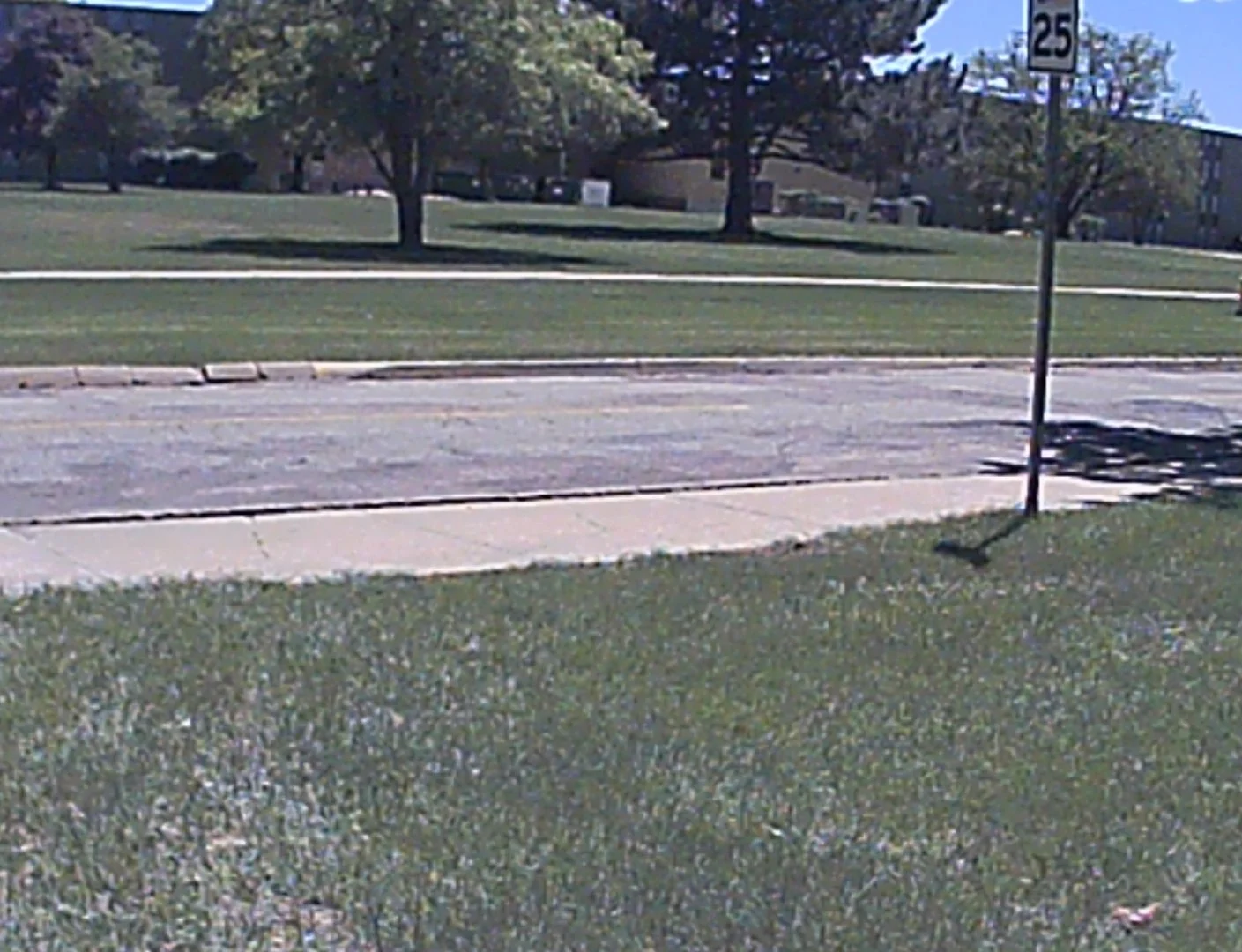

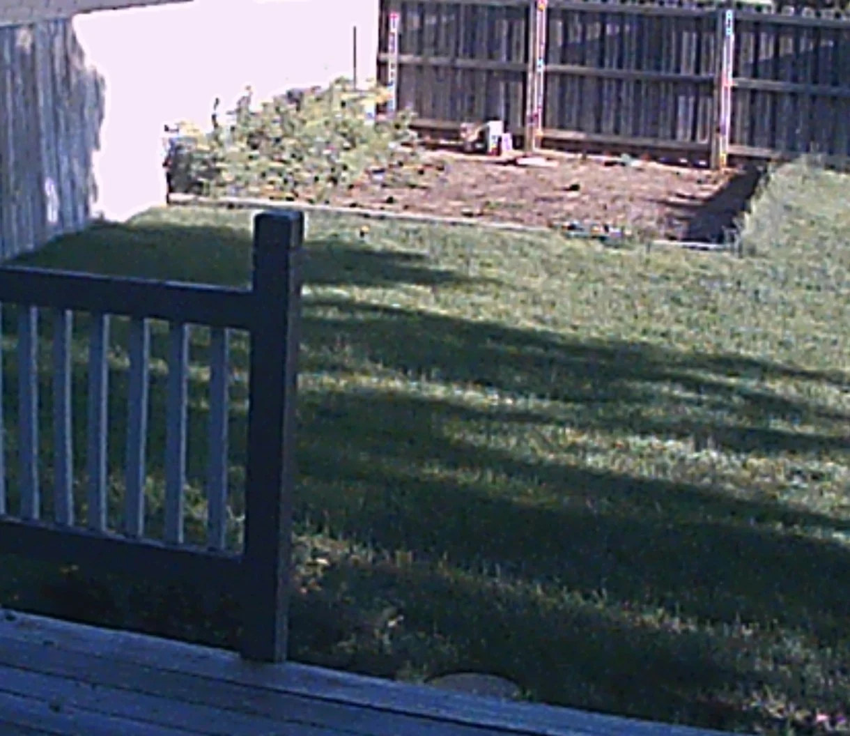

I took some sample pictures outside and I could see more definition on the grass so hopefully, it'll take better videos.
This was when I got it. Not the same place but grass had no details.
08070004-crop-dashcam-jpg.5314
This is today:

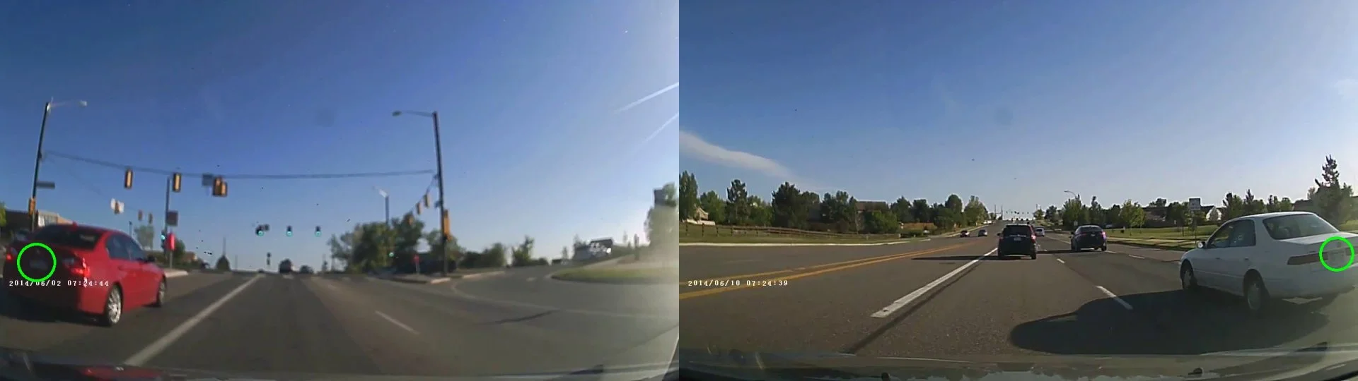

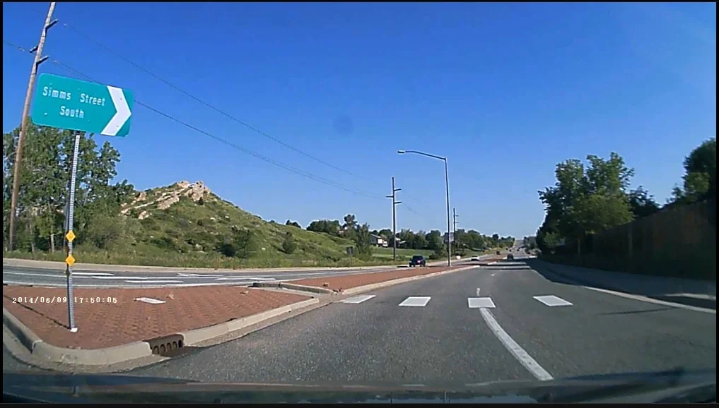

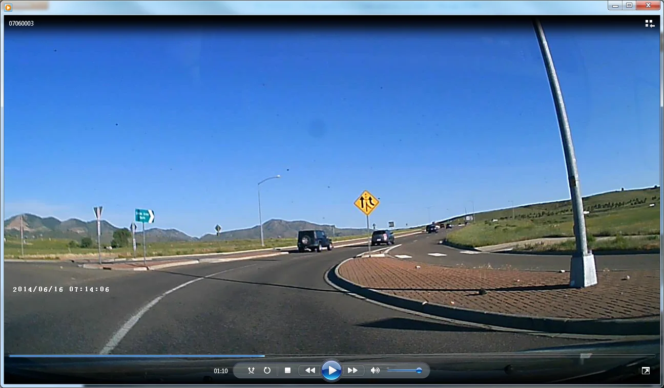

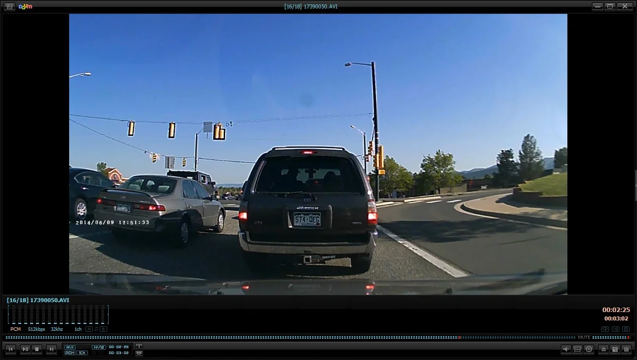

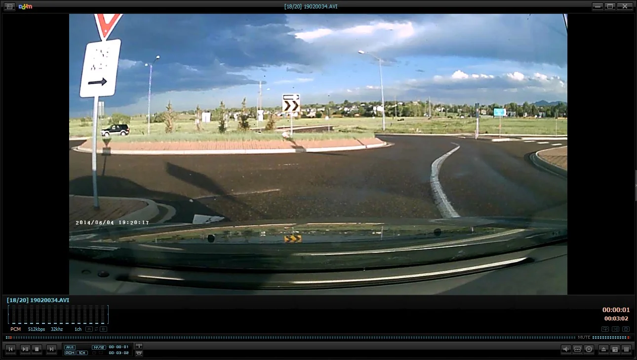

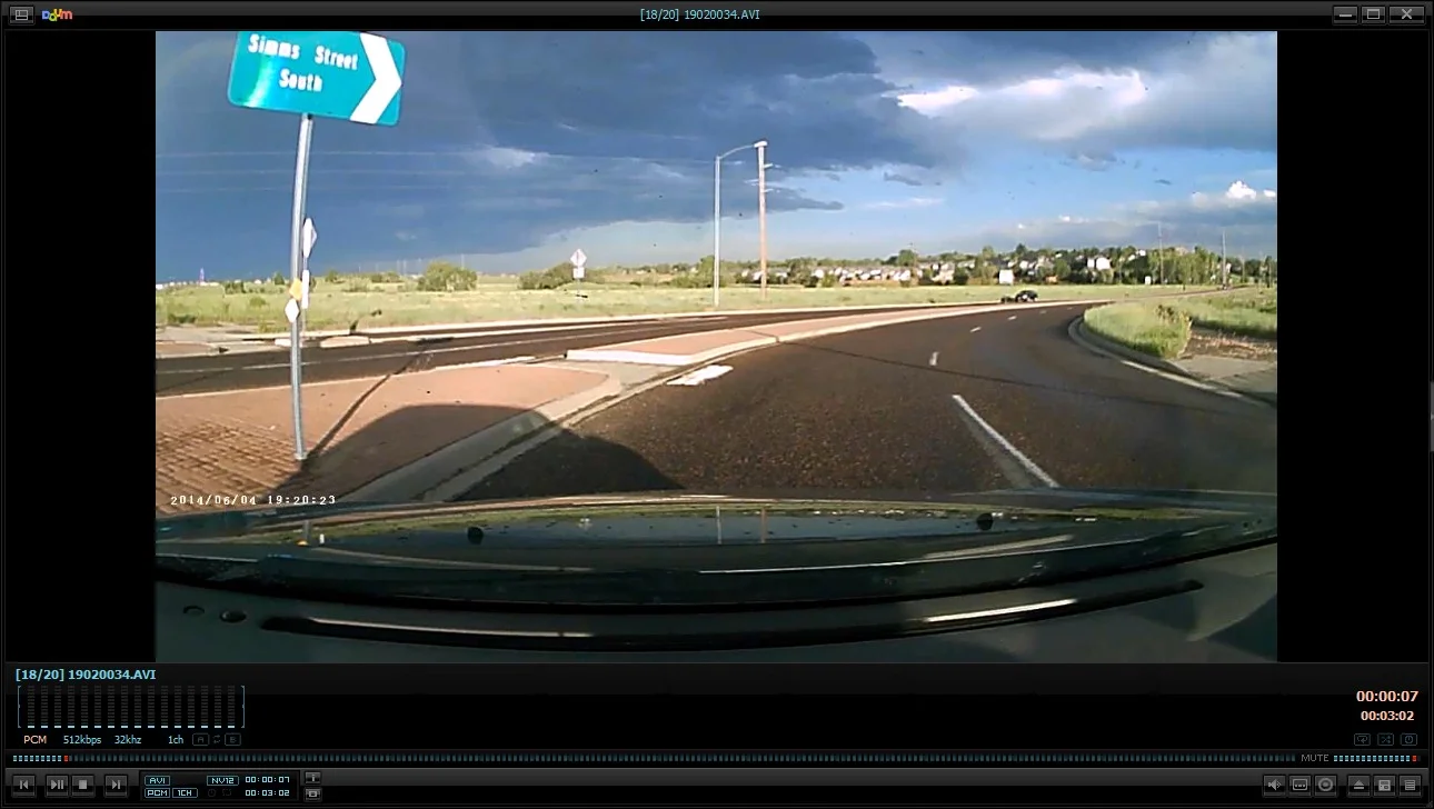

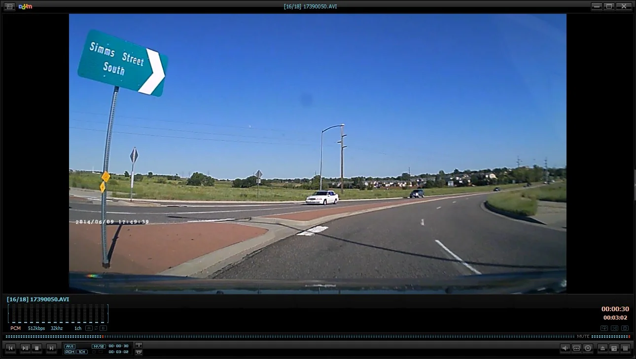

Here are screenshots from videos before and after. As you can see, the video is sharper/smoother but also looks little bit farther. Specially, check Before3 and After3.
Thanks
Before1:
After1:
Before2:
After2:
Before3:
After3:
Before4:
After4:
And here is the initial image in picture mode (not video):
Before:

After:

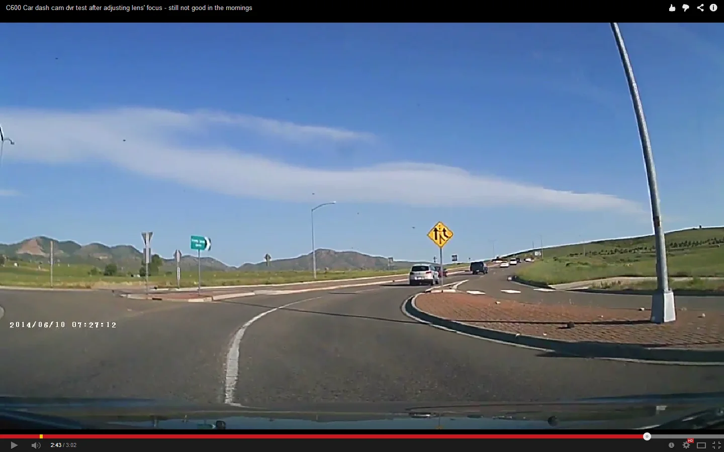

Drove this morning and it is still slightly blurry outside.
I think it is the temperature or light issue.
Yesterday evening had great videos and hopefully, today evening will be great too.
Mornings are not too bright compared to the evenings so that could be the problem.
Still, it's better than what I posted here initially.

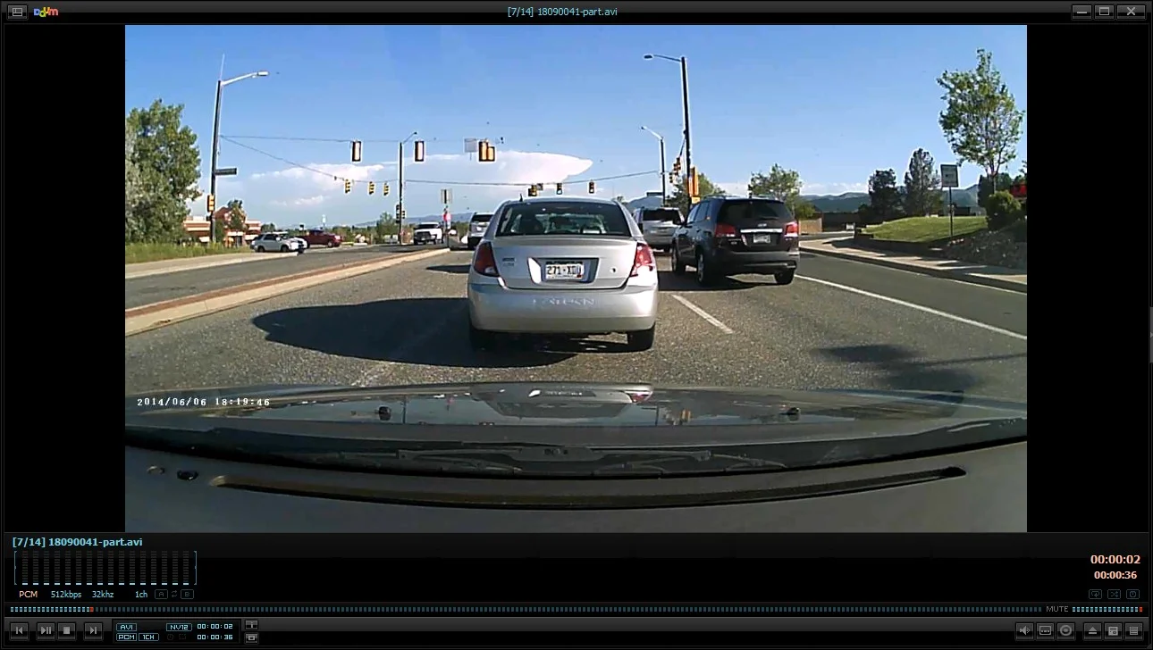

This was before in the morning: Really bad focus.
This is today in the morning: Still slightly blurry but way better than above and can make out things much better.
Looks like another focus session is due in near future. 🙄
Here is screenshot from the videos above for comparison.
Before:
After:

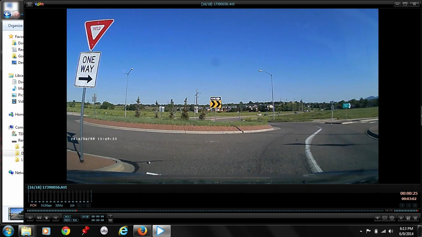

Try to get as good focus as possible in these areas
Overall well done.
Overall well done.

So how should I test the focus at home?
I mean what distance/angle should I put the license plate from the dashcam?
I have a spare license plate somewhere or I can write something on a paper to test and adjust the lens.
50 ft away is more or less the farthest point where plates are still legible, this is for 1080p cams, probably a bit less for 720p. Put the plate like it's on a car in the lane next to yours, like in the pic above, and move it from close up to around 50ft and see if the focus is good all along. Focusing on a plate head on (=car in your lane right ahead) is secondary to these.
I tried but doesn't look like it will be much better than what already is.
This is from this morning. May be slightly better than above.
I'll update after evenings drive back home.
Already quite good, now take your time, accumulate some recording footage and look if you don't like some areas. If all is satisfactory within reason, just leave it as is. Despite being 720p or 1080p no cam (I saw) produces pixel to pixel clear picture, a pixel in an image is always more than one pixel picked up from sensor. I hope you understand what I'm trying to say. Compression takes its toll removing or distorting small detail.

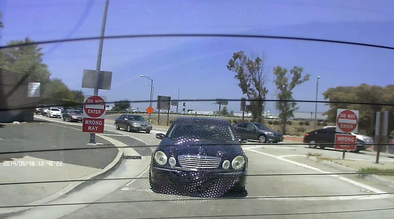

I'm inspired by the success of Sunny and have just refocued my C600. It's really hard to refocus this thing
Before rotating the len, the left side was blurry.
untitled-jpg.5319
After, it's the right side that is blurry.
untitled-jpg.5601
if one side is in focus and not the other that's a quality issue, there's always compromises made to get to a price point
Release two screws holding the lens housing and slide a narrow strip of paper under one side between the housing and the board, tighten the screws and check if both sides are sharp or blurry. If one side still is out of focus but not the other, move the paper strip to the opposite side of the holder.

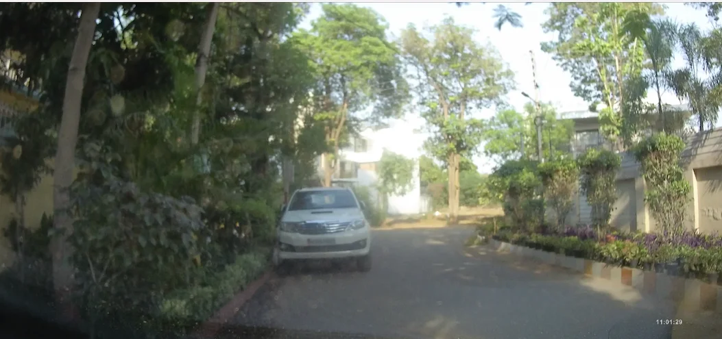

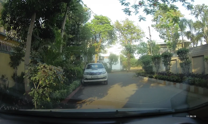

I tried the same trick of rotating lens a bit on A118C x40 that I recently purchased from Gearbest.com. I was too facing the out of focus issue from day one, it got worse in last two days when outside temp here is around 44 degree. I Managed to open it successfully and got the focus back 🙂. Lets see for how much time it stays good. Before and after images enclosed below.
Thanks everyone at dashcamtalk for helping me solve my issue.
Before
After:

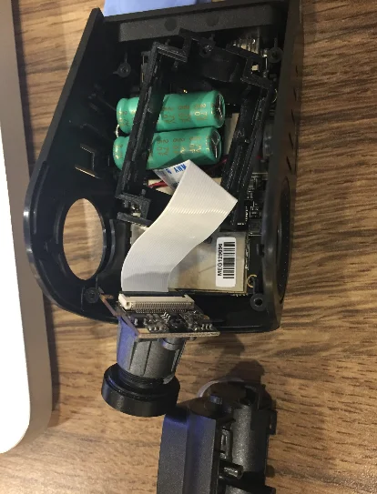

Some inside dashcam pics:
