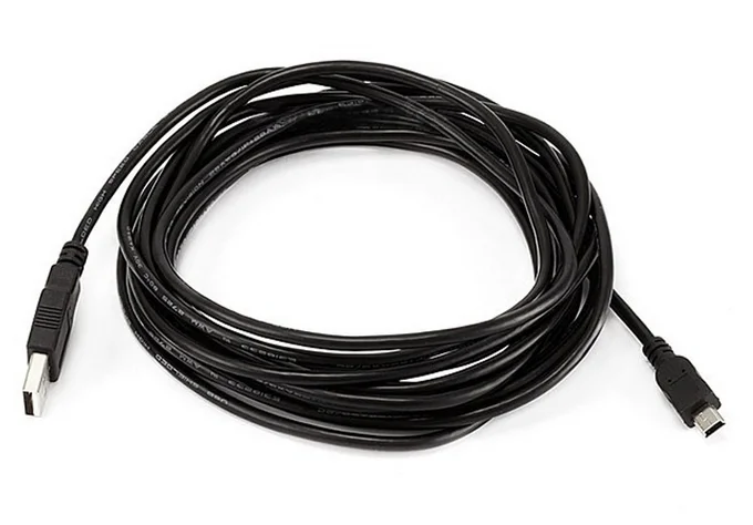

My vehicle has two 12V "cigarette lighter" ports in the front console, so I use two dual USB chargers similar to the one in this photo. For cables I highly recommend Monoprice. I use 10 foot and 15 foot USB-A to 5 pin mini-B cables, which are shielded, well made and very attractively priced. The same cable is available with a micro plug on the end instead of a mini-B. You can also buy a heavier AWG version with a ferrite bead. When you want to use your power bank, just swap the USB-A plugs from the car charger to the bank.
View attachment 22118 View attachment 22117
Thank you. Just ordered the 10 ft cable with ferrite bead and the same cigarette lighter port. I realized that most conventional USB ports in a car is rated at 5V at 0.5A which I believe not sufficient power.
You're welcome! Yeah, 1 amp is the bare minimum you should have for current. Longer runs of cable often will benefit from more. The dual port car chargers I use supply 2.4 amps to each USB port.
