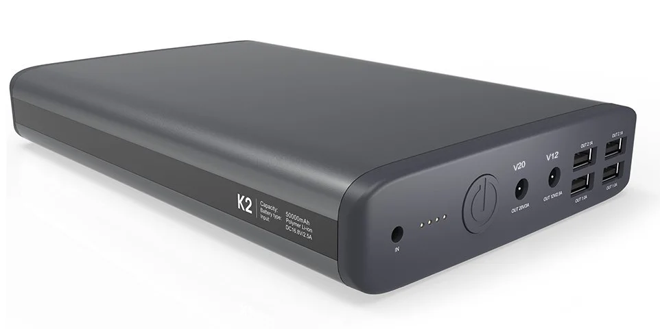

One idea for running a Mobius for 24 hours on a battery might be to use a huge powerful powerbank.
I came across one on Amazon recently that I find very intriguing. the MAXOAK 50000mAh 185wh 6 Port(5/12/20v) Portable Charger External Battery Power Bank. It is a true, high quality 50,000 mAh battery bank with 6 ports, one 20V/3A, one 12V/2.5A, two 5V/2.1A and two 5V/1A!
The thing weighs in at 2.7 pounds and is 8.1" x 5.3" x 1.3" inches. The price is $135.99 which is not cheap but seems quite reasonable for what you get. It "appears" to be a quality offering from a company that stands behind their products and I'm actually considering the purchase of one of these myself as I currently use two powerbanks to run four dash cams in my vehicle. This could also be a solution for someone who wants to run something like a 12V SGZC12SG or Panorama in parking mode without using their car battery.
yeah that big bank is getting into my wheelhouse. i suppose i am going to just swap/charge banks every day or so.
the portability factor of the bank over a spare battery is quite enticing
Dashmellow, Let us know of your review when you get a chance to test this Maxoak K2. After reading some reviews and the connected comment string on Amazon, it is interesting, and may have improvements in the BMC, like you note above.
Well, I'm still in the "considering" stage about purchasing one of these but rest assured that I will post all about my experience with it should I buy one. πŸ™‚

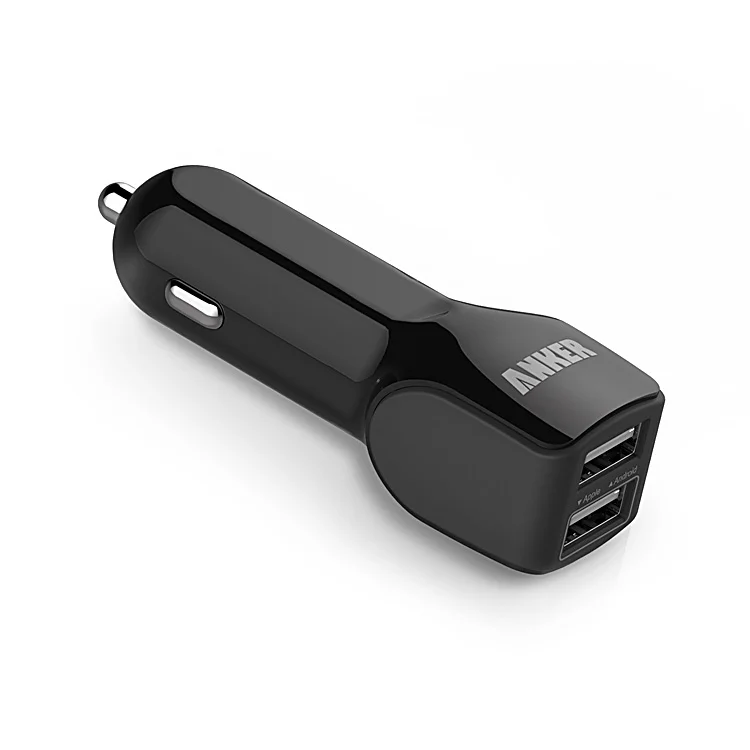

All you need is a USB-A to mini B cable and a USB cigarette light power adapter.
