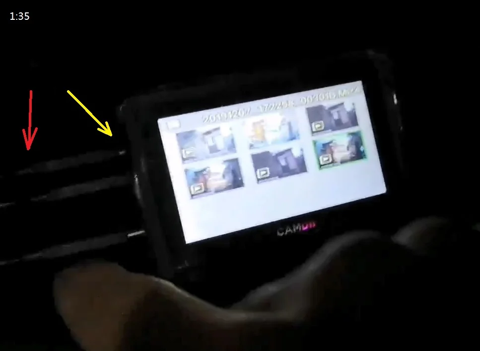

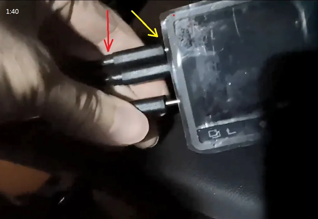

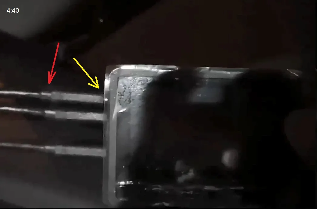

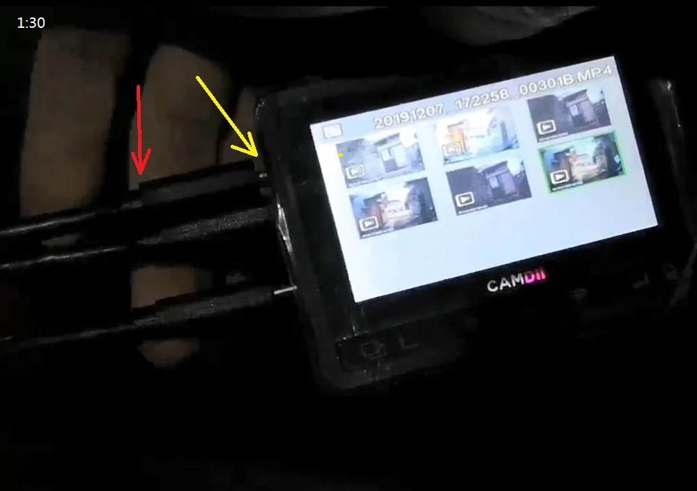

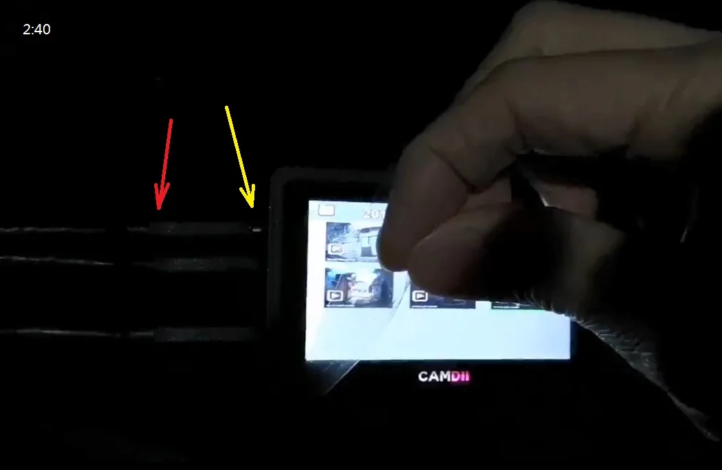

I am doing my best to make you understand your have NOT connected the USB-C connector correctly.

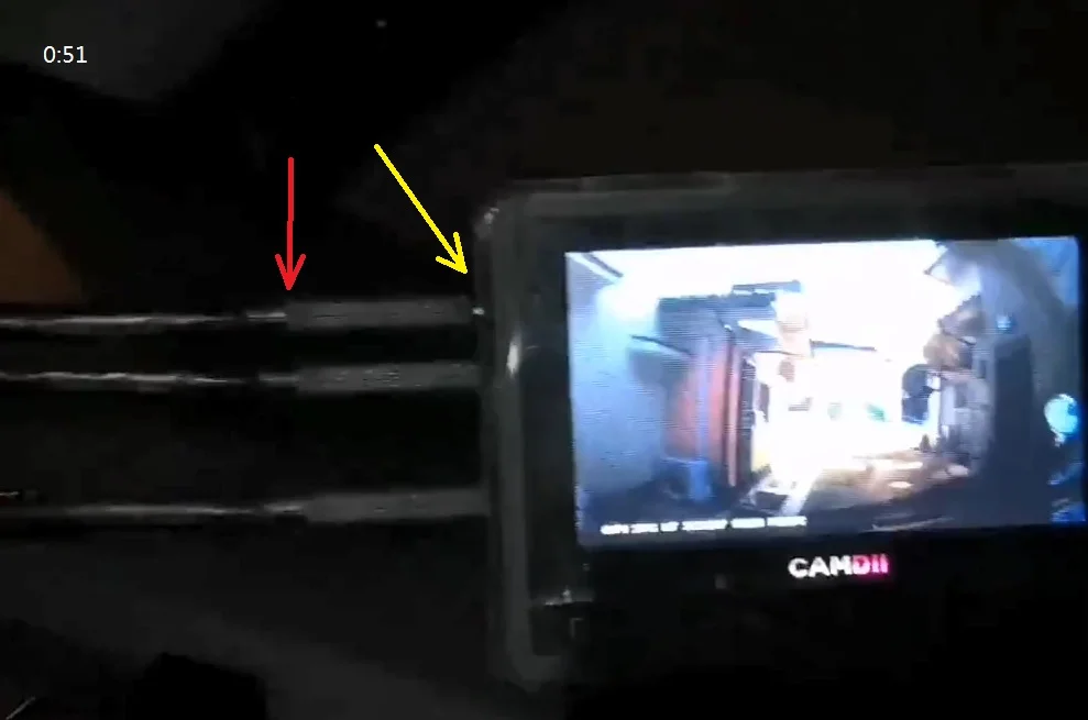

so if you try 1 camera at the time, to test camera modules, and the wires to them it must be in the camera #1 slot,,,,,, good to know for problem solving.
PS: i have the wire / plug "lock" mounted now, but that have not changed how my K2S behave, i have not been able to relocate the camera and put it on a regular power source, but i am working on that.

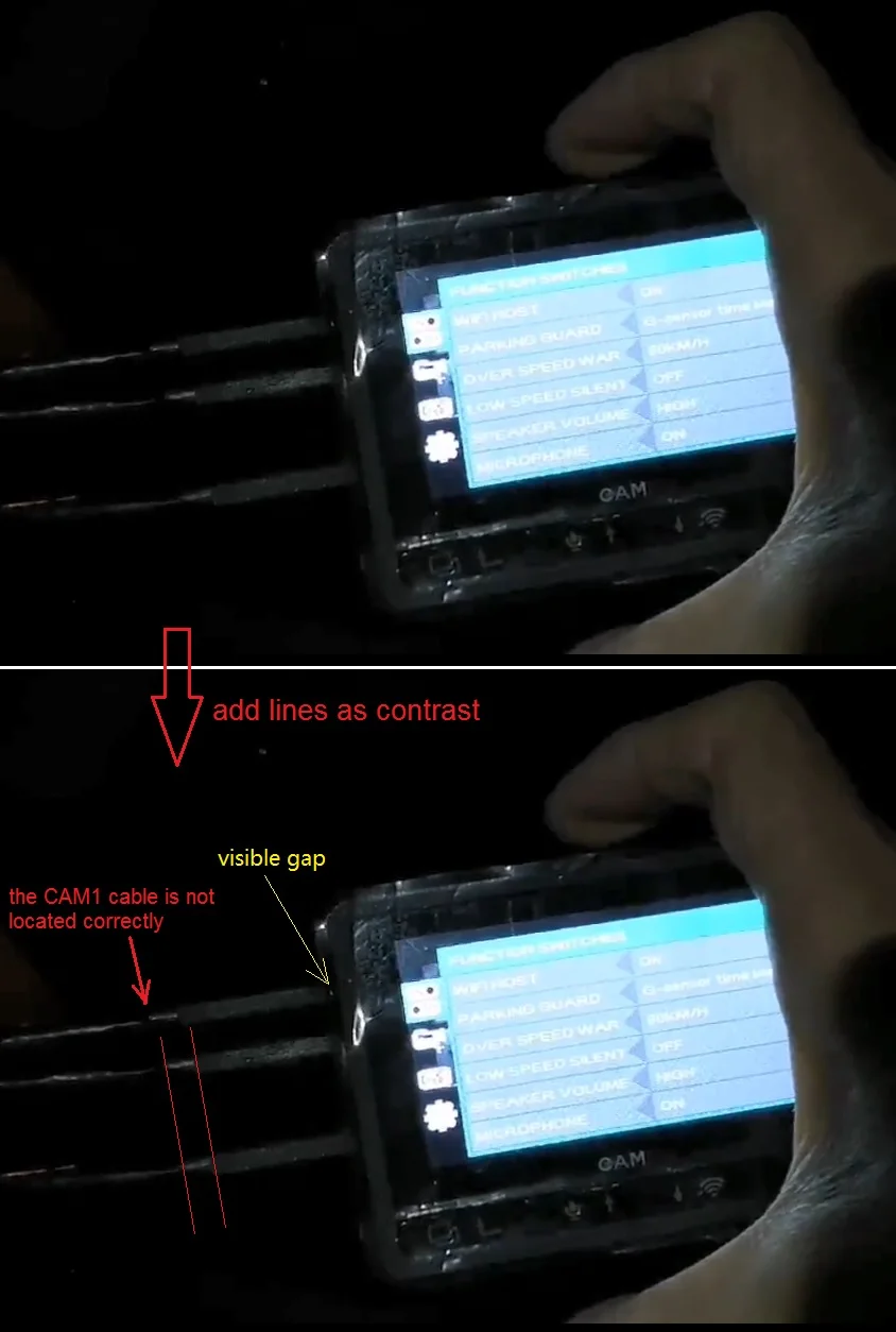

Yudia,
again, I still found there is connection problem in you video.
see the image below. It reason is obvious ---- bad connection.
for easier contrast, I copied the image and add lines to show you why I say the cable is not fullly inserted into receptacle on recorder body.
hope you can understand this.
From the first day I got your feedback, I have point out the connection problem.
the light at gap position is the metal housing of USB-C connector.
@Rayman.Chan
*All orange markings are dust adhering to the film.
In the environment where this video was filmed,
Even if light is reflected by metal, the metal material is shaded and appears black, so it cannot be confirmed.
*This is a temporary connection to verify the normality of the camera.
Since there is a high possibility of disconnection, the mount is not used for temporary connection.
*All joint positions are the same.
*Using anti-aliasing on the line makes it difficult to locate.
Therefore, I marked it with an orange parallel frame.
Process to deceive the people by anti-aliasing is not done.

As for this video, this is my complete careless video.
(Because I shoot many times with different wiring.)
However, if you can reproduce the same symptom about the video crashing in purple and green as well, please tell me that.

Yudia,
can you just SIMPLE push the USB-C cable at CAM1 a little more? to make it fully inserted into the socket?
from your this video, I ever think you intended to keep CAM1 NOT connected:
when you plug out and plug in the power cable for several times, it should be easy to find the CAM1 cable is not connected.
I will connect and check only one rear camera for a while.
Verify using the mount.
please remember to use CAM1 port if you want to check only one camera.
and make sure the cable is inserted fully
and make sure the cable holder is locked correctly.

I have only the same answer, because that is the only reason which caused the problem.
BAD CABLE CONNECTION
and you may owe me a SORRY now. 🙂
Yes a careless mistake may damage the earth. we need to check with the other's suggestion.
we can easily reproduce the same symptom by pull the camera cable out a little, make a bad connection, Just to react the bad image.

About TYPE-C cable, I have already fully inserted it in the past.
You capture only the video of the temporary connection status, and talk about it as a problem.
When I first contacted you, I have already reported to you the mounted video just after installation, and the progress after that.
As I have said many times, the mounting parts will not lock if the cable connection is incomplete.
Also, I actually know that your designed mount lock is precise and rugged before you remove the mount and verify each part.
This time, in the case of the video you captured, the video I shot is likely to be the front camera on the camera connected to PORT1.
Interpreted from the date displayed on the LCD.
However, only uploaded videos are true.
(I can't identify it without judging from the A or B property of the video file name.)
However, in handling the product, I basically do not connect in an incomplete state.
I am the type of person who hates the most in situations where a product does not perform its function.
Today's video (only the rear camera cable, power cable and mount connected) will be uploaded tomorrow.
I don't understand what you say about the word "Earth". (I'm sorry for this)
If you indicate the meaning of GND connection, the GND state is maintained by the material and shield of the TYPE-C connector.
As you can see, the GND side is not floating.
