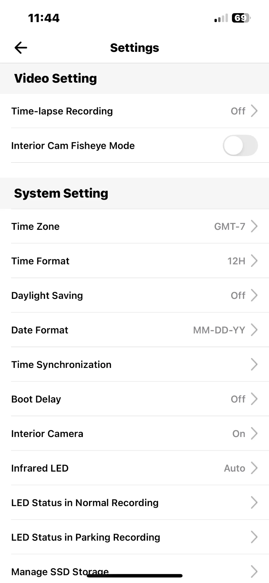

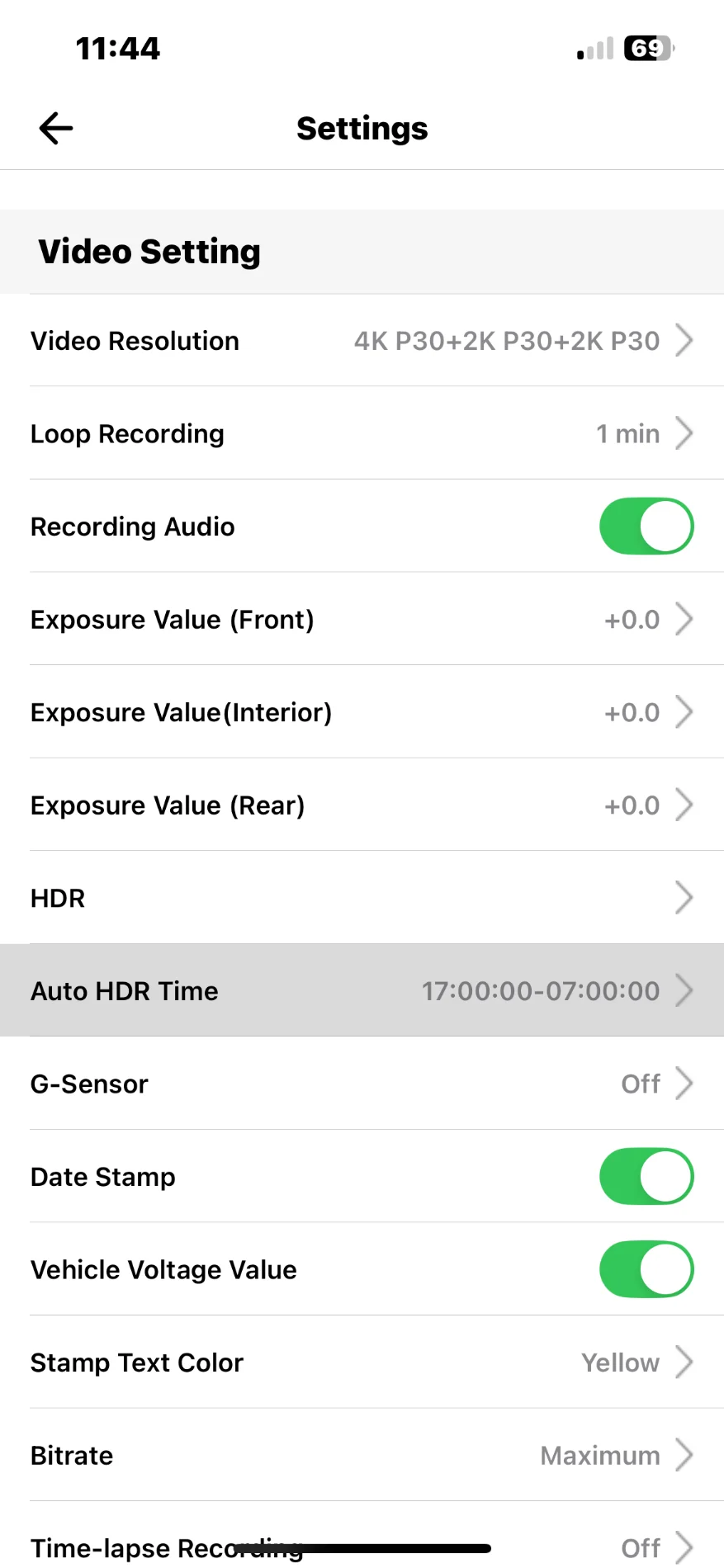

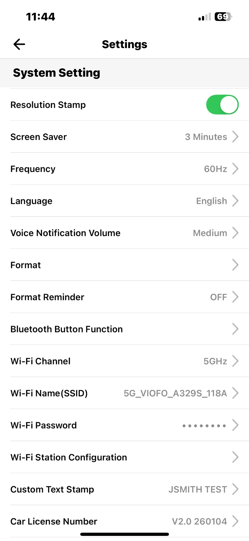

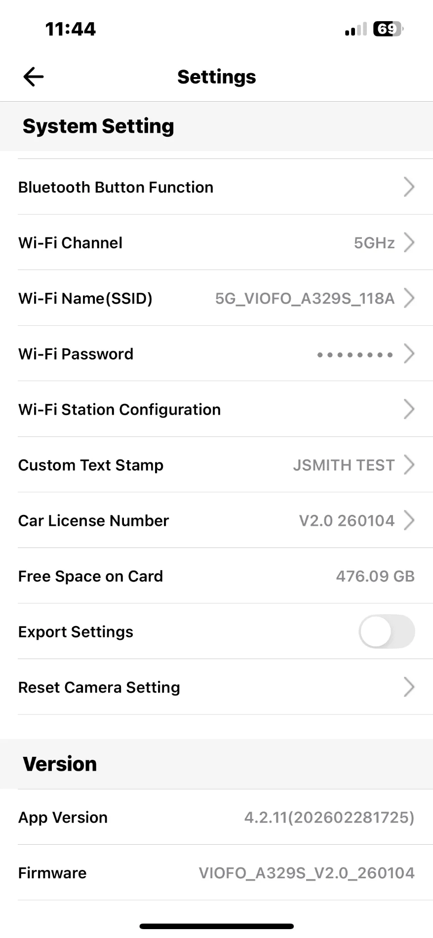

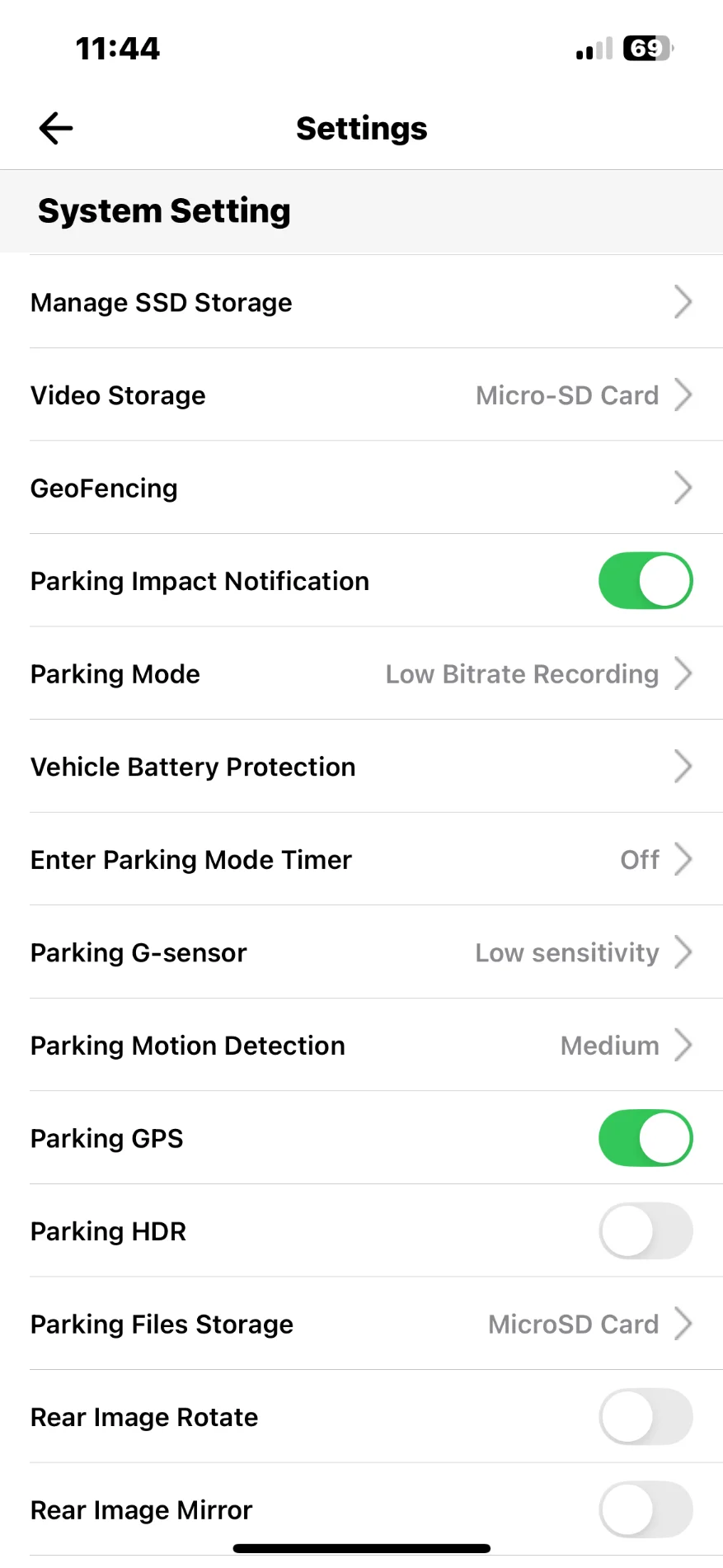

A. I first tested hitting the Menu Button (3 lines) to wake camera up from Parking Mode (low bitrate) with 12V enabled (no engine started), and that caused a "Lock File" Event.
B. The second test eliminated the Menu Button in waking up camera from parking mode using 12V Ignition ONLY, and that DID NOT trigger a Lock File.

Here are 3 videos (1 No Trigger Lock and 2 Trigger Lock) of my vehicle starting with a much clearer video.
