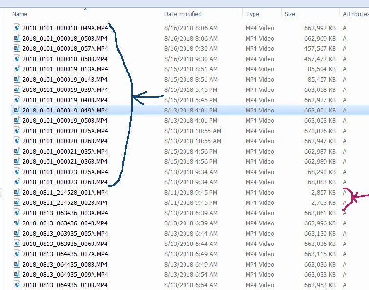

Here's a bit of data for the engineers. I inadvertently created the same situation again. In the attached screenshot you can see a short file on 8/11 where I just started the car to move it a few feet and shut it off right away (red arrow) (also a few other times but they don't show here). Every trip after that point the date/time used for the file ID was reset to default until a GPS lock reset it the to correct value (blue arrow).
I will ask @Street Guardian USA to replace that one so we can get it back for testing in case there's something else going on
It just occurred to me that the new vehicle has idle stop/start which may be a factor here. Also, I'm using a USB power cable versus the supplied 12V adapter. I'll have to play with this a bit to eliminate these outside factors.
