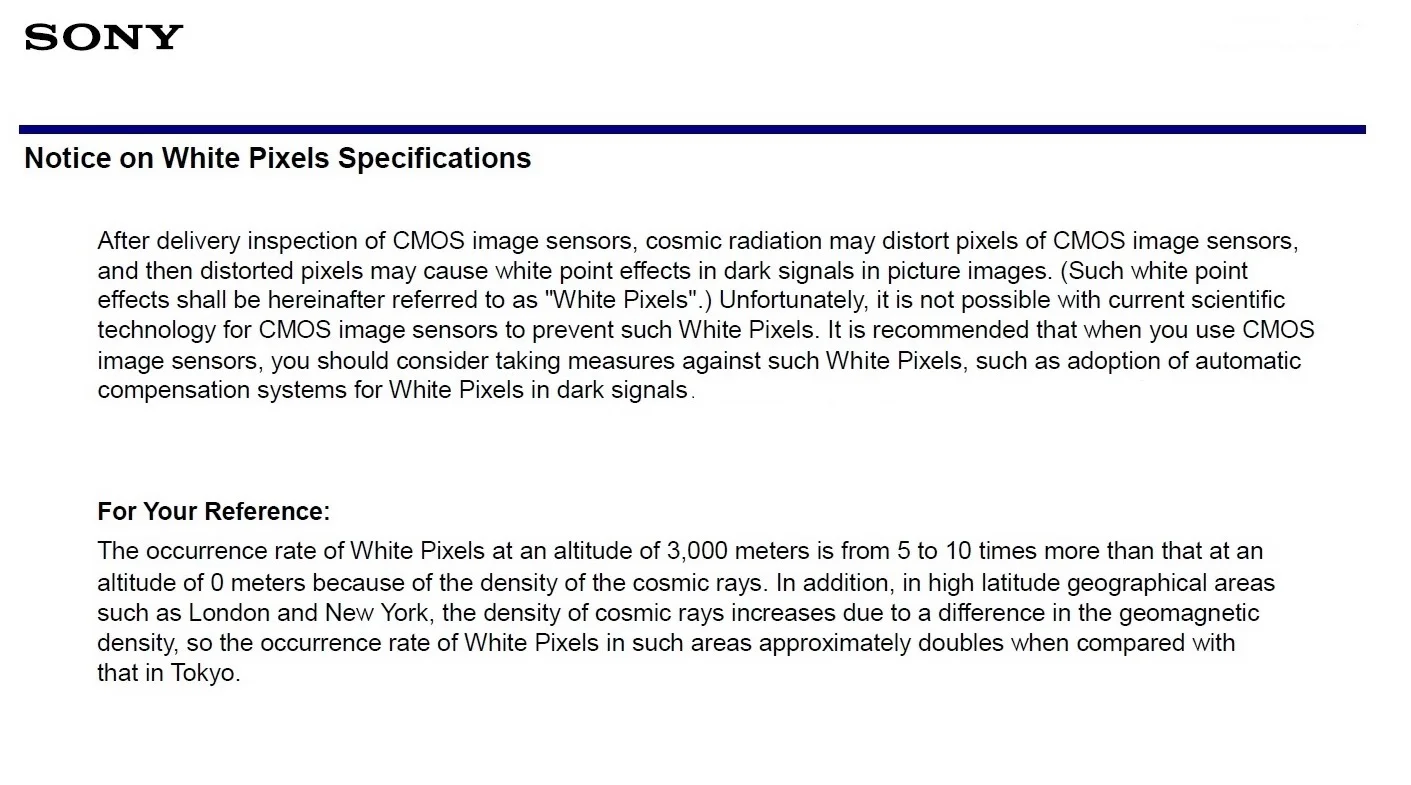

Can I just ask though... what can cause hot pixels?
All sensors have hot pixels, the firmware needs to be fine-tuned to dynamically "hide" them.
more info:
