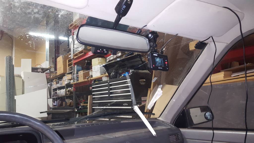

Camera is behind the rearview mirror and gps is in far right corner. Middle camera is gone.
